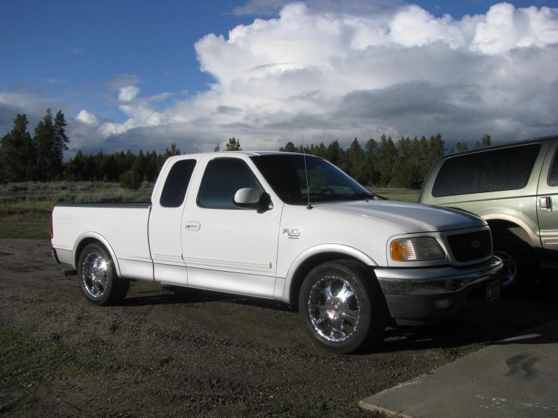

Gabriel air shocks on the rear. Cheap, can adjust ride height for load. This is with 40 pounds, torsions uncranked, front bumps cut, arms clearanced, rear Belltech hanger/shackle kit, sotck F150 springs, block removed. No bottoming with the air shocks, I had them on a c-notched Durango years ago, I used to carry a 550 pounbd snowmobile in teh back, just cranked the pressure when I did it.
Crap, stupid forum doesn't host pics, will post them later.........

Pics.

Old Jun 2, 2013 | 11:11 AM
  #398
coobies5's Avatar
Joined: Jan 2008
Posts: 2,934
From: Houston
Looks great! along with the very nice landscape too!

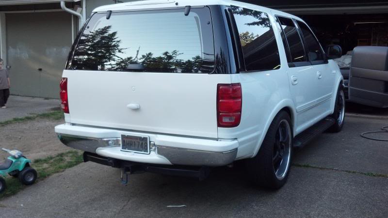

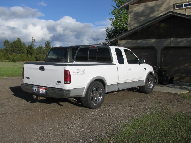

My lowered 4x4. I lowered it about 10yrs ago and never had a problem. It goes inthe snow sand or what ever you want throw at it

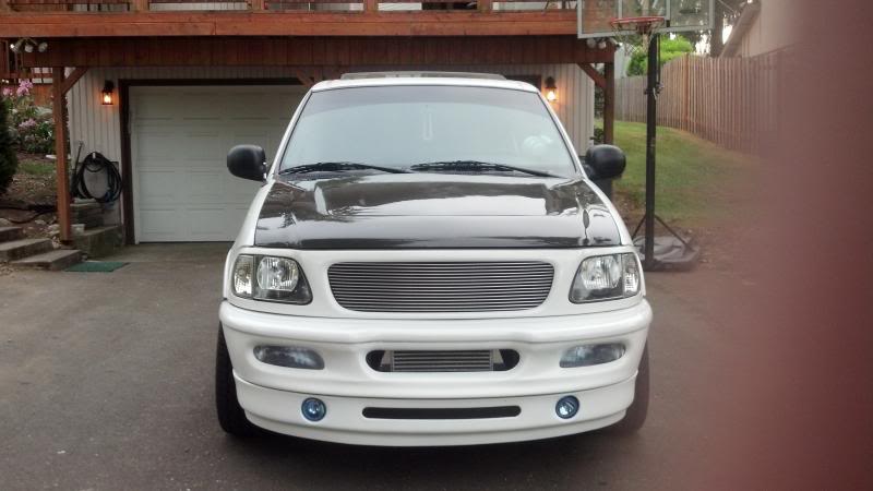

Thanks. I wonder where I got the inspiration for the stance/lowering?
Old Jun 2, 2013 | 04:12 PM
  #401
Devilmanak's Avatar
Joined: May 2013
Posts: 21

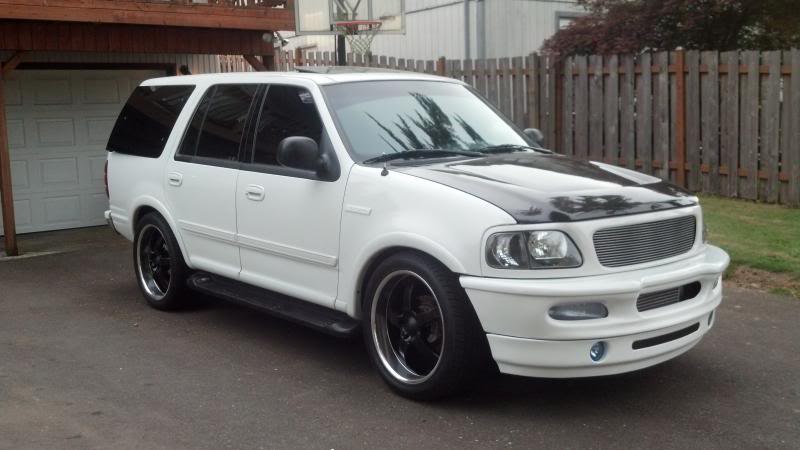

Ok, what bumper is that? With what lower valance? Did you paint the rear steps? I have been looking all over for a front that looks like that!
Old Jun 2, 2013 | 07:19 PM
  #402
justin mccluske's Avatar
Joined: Dec 2007
Posts: 110
The bottom valance is for a F150 and i cant remember the name. The rear steps were panted with plastidip and I will be wrapping the rear bumper this weekend so it will be all white.
Old Jun 3, 2013 | 03:12 PM
  #403
Devilmanak's Avatar
Joined: May 2013
Posts: 21
Is the bumper stock?
Old Jun 3, 2013 | 06:33 PM
  #404
Joined: Dec 2007
Posts: 110
The upper half is.
