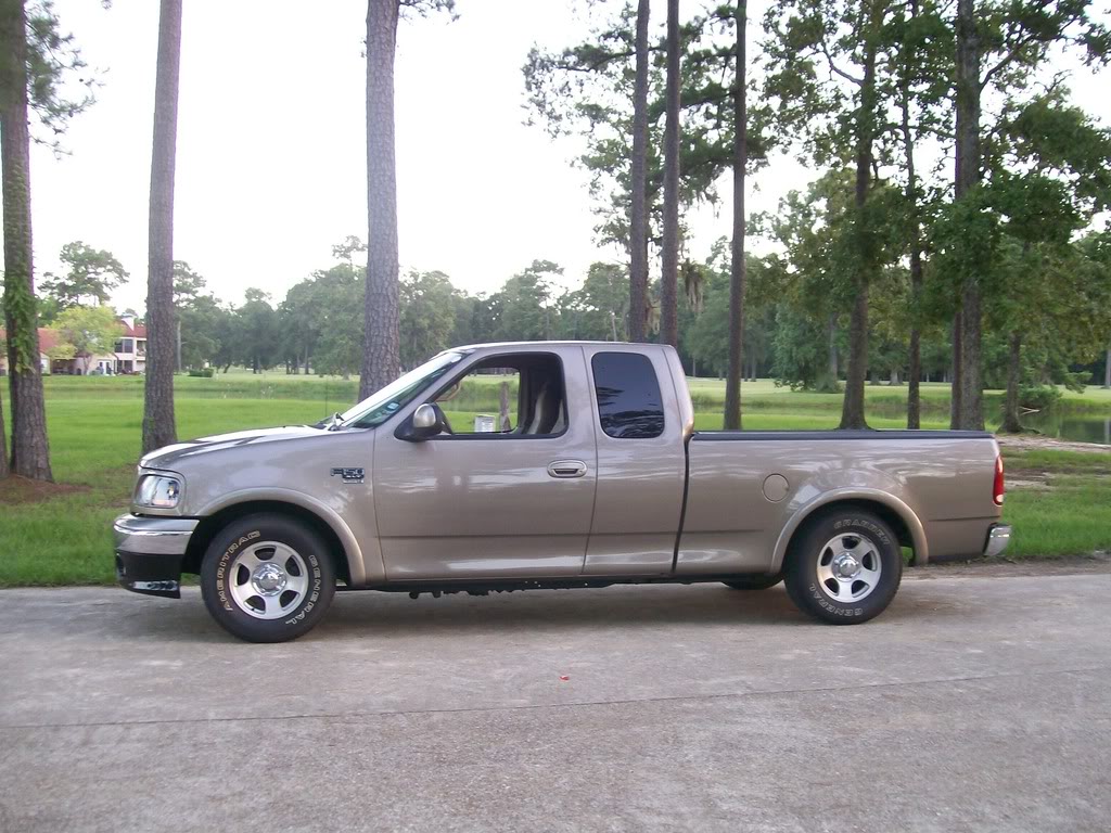

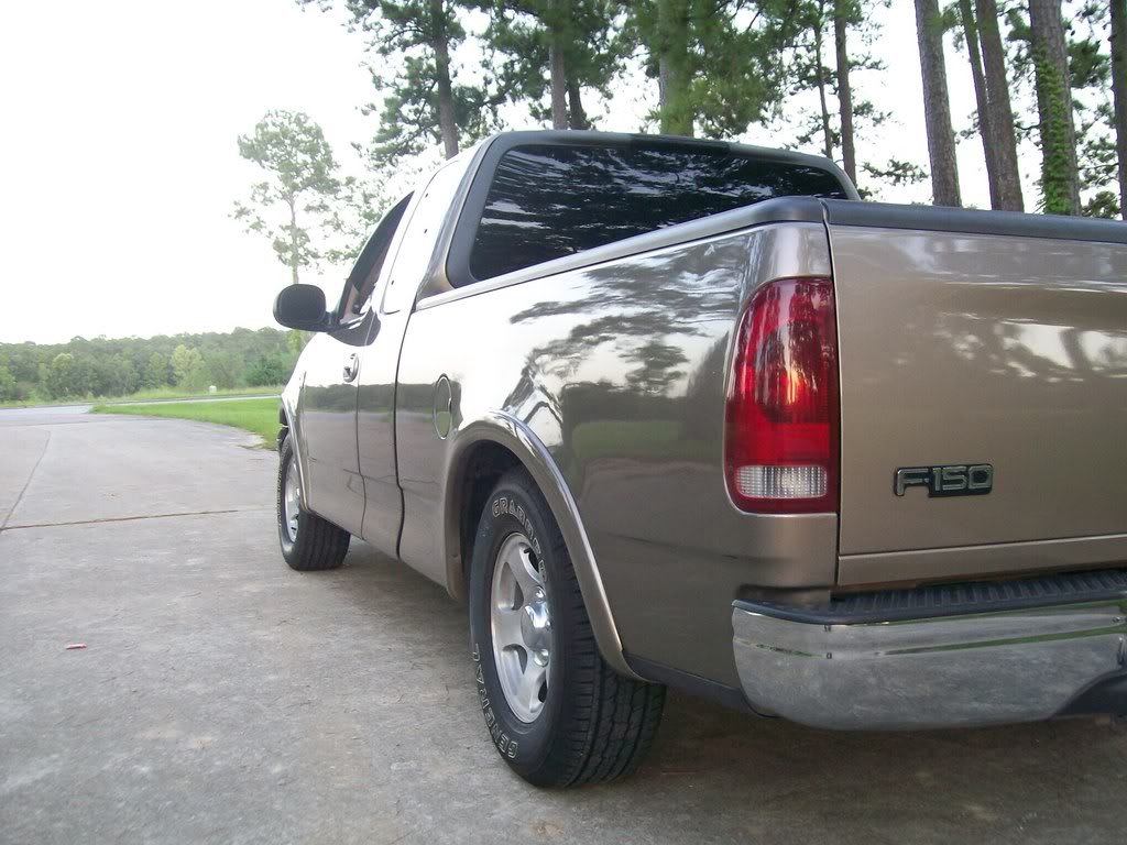

Let's see your lowered 4x4 truck. Info on what all has been done to achieve the drop is good to know for those who may want to lower their 4wd soon.
here's my 01 supercab 4.6 4x4 lowered 4/6 via chevy torsion keys up front and cut bumpstops, in the rear, removed factory block, 2" drop shackles and 2" drop hangers.
Attachment 32914
Attachment 32915

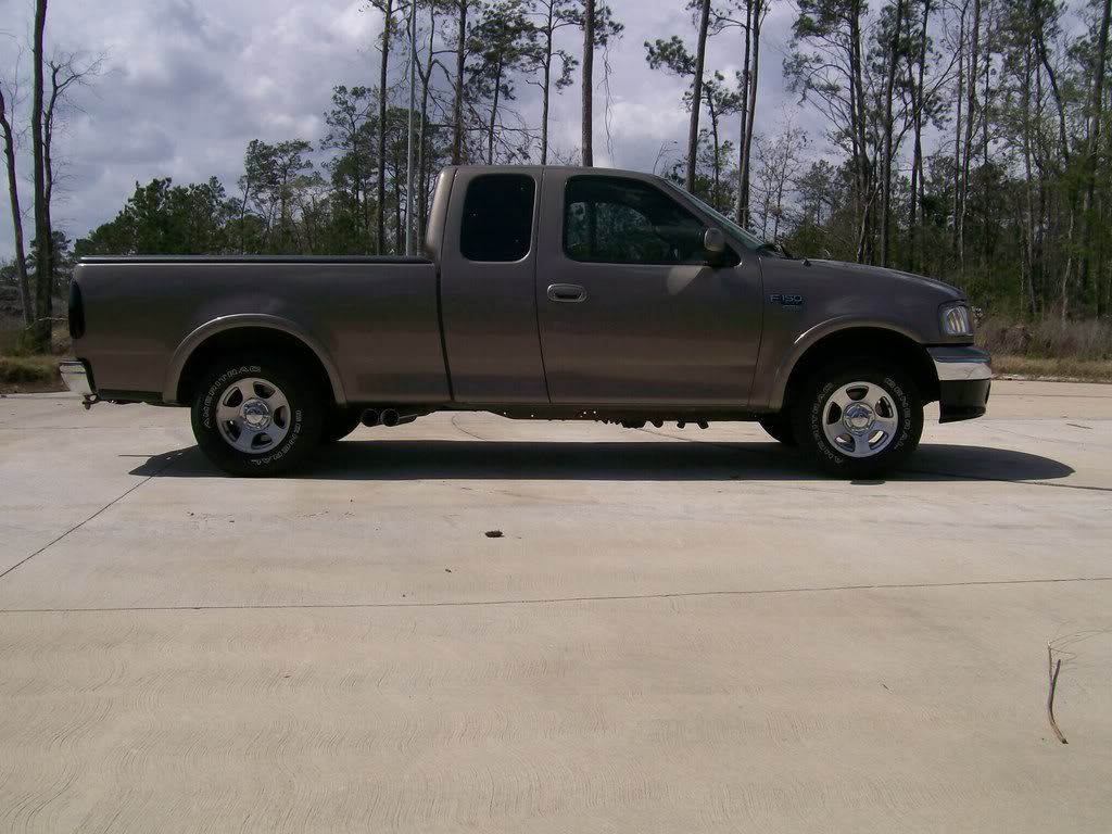

heres just uncranking the stock keys and shackles and removed stock lift blocks
Attachment 32916
Attachment 32917

It will not be identical to a 2wd, but it will drastically improve body roll and tighten up the front end. Front was chevy keys and cut bump stops down. Rear was hangers, shackles, removed lift block and 2wd u-bolts. I did at one point do lightning leaf springs (i forget which year, but it was too low to maintain the rake I wanted) and later on I did rear helper air bags which was perfect for when I would haul.
