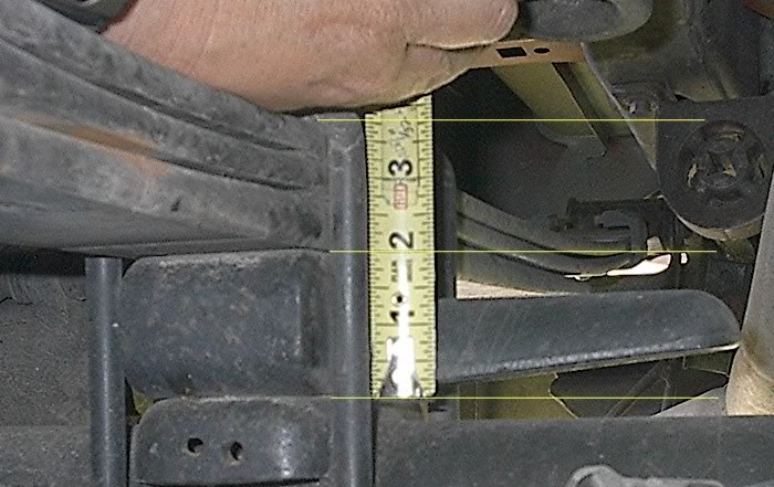

Cwhitt ..... Your's looks great now, but I think you'll love it lowered. Might have to go shorter on tires, down to 32 /33" OAD when you get there ..... but you'll love getting in and out ..... and then there's the "road manners".
Originally Posted by cwhitt
I think I read somewhere that the later models (newer than the 04-08 models) have smaller factory blocks.
I think tbear has some kind of weird model though....
I know there are "differences" over the years. Mine's sticker shows a date 06-07-07, it has the 3.55 gearing and 7,200 GVW rating with oem 20" wheels. Mine has the single top or main leaf with a long second leaf under it and then the shorter & much thicker in center, tapered at ends heavy (overload?) leaf under that for a total of 3 leaves. My OEM spacers were exactly 2" high and had no taper at all, and all I did was remove them? Really! (well, I did use shorter U bolts)
OEM set up before my lowering in 2011:
I do still have the FX4 rear shocks in place but when measured for suspension travel (axle now to bump stop) and compressed length (of oem 4X shocks), if the rear axle bottoms on the bounce stops the shocks will be about as short as they can be and be bottomed ..... so if that's looks possible in my use, I'll have to load lighter or get some 2WD shorter rear shocks if I don't want to risk damage to shock mounts (I really did remove the rear wheel and measure and draw in scale suspension movement from ride to compressed including shock mounting locations).
I too have read that some models have 4 leaves total and shorter spacers, but I forget what years / models / GVW ratings they were. I have read some posts about broken springs .... but those usually are from northern / colder climates or heavily loaded "work" trucks it seems.
If I ever started hauling heavier then I'd add some sort of air bag assist I think ..... adjustable for load. Have Air Lifts on our Mercury GM and when unloaded I have them vented to atmosphere with Schrader valve out. As it is, I have a '77 F150 for "loads" like a ton plus wood pellets, etc ... and a trailer with 3,500 lb axle that'll haul a decent load if needed ..... so the '07 sees things like luggage, Costco shopping, gas can fill ups, .... lighter stuff.
I did once consider using some longer "lowering" shackles at the rear to take another inch or so off the height at rear ..... but after all was said and done, I found that I liked the rake it had and had accomplished my goal .... and so I stopped here. When I ever R&R shocks .... I'll likely use shocks intended for a 2X4 on both ends and then there'll be no cuts and welds at front (anyone considering this, refer to post #251 .... I was extremely cautious / careful to NOT heat up the shock body / fluid as you'll see) or possibility of bottoming the rear shocks.
