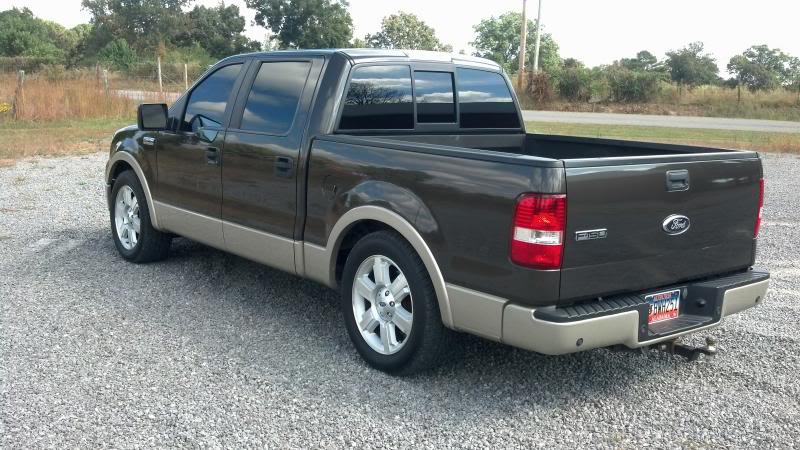

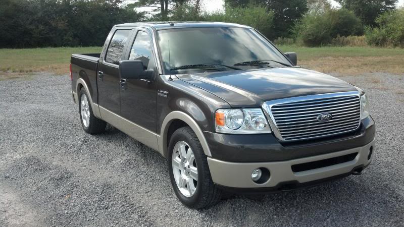

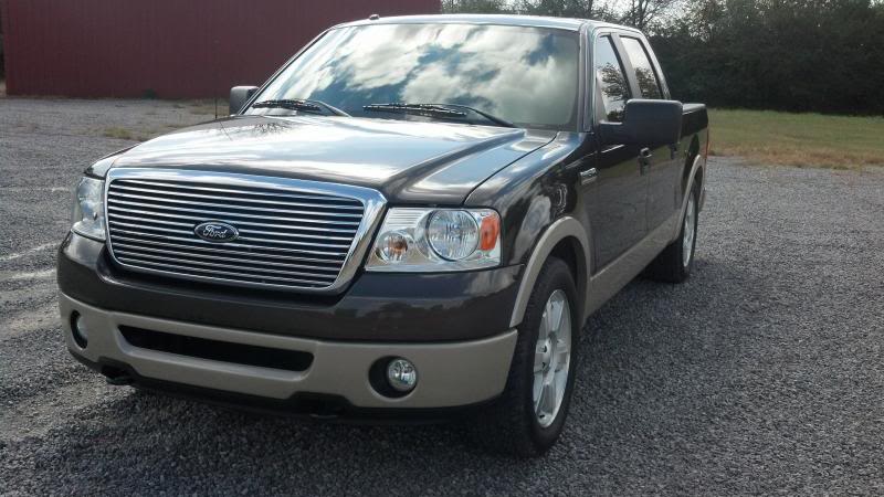

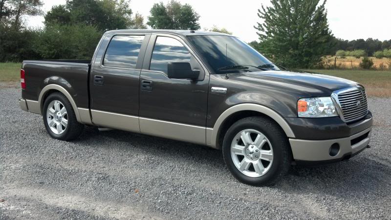

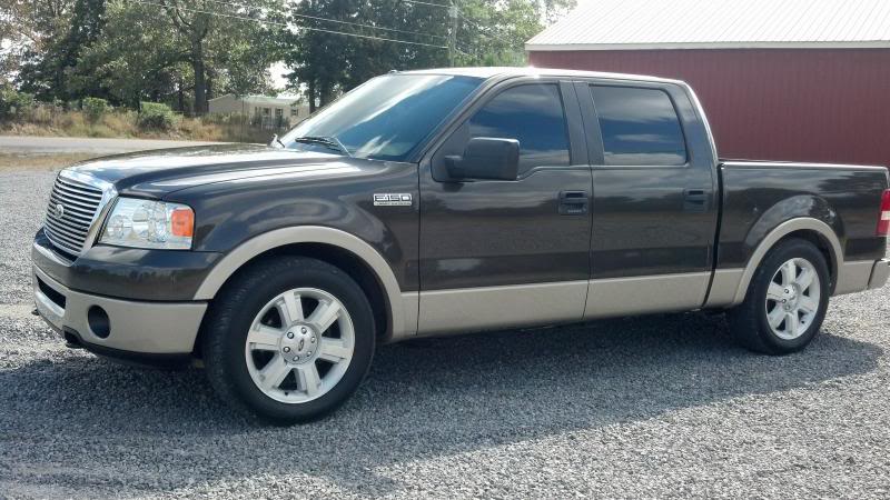

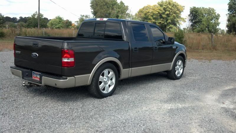

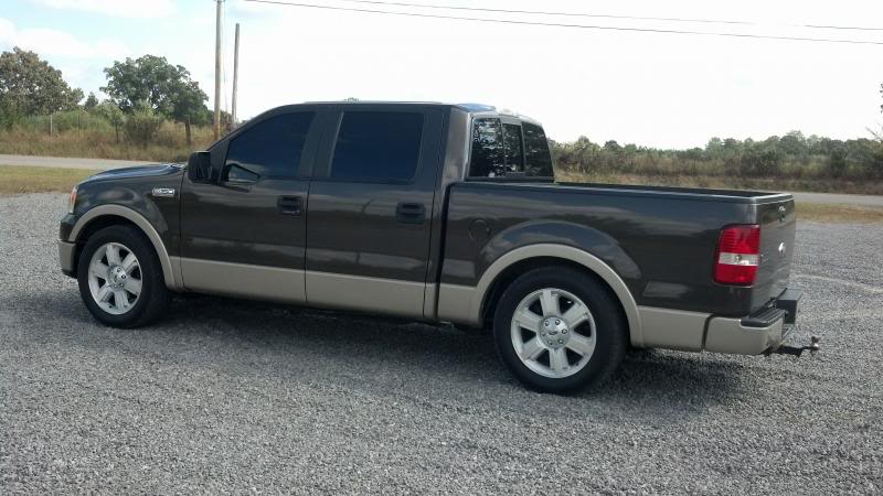

Updated pics - thought I had already put some in here, but apparently not. For now it sits at 2.5/4 and running Slam Air helpers(59210). Once my shop isn't being used as storage I'm going to give 3" a try in the front.
The ground isn't very level in the pics, but it was an easy place to get some quick shots.

looks good. if it were mine it take the back up about 1" and let it ride. do that and don't touch it, unless you wanna buy my wheels

like I've said, I don't think your truck could ever look bad, so simple and clean! I love it

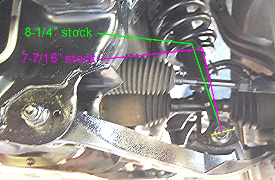

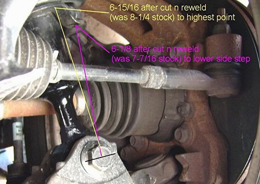

I dropped mine just 2" in front and I was some worried about shaft angles, but it's never been an issue ..... I'ld loose sleep if I had gone more and saw these pics ....
Love the trucks!
Just as food for thought, 1-5/16 at the shock netted a solid 2" drop.

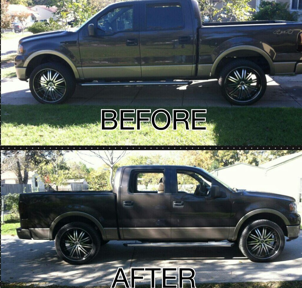

Removed the level lift and added lowering shackles. Now to decided on how low to go and what kit to get.
