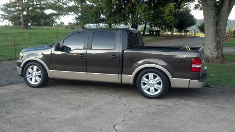

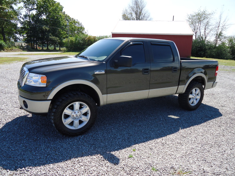

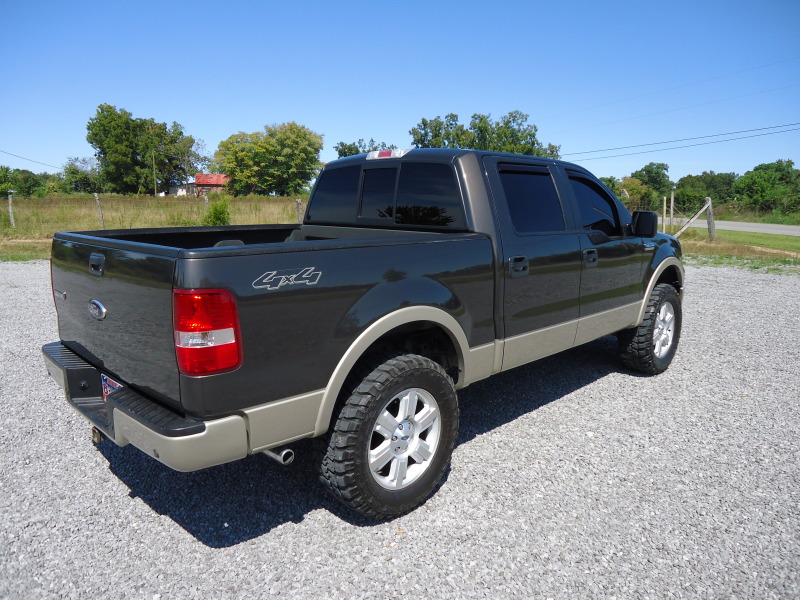

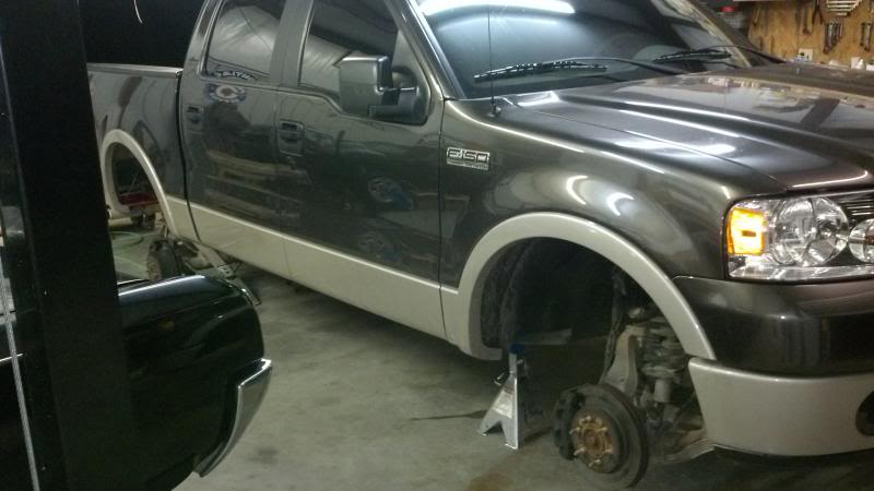

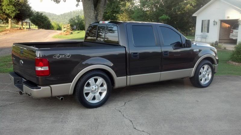

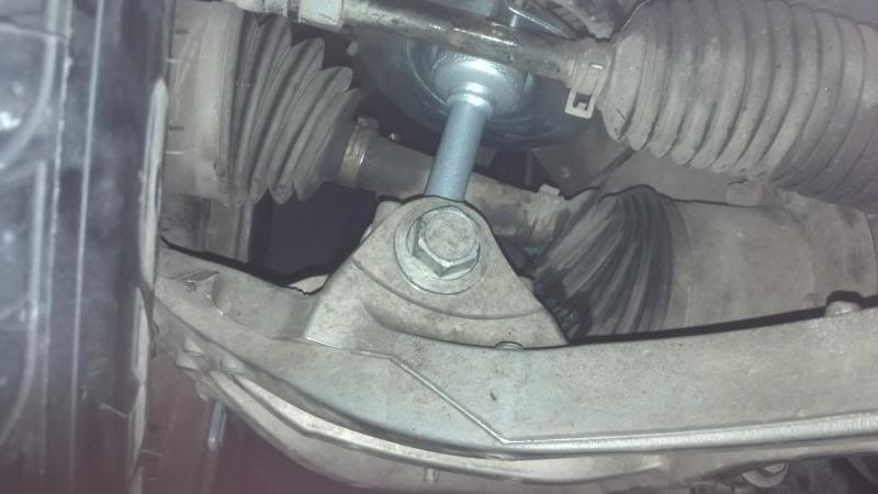

Here's my build from beginning to end basically - still no detailed up pics but I will have some soon. I also posted this i street scene, so I'm just copy and pasting.
Here are some install tips/pic from my 2007 Lariat SCrew 4x4. I looked at trading for a 2wd, but there wasn't anything very nice my my area and I didn't want to trade down. So, I bit the bullet and went for it. There was a little trial and error, but nothing too bad, haha.
Parts list:
Belltech Struts part# 25001
Belltech SP Shocks part# 2212EE
DJM Flip 4"
Here are the before pics - 35x12.50 Federal Couragia, HBS 2.5" level. DJM 1" lift shackles

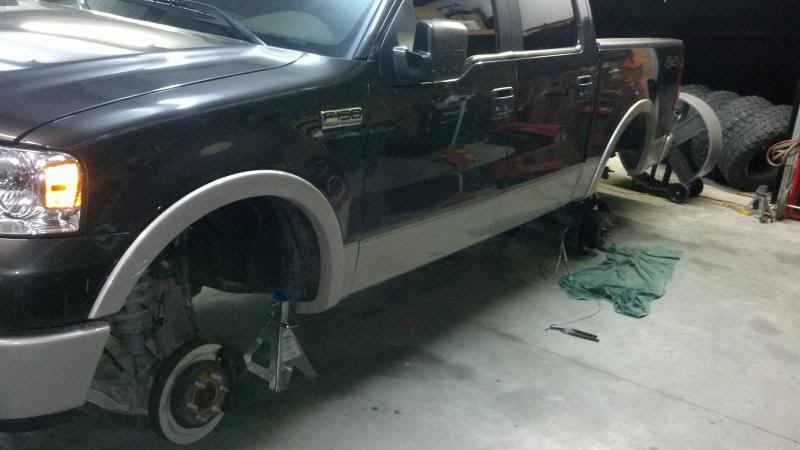

Here's some random install pics.

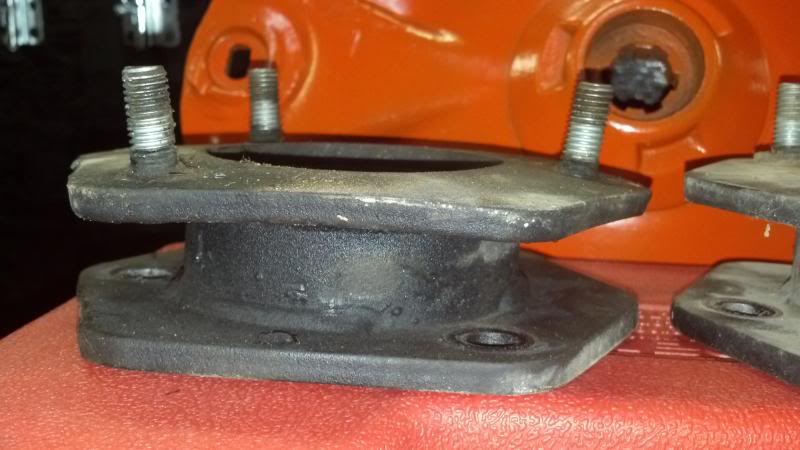

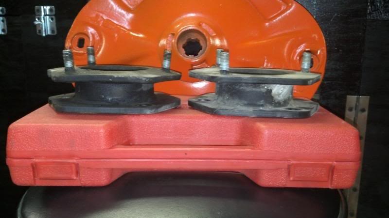

These are the pics of my HBS lift spacers - the passenger side didn't fare too well. The passenger is on the left, and driver on the right.
Here's how she sat at full drop. 2wd struts set for 3" drop which is equal to 4" on a 4x4, and a 5" flip which ended up being 6".

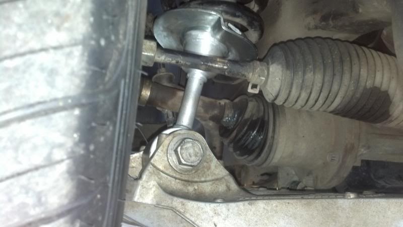

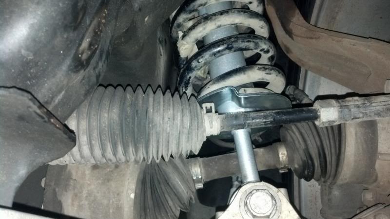

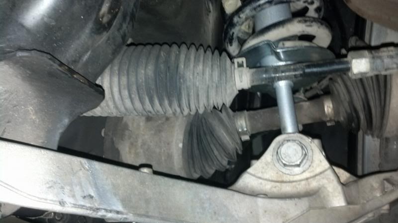

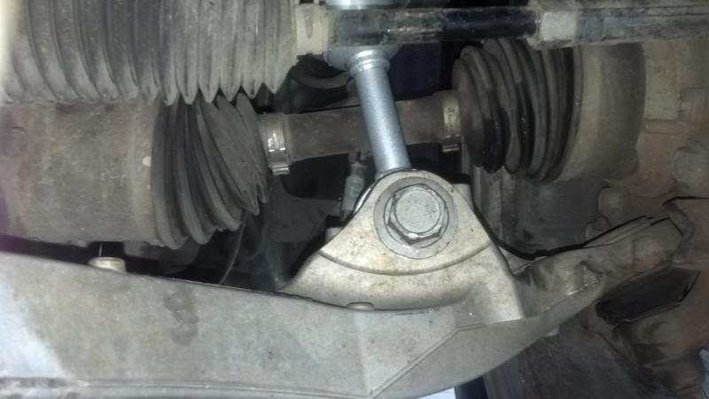

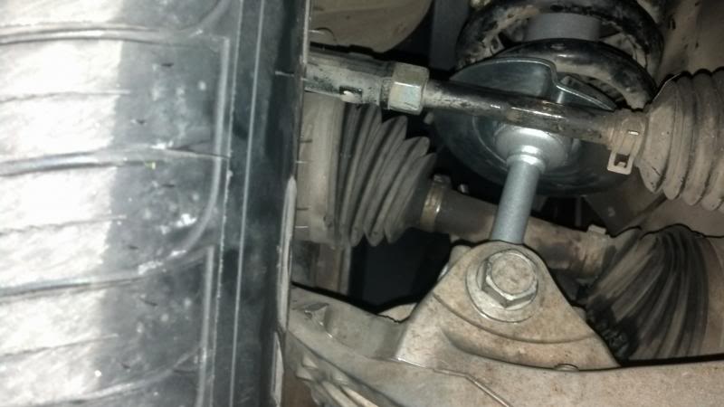

Now here's why i could stay at full drop, the front axles just didn't want to work with me very well. I was afraid once they got a pretty good shock they'd be gone.
Passenger
Driver

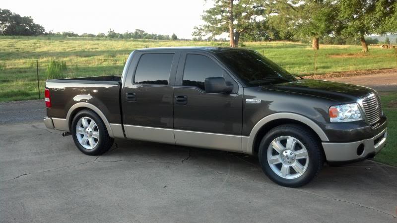

Now, were are at 2.5" total drop in the front, and 5" in the rear in these pics.
The front axles have a better angle on them for sure now.
Passenger
Driver

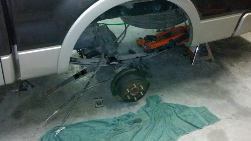

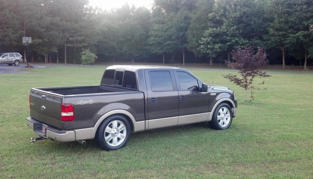

I don't have any current pics of it cleaned up, but it's at 2.5" in the front with struts, and 4" in the rear with a flip and hangers. Here are the most current as I was in a hurry to get finished. I'll update with some clean/finished stance pics soon.

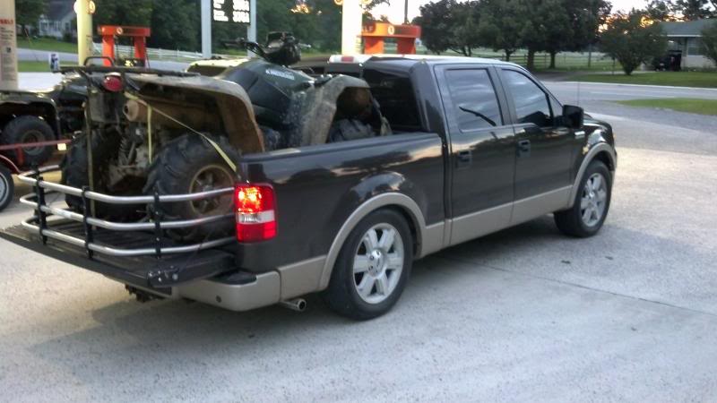

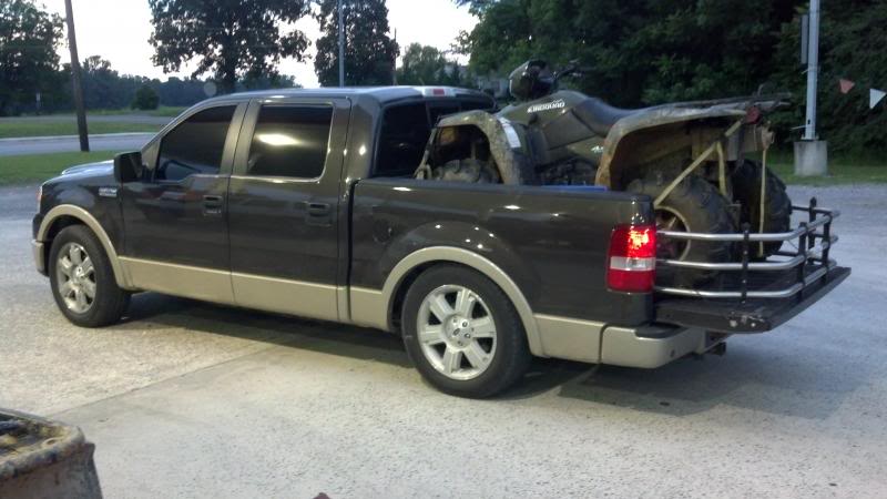

The pic with the atv and coolers in the back was 800# give or take some. Amazingly it only hit the bump stops on a big *** pothole I couldn't miss.

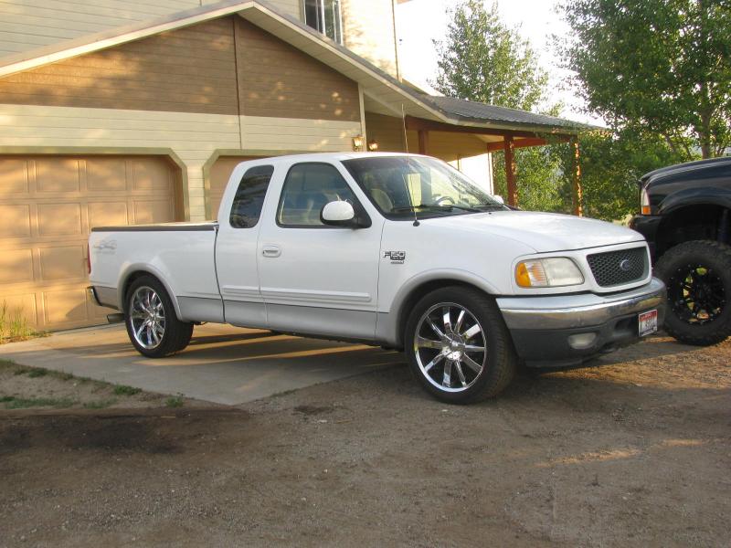

I wanted a lightning bad, but they were too much for a nice one. So I looked for a 2x4 F150 to turn into a Lightning, the two I looked at were way too much money ($4400) and beat, so I grabbed a 4x4 in great shape for $5000 and figured I would just deal with it, plus be able to drive it in the winter if I want. I have it low, but not so bad that it isn't usable. Plus with the big wheels I can lift it back up a little and still look good.
