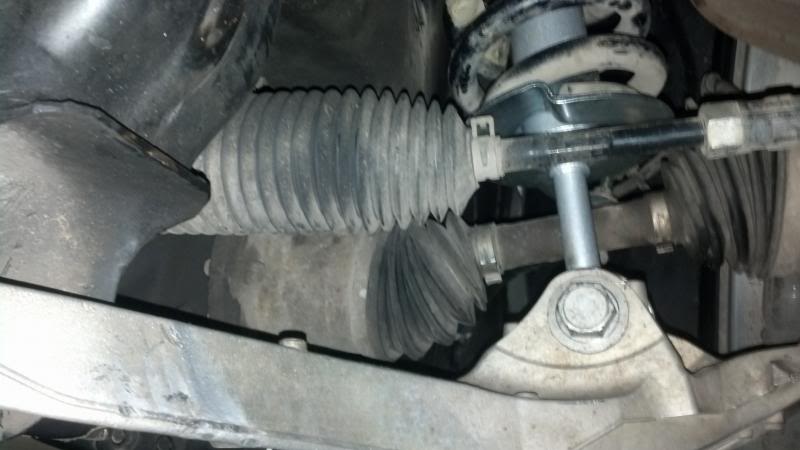

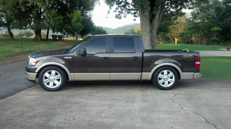

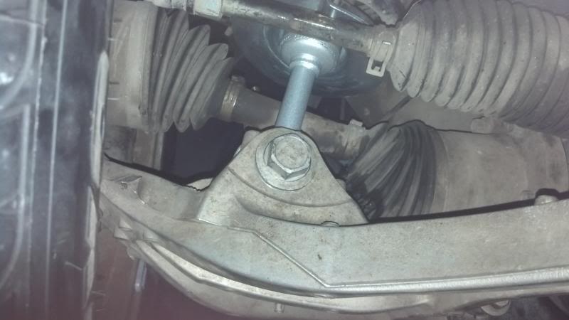

You're better off to do BT drop struts in the front, and a flip in the rear with some good shocks. The front is the only thing that might give you trouble. With a 3" drop in the front you get 4" since the 2wd struts have a 1" difference from 4wd. With mine dropped 4" here's what my axles looked like. I guess you could run with those angles, but I chose not to. Yes on an alignment, and yes on pinion angle. If you run a DJM flip you don't have to use shims for the pinion angle, and can manually adjust the angle. If you want 3" in the front - just get the 2wd struts and set them up for 2" lowering and that'll get you to 3".
I used BT struts for a 2wd part# 25001, BT Street Perf shocks part# 2212EE on the rear, DJM 4" flip.
The pics show the 2wd struts at 3" drop and a DJM 5" flip. It's been raised some, but I don't have current pics yet.
Driver

Passenger
Side View 4/6
