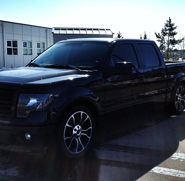

Took the old 2011 FX4 for a bath today, oh how I loath how spring-time...

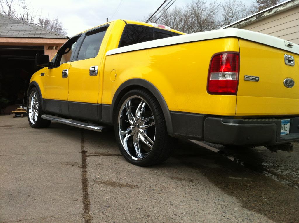

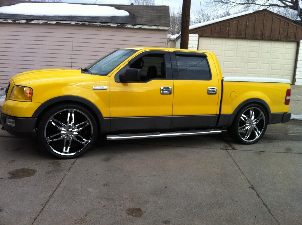

lowered fx4
3/5 djm drop
Calmax Control Arms up front
rear axle flip kit and “shorty shackles
upgraded the rear shocks to Calmax SuperShox
what yall think?

Originally Posted by F150SYCKNESS
3/5 djm drop
what yall think?
Good Looking truck! What the size are the wheels and tires?
Old Apr 2, 2013 | 03:08 PM
  #384
fine_style150's Avatar
Posts: 2,578
From: Southwest Ranches, FL
Looks like 26"s. More pics of that hood man, truck looks good.
