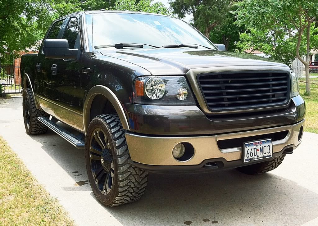

Iam really considering lowering my 06 4wd. I hoping to achieved a 3/5 drop. Is it possible? Can I buy a kit or do I have to rig it some how.
Here's how the truck sits right now.

Low pros on monsters? Dropped stone truck? Can't wait to see this!!

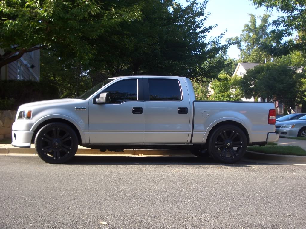

No sure if iam put low pro tires on the monsters. I think iam use my Oem 20's till I find a deal on some 24's.
Even though they do look sick on a lowered truck.

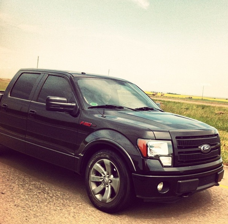

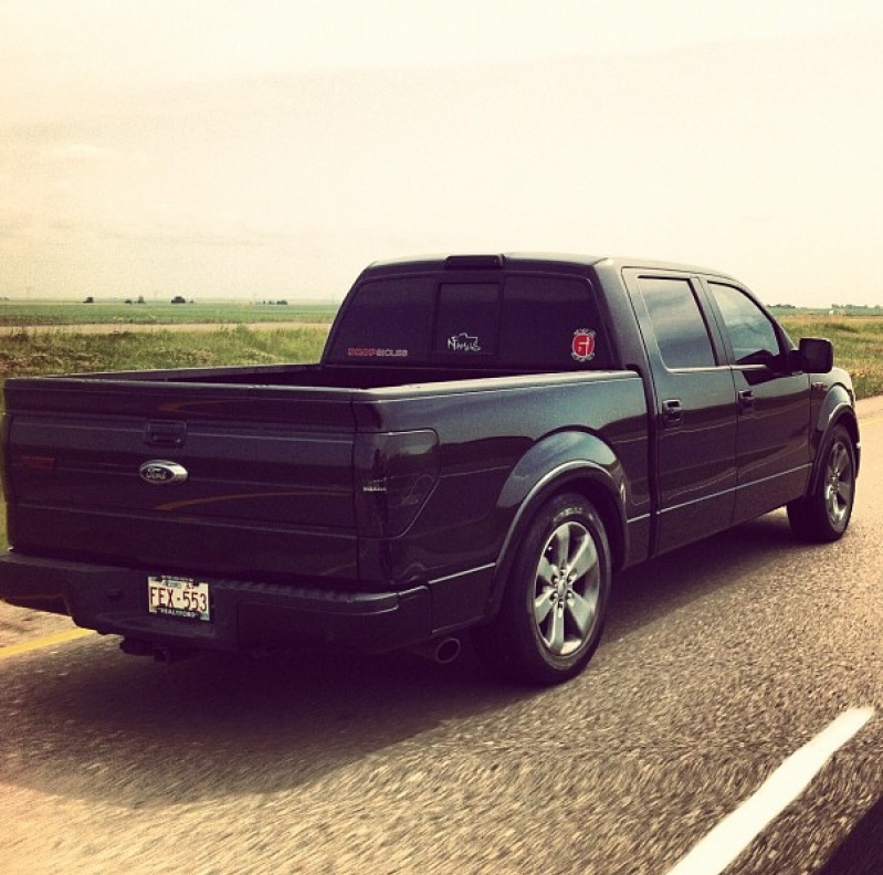

Couple pictures of me driving my '11 FX4 down to our club's show this past weekend. I didn't bring either of my Rangers, so it would nice to just go and relax.
Enjoy...
