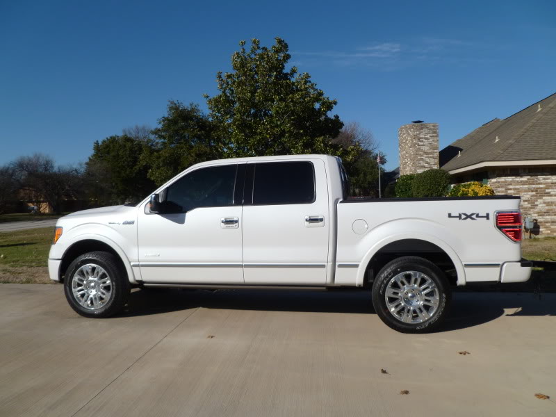

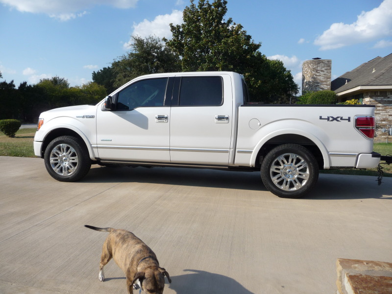

I started a thread in Street Scene, but thought I would post here too, Patman just finished doing a minor drop on our '12 Screw 4x4. Looks better.
before:
after:
