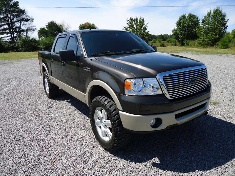

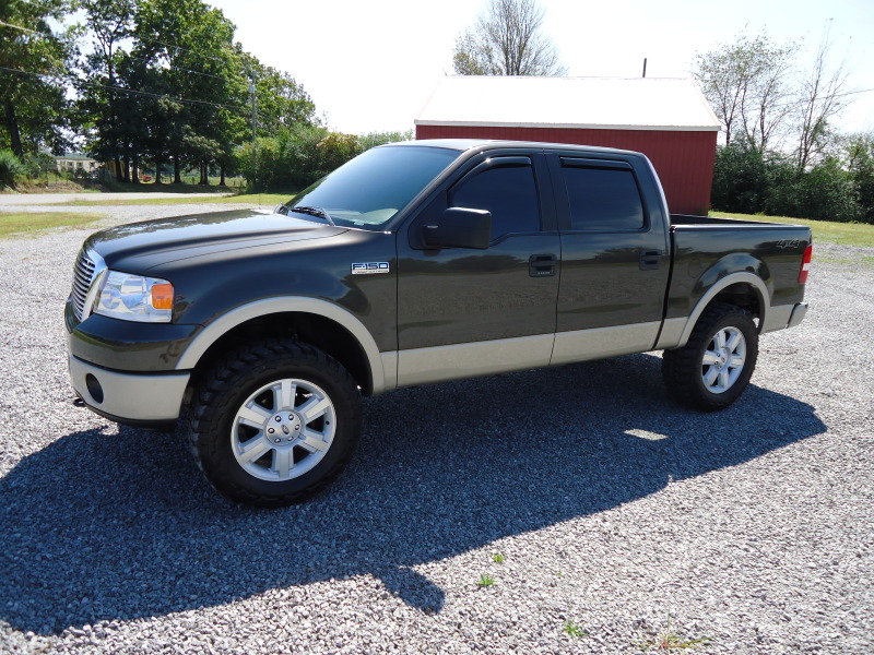

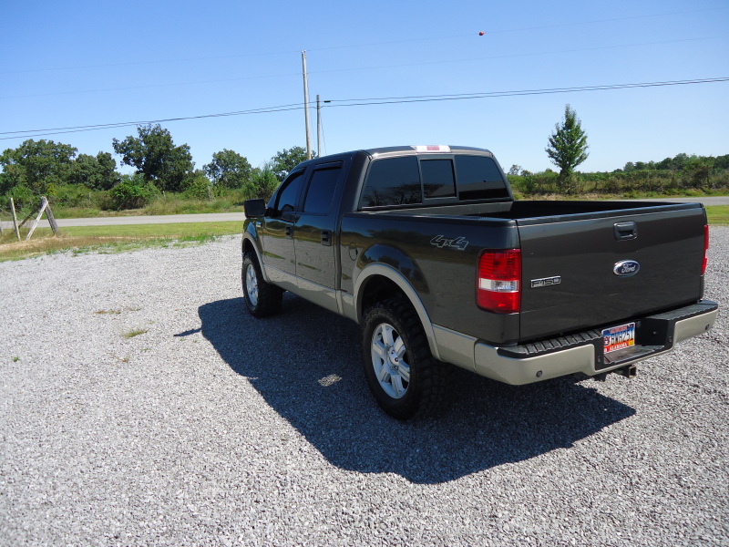

Here's the truck I'm starting with - 2007 Lariat SCrew 4x4, 35x12.50-20 Federal Couragia, HBS 2.5, and DJM lift shackles.
What does the clearance from crossmember to ground look like with a 3/5 kit? I'm looking for 3/5 or possibly 4/6 depending on clearance, and I will be running helper bags in the rear. Is anyone running a 305/40R22 or 285/45R22 with a 3/5 or lower? More than likely I will be running Harley reps in 22x9 +34 offset - if not Harley reps the offset will still be in the mid to high 30's and the lowest would probably be a +32.
I pm'd Blown Ford on f150forums as he's running 305/40 on OEM Harley's with a Belltech 3/5 I believe - he says there's room. He's the only one I've seen with that combo so far, but it worries me it would rub with 4" in the front. 285/45 is only an option since I can get some basically new take offs cheap locally.
So, here's what my list consists of so far.
DJM 3/5 - which with research is a 3.5 drop front
Belltech Lower/Lift Strut #25001
Belltech SP Shocks #2211EE
McGaughys Helper bags #70013
22x9 - offset in the mid 30s
Input/opinions are welcome as I want this done right the first time. I'm not against notching it at all, but if I can get by without I would go that route.
