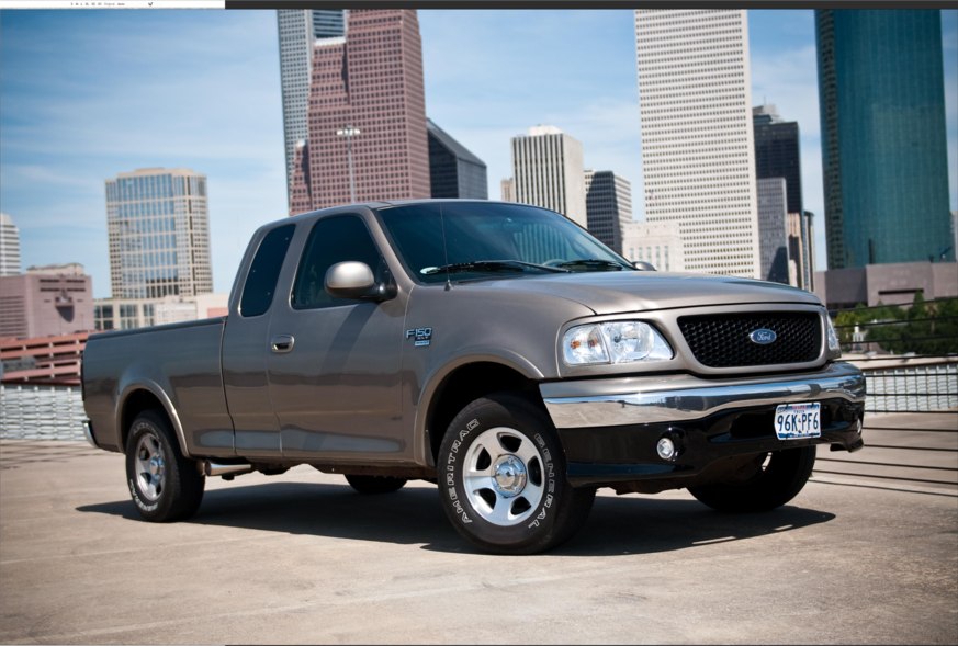

Let's see your lowered 4x4 truck. Info on what all has been done to achieve the drop is good to know for those who may want to lower their 4wd soon.

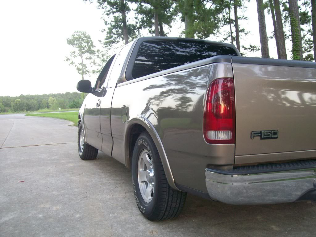

here's my 01 supercab 4.6 4x4 lowered 4/6 via chevy torsion keys up front and cut bumpstops, in the rear, removed factory block, 2" drop shackles and 2" drop hangers.

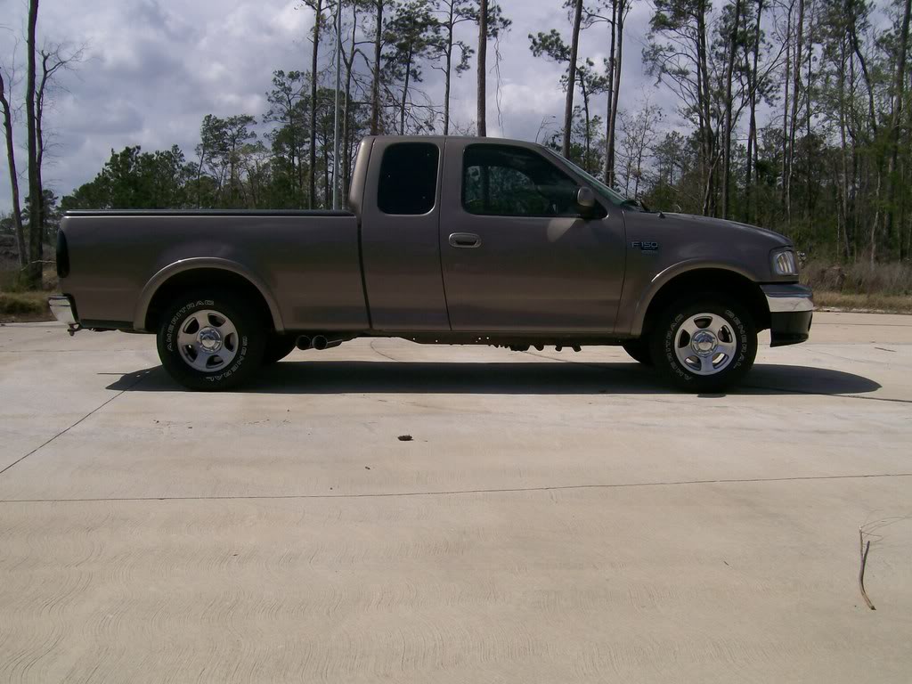

heres just uncranking the stock keys and shackles and removed stock lift blocks
