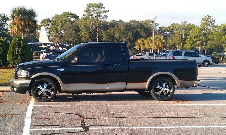

here is the truck i want to get the back lvl with the front

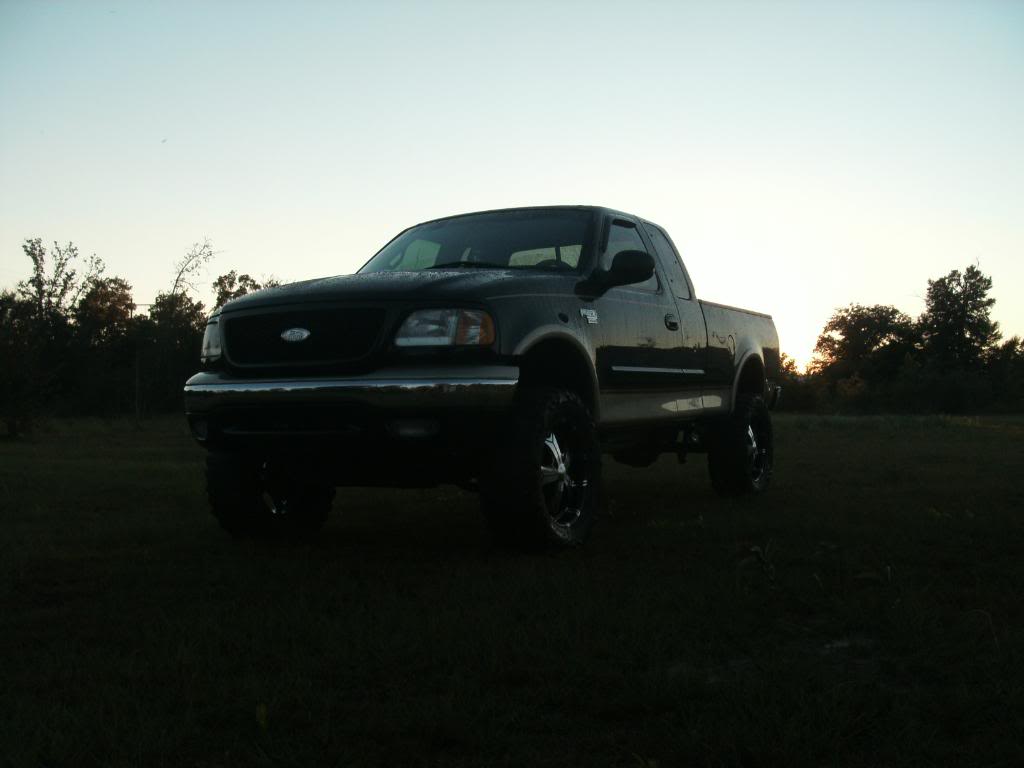

this is it on the 35's
