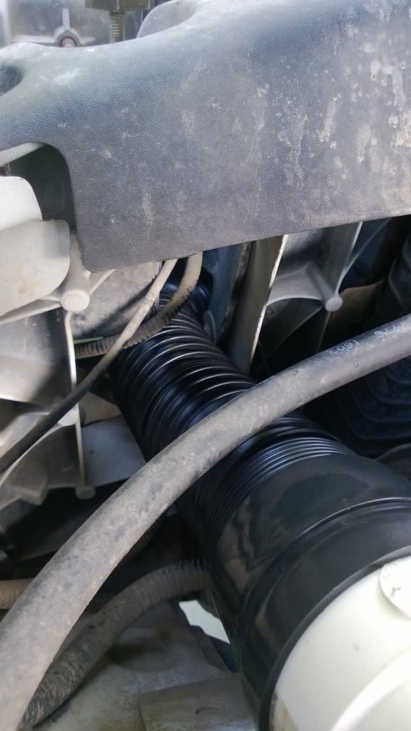

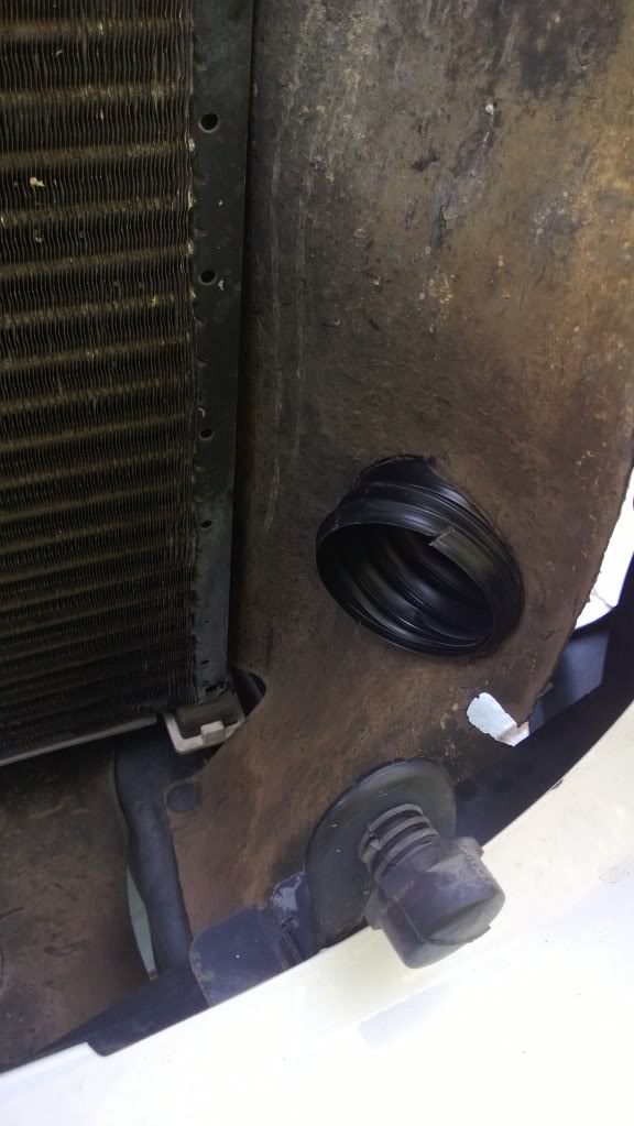

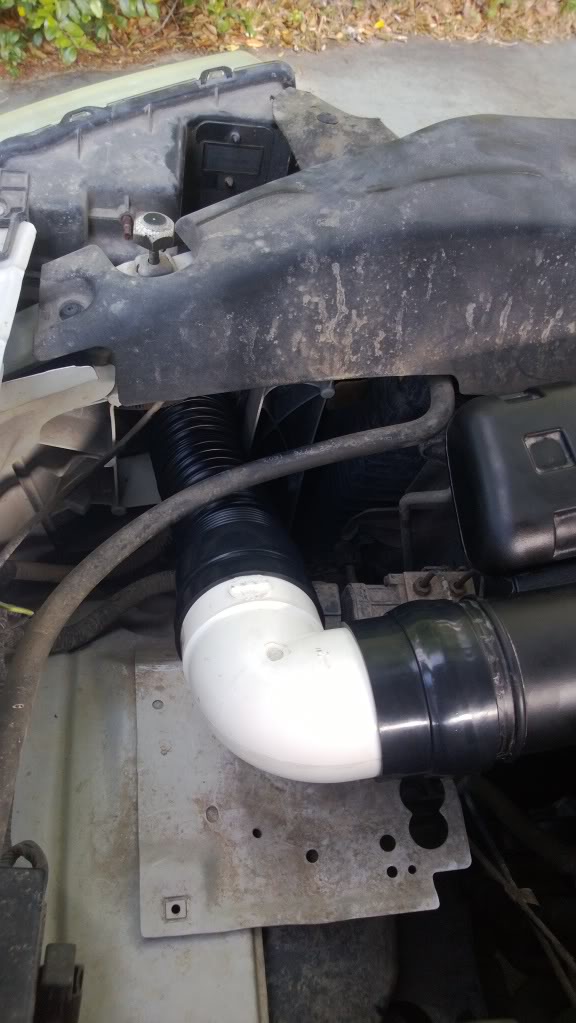

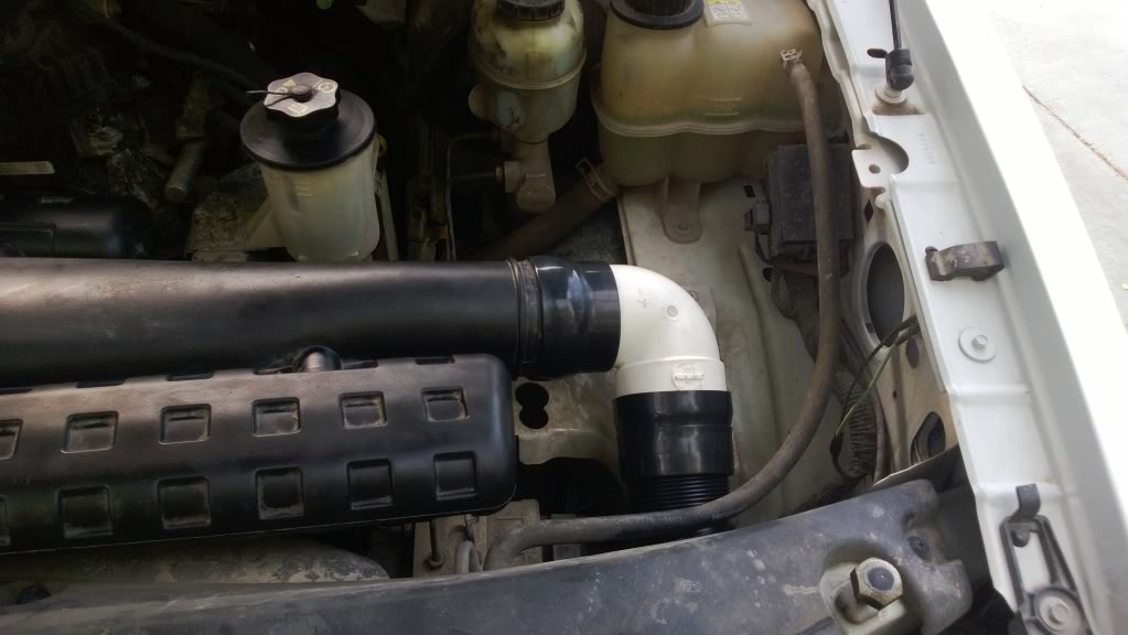

Thanks to all the great posts in here! Lot's of great ideas to get rid of the restriction in the stock intake!
I read this entire thread and decided to do this to my truck too. I decided to go with the version 2.0 since it seemed a little easier and required fewer materials. As I was looking at the intake in my truck I noticed a large void behind and below my drivers side headlight. I had an idea to run the intake down there to get cooler air right off the front of the truck. I stopped by Advance Auto Parts and picked up the Spectre 3" air duct hose, then headed to Lowes. As I was looking for the downspout connector I found a 3" PVC elbow that would work perfect. It's a 3" elbow street adapter, it's got a female side and a male side (Lowes item number 182576). All said and done this is what I came up with. I ended up not using the 4"x3" downspout connector and only the two fittings that were included with the Spectre air duct.
I removed the stock flex coupler and used a connector from the air duct kit and stretched it over the stock intake. Then inserted the male end of the elbow into the connector. Then I stretched the second connector over the female end and it was hard as hell, but there is no way it's going anywhere! I ran the air duct under the headlight and over next to the radiator.
I cut a 3" hole in the rubber shroud and put the duct through it. The duct runs up to the elbow and into the intake.
I feel a difference in the throttle pick up, it spools up quicker than it did before. I drove around this morning and my Gryphon was showing air intake temps at 102-104 while at speed and the outside temp was about 79*. After this mod I drove around and the outside air temp was still 79* and I was reading 86-88* air intake temps. A 18* difference ain't too bad. I'll watch my MPG and may change it back to stock to check the MAF with my programmer to see if there is actually more air flow.

Your setup does look interesting, HOWEVER, I have some engineering thoughts regarding your setup...
Air molecules behave somewhat akin to an automobile, on a nice long straight surface you can really haul, however throw90 r, and the tighter the turn right?
So your use of the 90 degree bend, and the ribbed flex tubing just SCREAM air restriction to me...
A longer, smoother tube / radius would allow the air to flow faster.
Since you are trying to avoid taking the tube to the fender to pull the air, have you considered maybe some 3" black hose in one long arc...
