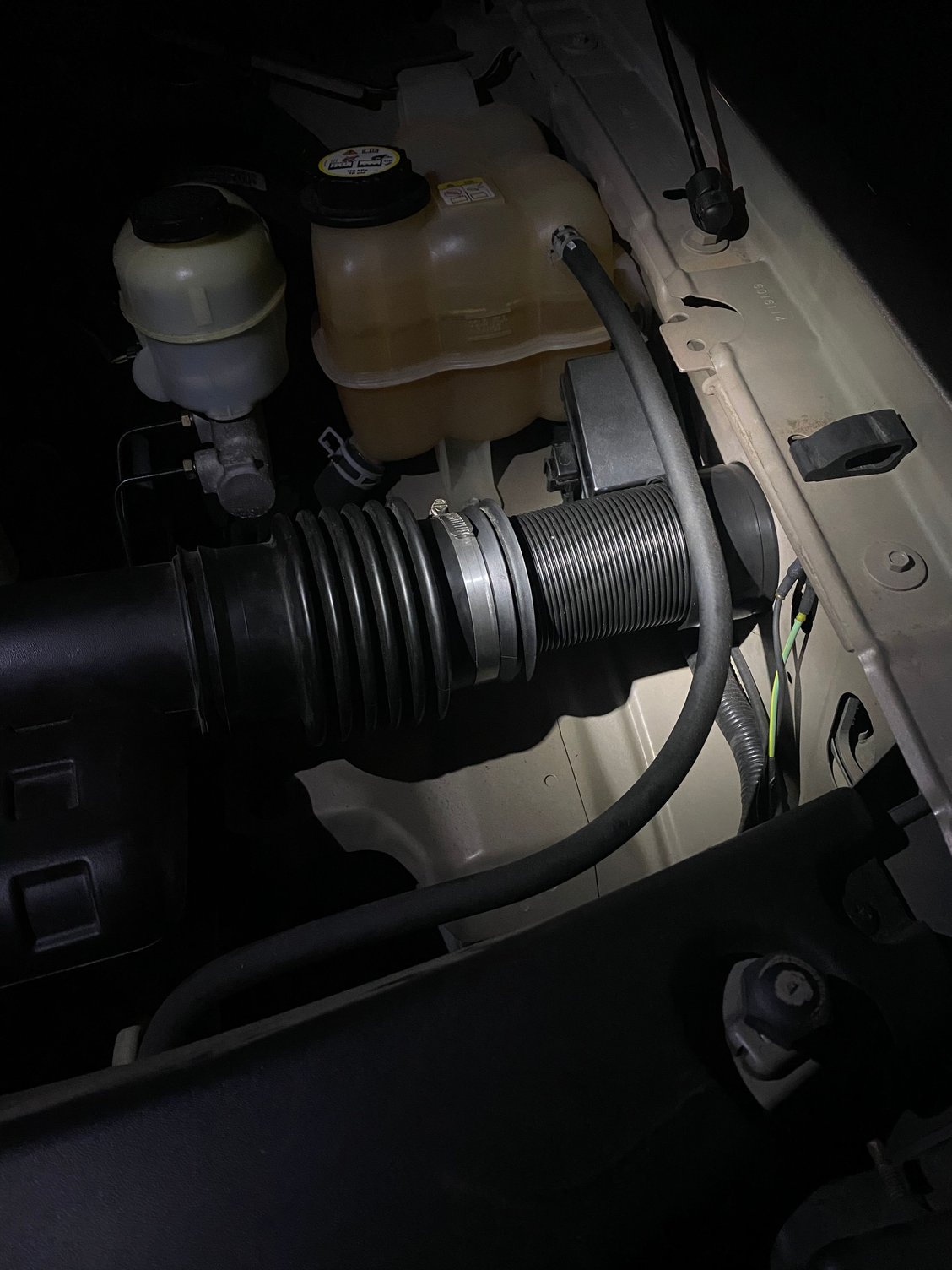

I have a 2004 f150 and I decided to try this mod out. I just want to make sure I did this correctly so here’s a picture.
all I used was the spectre 8741 hose and a worm clamp/hose clamp. I put the second fitting on the other end. I put it on all the way so that it was almost flush with the hose and put that end in the fender. I then put the other end inside that spring poking thing. I noticed that I fit quite snuggly and decided I could put a clamp on it and see if that works. It seems to work but I’m keeping the old fender intake part thing with me just in case. Want to know if there’s anything I should be worried about and if that was the correct way of doing this. Thanks

Looks good to me, Tomas. Much cheaper and a better solution than those WASHOOBIs!
- Jack
