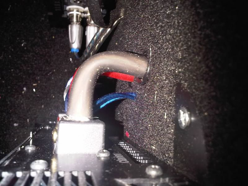

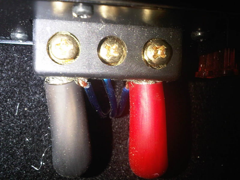

I will be using the front channels on the Clarion XH5410 to power just the Focal TNB tweeters, with no passive crossover.
Will also be replacing the main power cable and ground with 1/0. Knukoncepts was out of gray 1/0 OFC and their
eta was 3 weeks. Against my better judgement I bought a few feet of CCA until I can order the real stuff.
I am still kicking myself for not going with 1/0 in the first place. I kept telling myself that what I first got
was what I was going to stay with. I knew I was kidding myself.
With the 1/0 I am having to also replace the inline fuse and fused and non fused distro blocks.
Got all the wire management and snap bushing to have a completely hidden install as my previous amp rack.
I am planning on having all three amps stacked horizontal on the passenger side.
The LC6i will be under the seat belt mechanism.
All power and ground distribution will be on the drivers side of the amp rack.
I think it will turn out nice.
