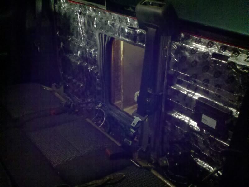

I Covered both of them... 3 layers of audiowrap
nice blow through. Details please
