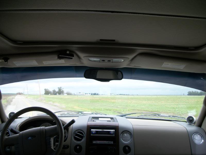

No they are in phase. But I do have my tweeters mounted much deeper on the dash then the sails. The farther forward the speakers are, the deeper the stage presence. They are also pointed toward the opposite listener to get them more on-axis. In the sails, the driver's side tweeter is about 60 degrees off axis from the driver, thats very far off and hurts response.
At one point during testing, I taped my mids up down deep in the kick panels and tuned it...wow. Stage depth was ridiculous with all the speakers that far forward. But I hunt, fish and work out of my truck and speakers in the kick panels would get trashed, so back in the doors the mids went.
I have since painted the pods, but here they were during my testing trials:

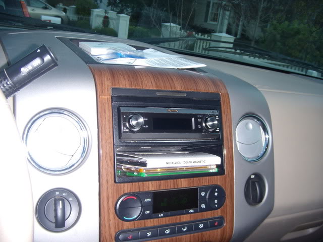

mSall,
How about a pic of your headunit and center bezel. I want to see how a single din looks compared to a ddin.
Thinking about a Pioneer P99 if I can find one.

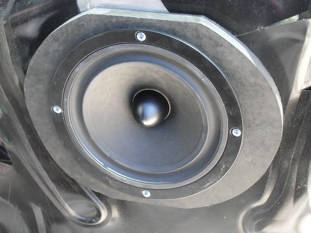

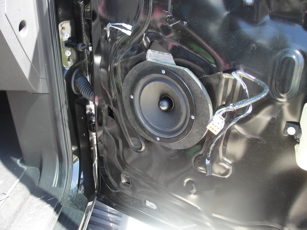

Had a little mishap a week and a half ago. I was messing around and ended up damaging the passenger side Massive Ck6 mid. When playing it was making a really bad buzzing sound. I am in the process of getting a factory replacement but I couldn't wait and had the opportunity to get something I have been wanting to try.
Bought a set of Hybrid Audio Legatia L6 mids. Just installed them and I like them a lot. The Massives are really good and play deep. However the HAT L6 have a better extension above 3khz.
Made new baffles out of 5/8 MDF and painted them with rattle can flat black to keep any water out. Will be sealing the doors in the near future now that it isn't 105 degrees during the day.
After listening to a car, a few days ago, with a HAT front stage I am serious thinking about replacing the Focal TNB tweeters with HAT L1 R2 Pros.
I have a feeler in the TK5 to make some plastic tweeter baffles that will get the Focals point up towards the rear view mirror instead of down towards the head unit. We will see how that changes how they sound and I might not want to replacement them quite so soon.
