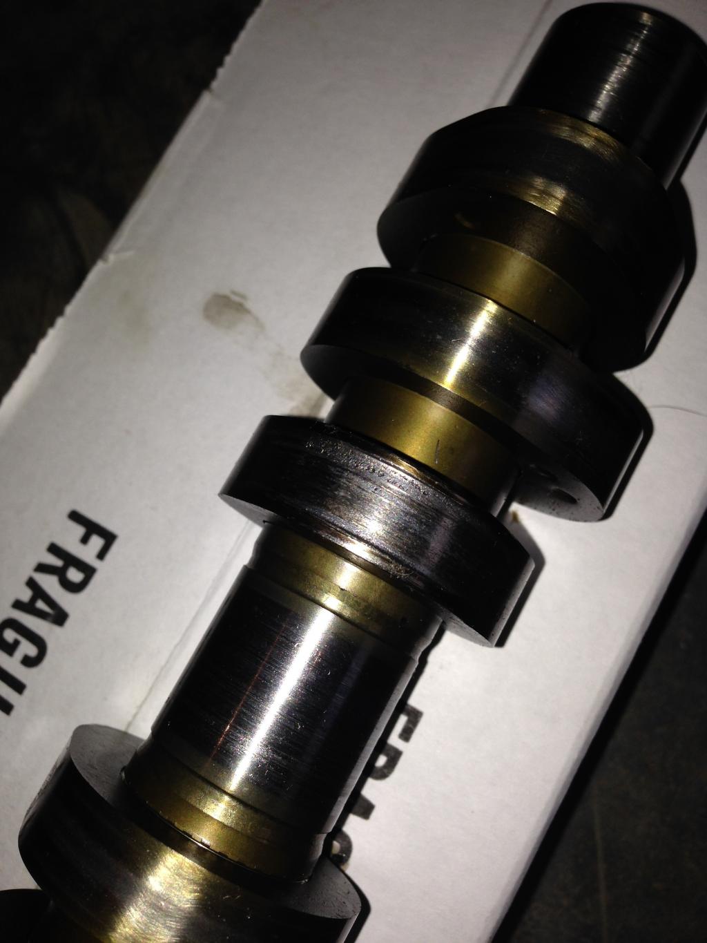

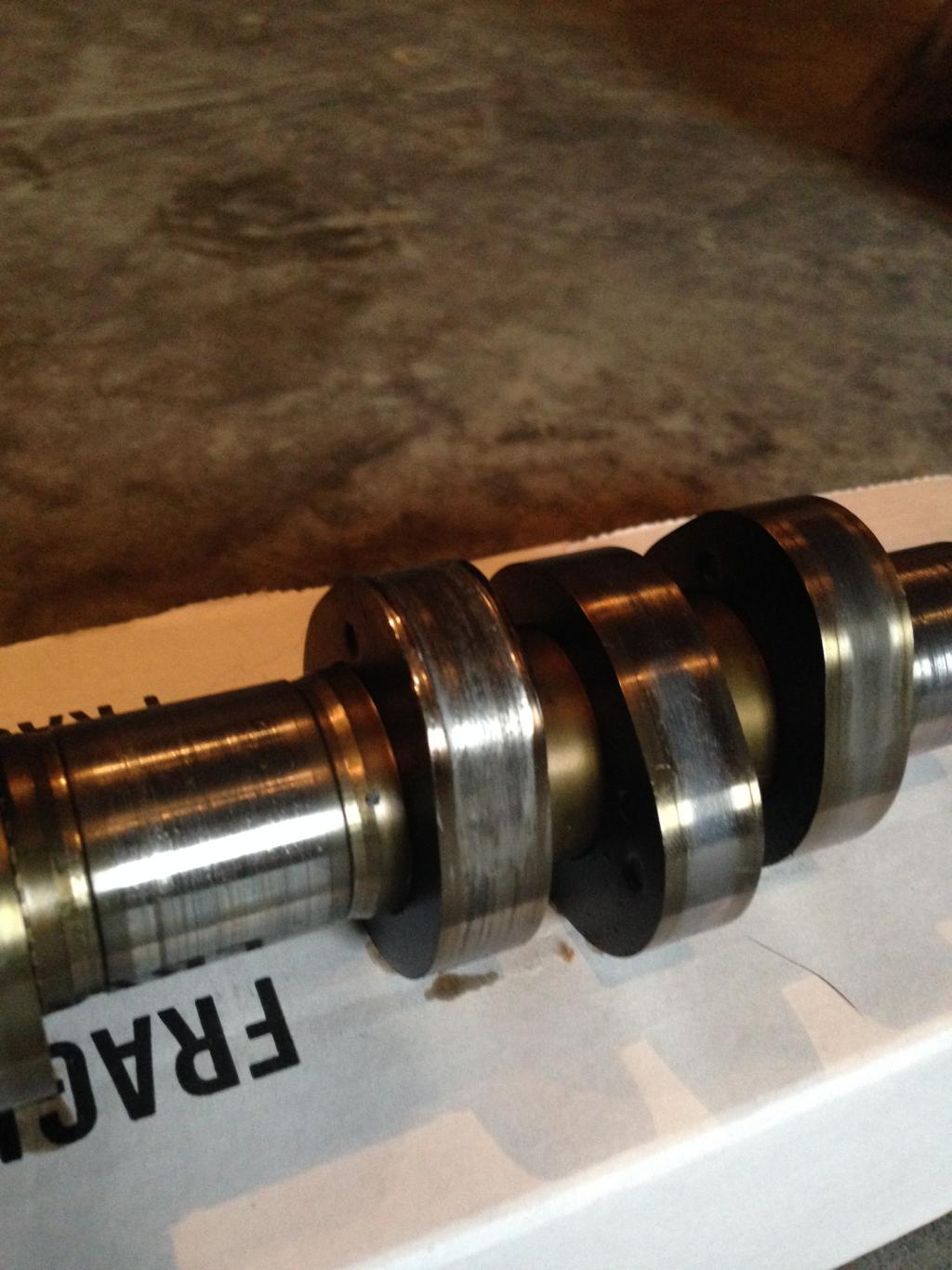

Just reading through this thread for the first time, a while back you mentioned that the old cams may have had some wear? Did you ever get pics of that?

I haven't, but I'll grab some pics of them later today. It was really only the drivers side cam that had the wear. Passenger side was good, as were all the lash adjusters, and all but one rocker. I don't know what caused the one lobe and rocker to wear.

Meangene, here are the pictures of the cam... Not the easiest to get a picture of the wear.

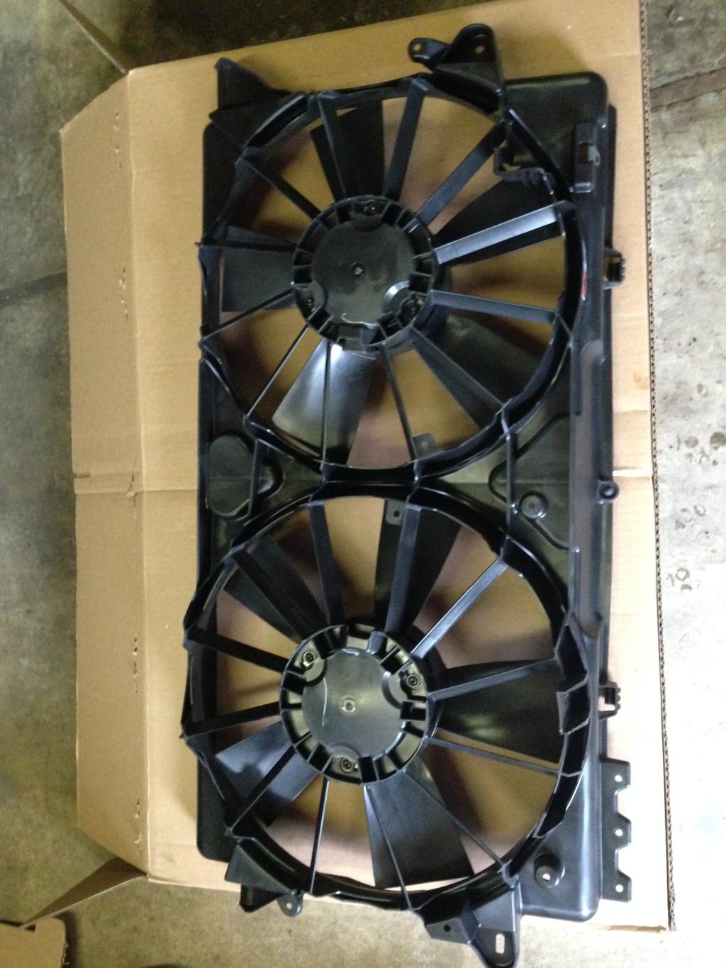

Also picked this up today...
According to the local Ford dealer it was supposed to have came with the controller. It never, but I'm going to have to source connectors for it now. Unless the painless controller has some that will work. I've also noticed that these fans are slightly different than others have posted. Now I'm waiting on the controller to get here, should be sometime this coming week.

You can get the Ford connector pigtail on eBay.
Good to see the e-fans are on the move. Can't wait to see them done

TL, I've been searching Amazon, and I may just call the Ford dealers here to see about availability. Rather stay away from ebay. It'll take too long for shipping.
