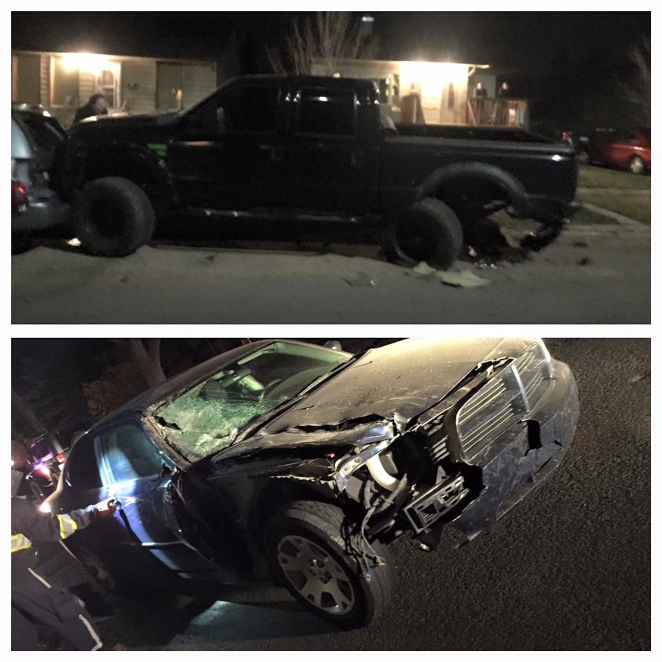

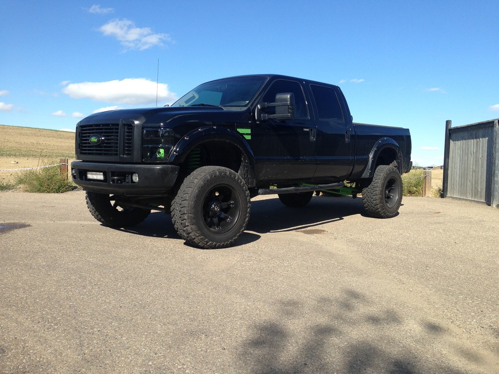

I've got another set on the go for my brothers truck. His 08 f350 got wrote off a month and a half ago. A drunk driver rear ended it while it was parked. It was a sad day.
He's since picked up a white 12' f350, purchased a 6" bds lift that he's had powder coated white, 37/13.5 toyo mt's, and 20x14 -76 fuel hostage wheels. So I'm gonna retro a set of lights for his new truck.

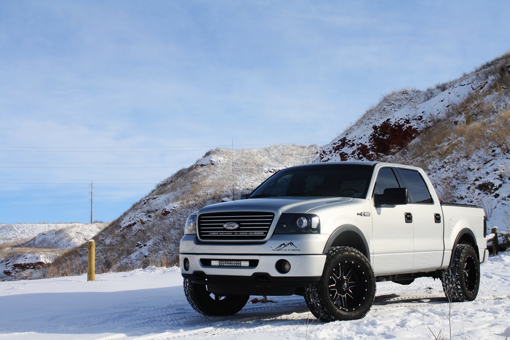

Also, I guess I should throw up a picture of my truck as well. Taken the other morning while out coyote hunting.

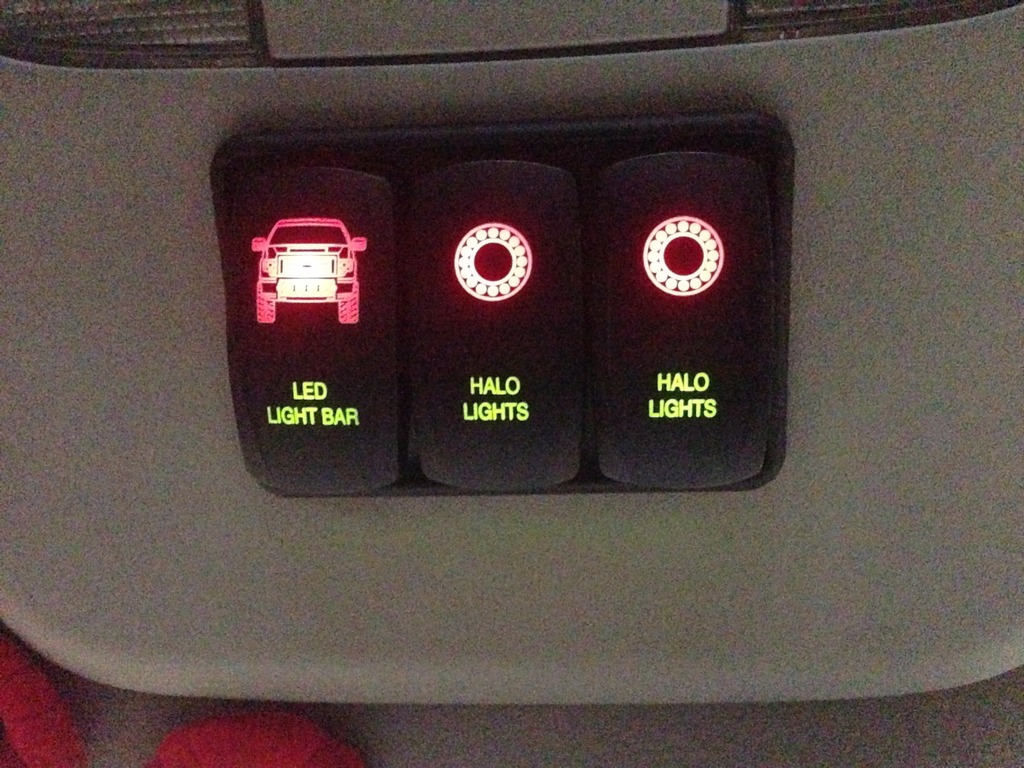

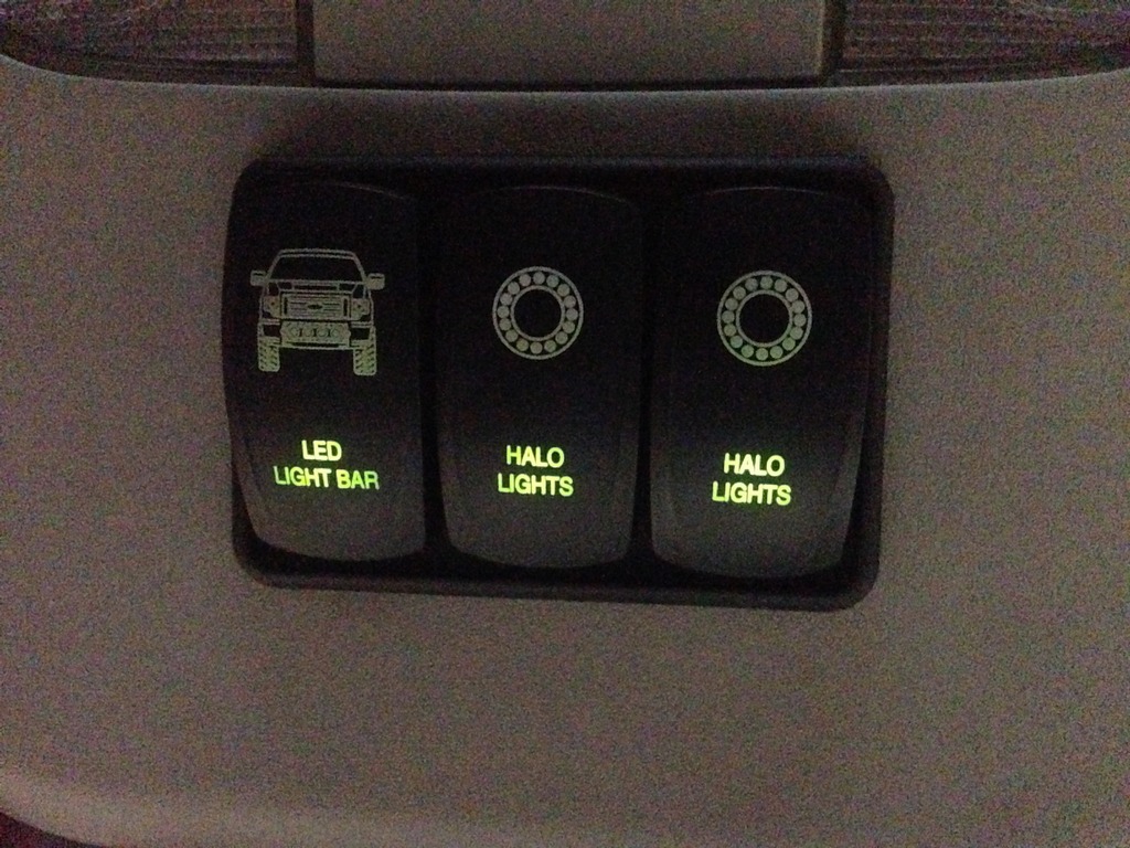

Finally got around to installing my switches. Installed in the overhead console. All run off switched power. Nice to not forget about my halo's anymore.

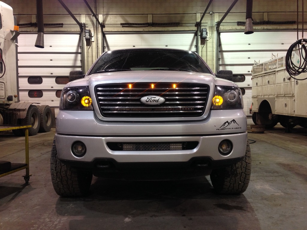

Also fab'd and installed some "raptor" style lights.

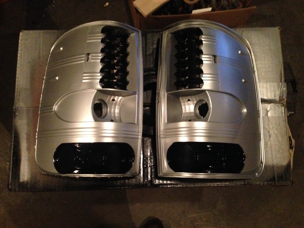

Also picked up a set of spyder led tail lights...

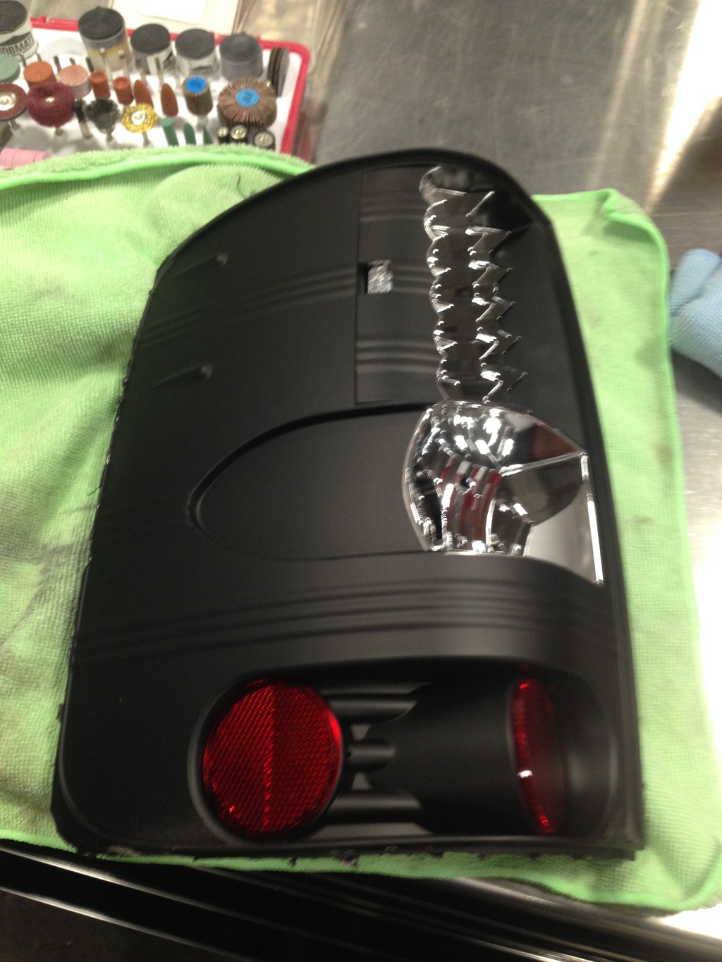

They have clear lenses, so I opened them in preparation to paint. Unsure of how I'm going to paint them. But I would like to have some silver in there as well as some black.

Something along the lines of this... With some black touches...

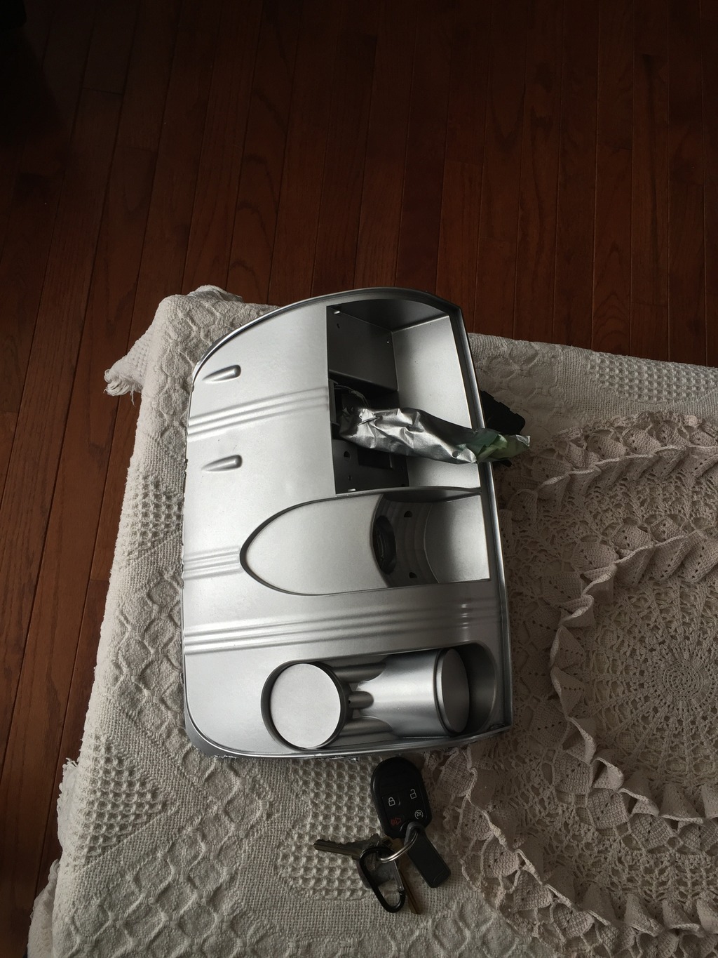

Just got done with the paint. Have a few small touch ups to do, then I'll reseal them by the weekend.
Turned out pretty decently I think.
And for future reference, spyder tail lights can be baked open.

what temp on the baking?
how long?
how will you re-attach them.
the black touches on the led lenses(reflectors) is awesome. i wanna do that with some of the black smoked ones. get rid of the clear/silver crystal looking reflectors.
very nice.
what about the reflectors? did you paint over them? we have to have those in texas...
Old Feb 1, 2016 | 11:42 PM
  #524
baticus's Avatar
Joined: May 2005
Posts: 777
From: Lethbridge, Alberta
I used a heat gun to open the one light, but I'm sure around 200F should be fine. But I wouldn't leave them in the oven for too long. The lenses are really soft at temperature.
The reflector bits I did just paint over. It wouldn't be too much harder to tape off the reflector, paint around, and then tint the reflector.
As for reattaching, I plan on using butyl sealant. I prefer the stuff that comes in a tube.
I'll post some finished pictures this weekend.
