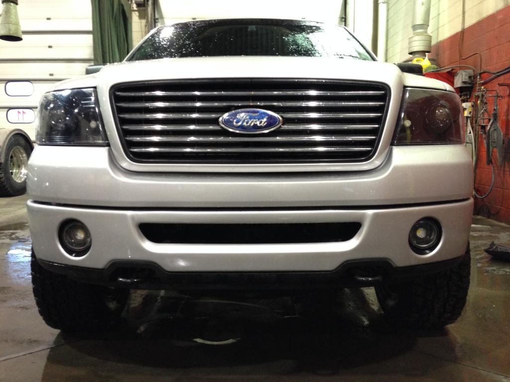

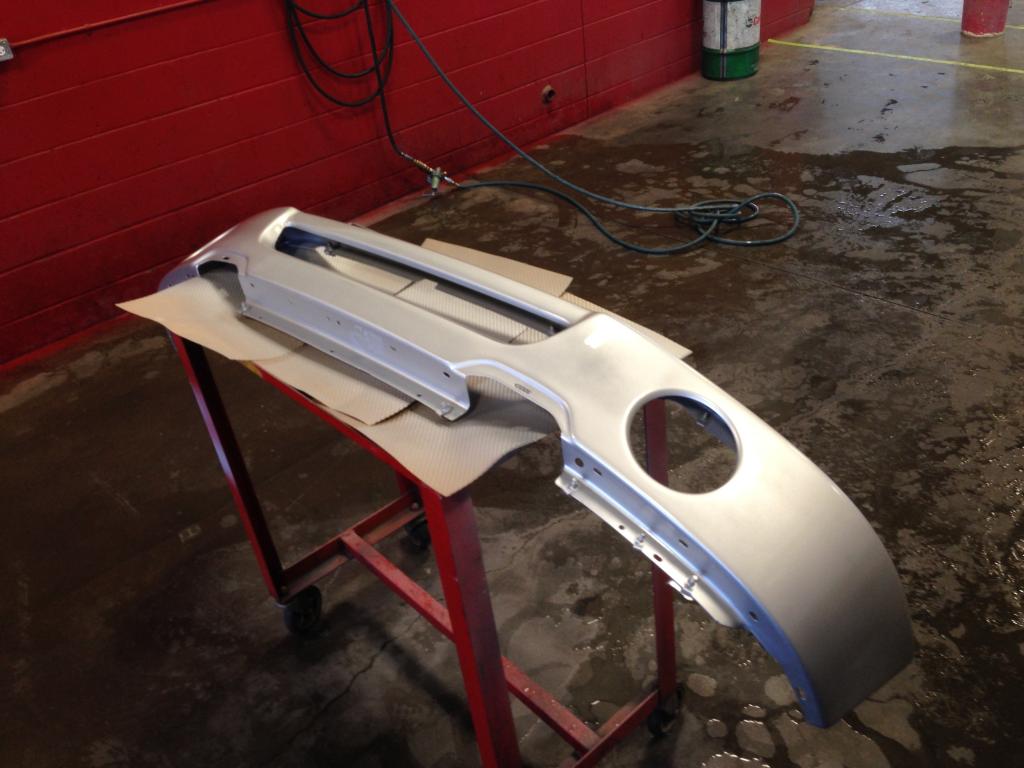

Another shot of the bumper! Hard to tell that it has paint on it. One of the nice things about using color matched primer.

The good news is, the bumper looks 100 times better than before.

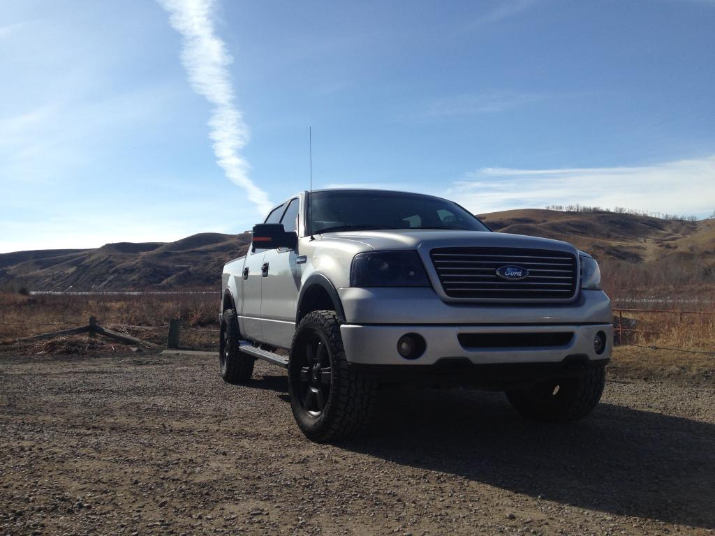

Turned out to be the vct solenoid. Still replaced everything again under parts replacement warranty. Truck runs stronger than before... Again.
Bumper has been reinstalled. Still need to put the rigid's back in.

Lookin good

Looks great Baticus! I think I asked before, but any plans for a painted emblem? Silver & black would compliment it very well. The chrome being black and the blue being silver PTM.

Bunper looks great man. What method of sanding did you use to remove the old paint? I'm looking at re-painting my bumper at some point this spring/summer.

I used a 6" orbital with some 160 grit paper. Went light with it once I got through the clear and paint. Finished off with some around 300. 3 coats of high build primer. Blocked out the flatter spots, and hand sanded the edges so I wouldn't burn through the primer.
It was my first time spraying a 2 stage base/clear. It sprays a lot thinner than a single stage paint. So it's easier to get runs. I luckily didn't get any this go around. I then wet sanded the paint to smooth out the light orange peel I had. Cleared it, now I'm waiting on some nicer weather to do a final wet sand and buff. All in all probably 4 hours total work. Although it burned up the whole weekend with dry time.

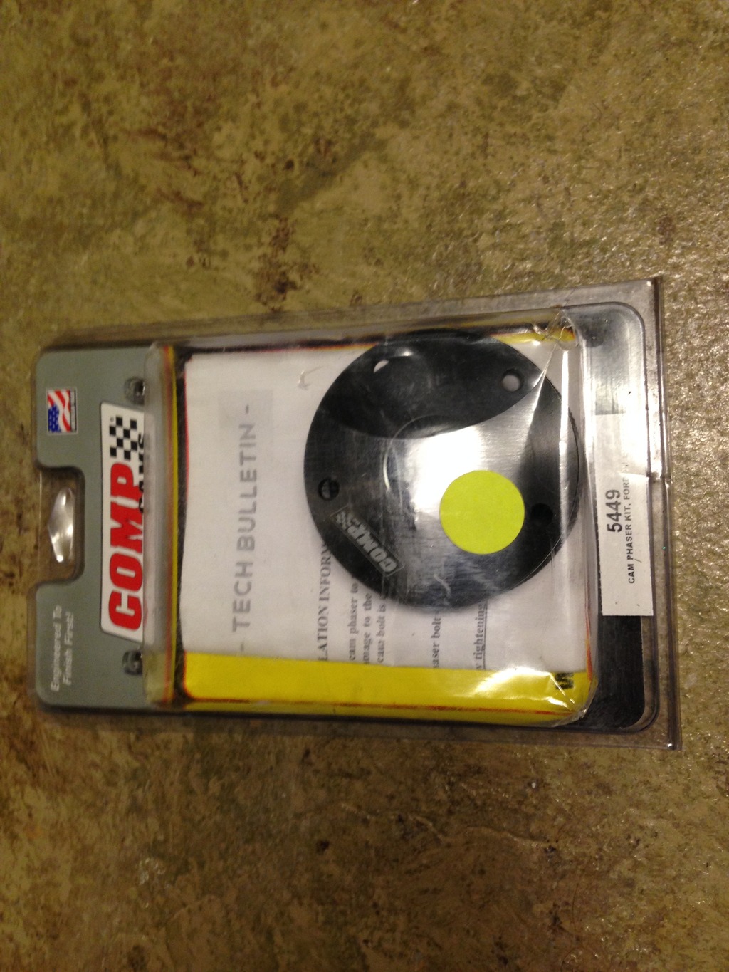

Been giving the truck a bit of a shake down the past couple of weeks. Sick of the whole phaser issues, so I bought these...
Nothing like tearing into it once more.

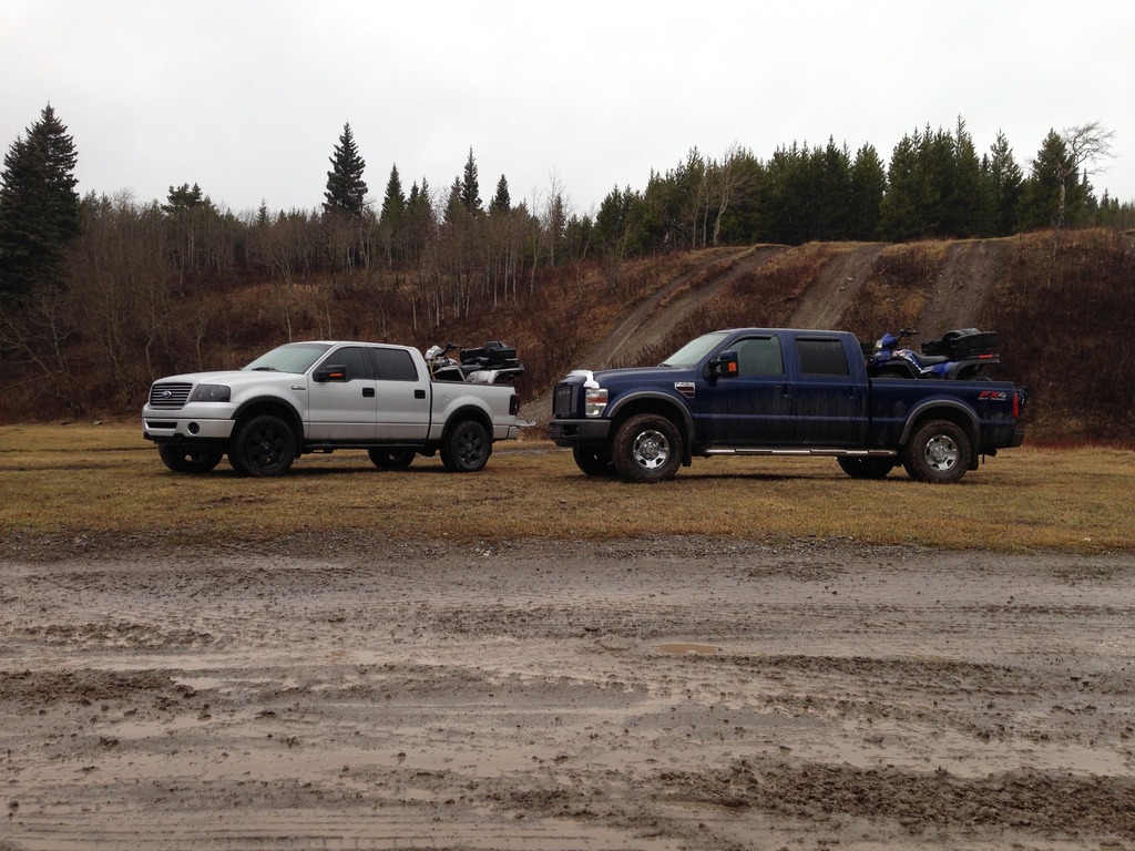

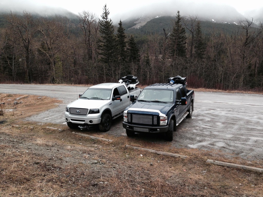

Did have a chance to make it to the mountains today. 300 km round trip. No issues.

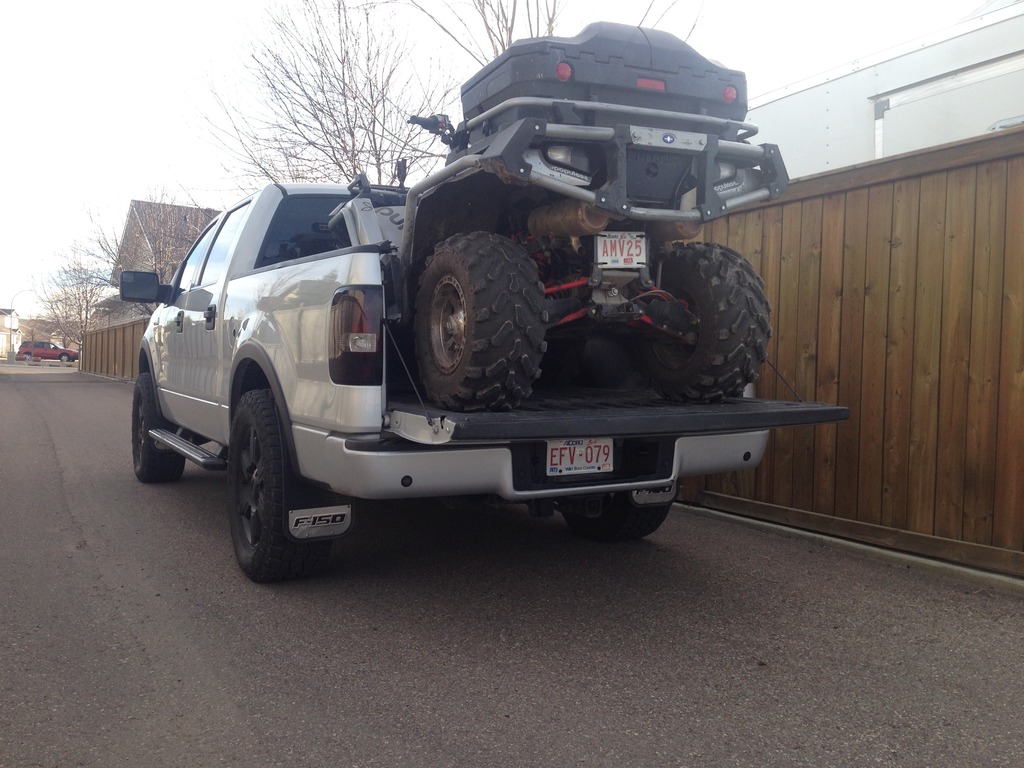

And obviously the only short coming of the 5.5 foot bed.
