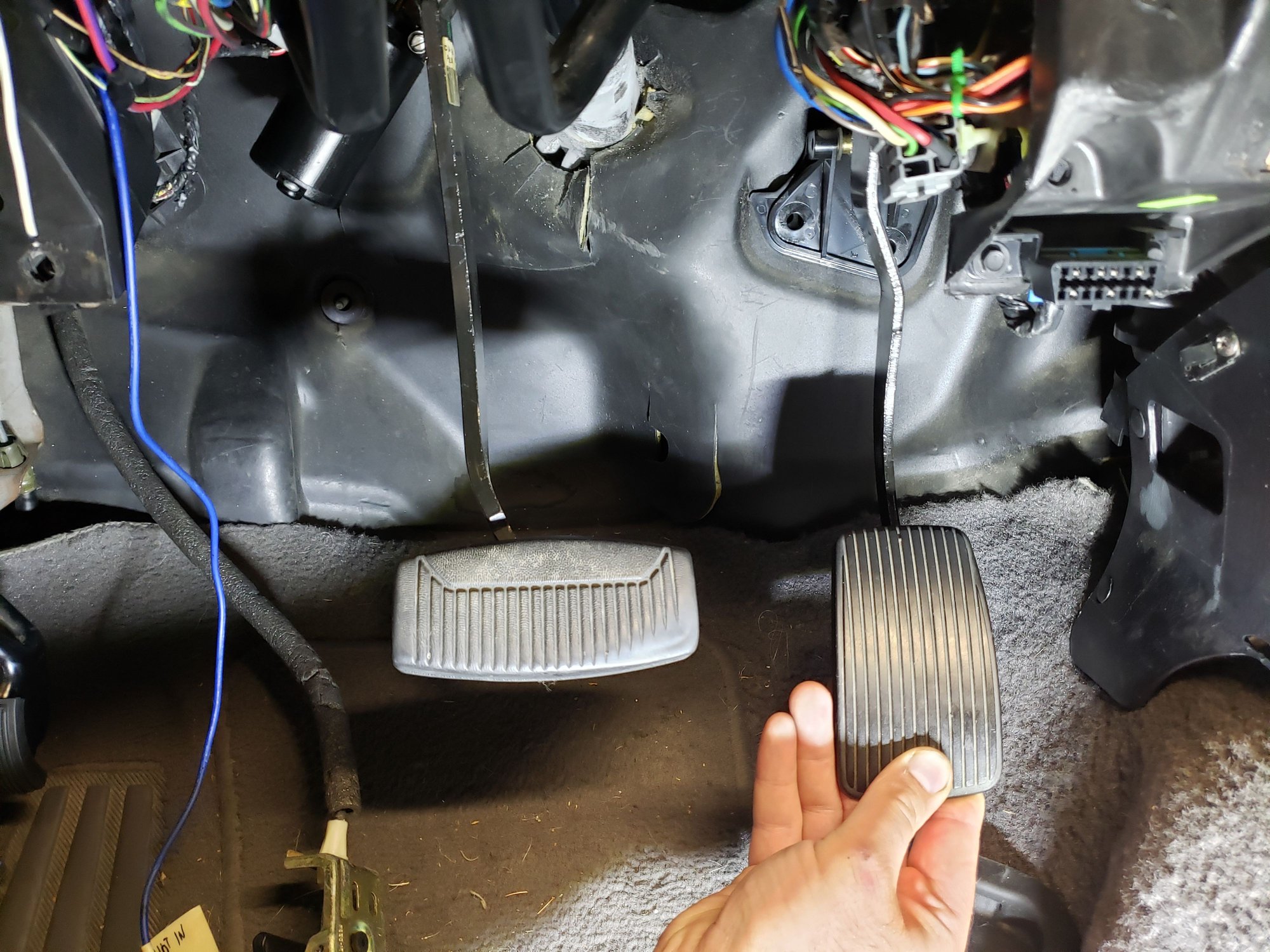

Mockup location of my new gas pedal

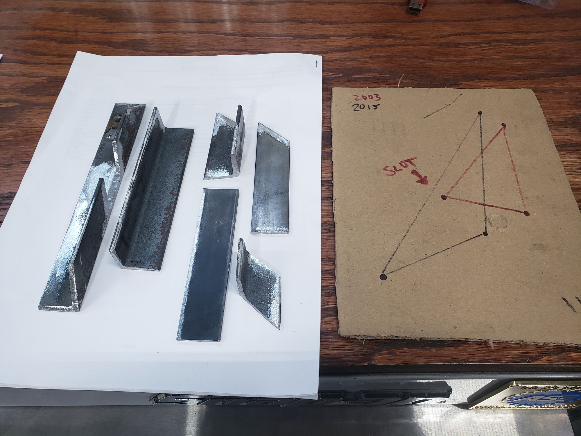

Made a template of the 2003 and 2015 bolt patterns
cut metal out for fabrication
initial layout/mockup
Fully welded
Drilled out for 2003 (threads in firewall)
Drilled out for 2015 and welded nut to the back side of adapter bracket
Painted it, paint is drying tonight. Then ill mount it up while i'm working inside the truck tomorrow
