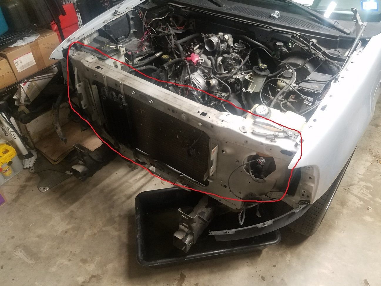

I've never had my truck torn down this far before. Can the portion of the front highlighted in red be removed without actually cutting it out? It looks like it was cut in previous pictures but I wasn't sure if it was due to the accident damage. Really looking forward to see how this turns out. Fantastic job!
it is spot welded to the structure of the truck. Short answer is no it can not be removed easily

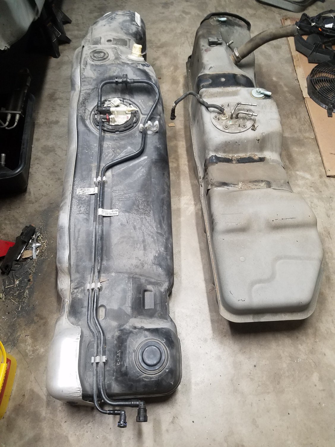

dropped the 2003 fuel tank out today. a few comparison pics and see what my goal is here. Doesnt look like the 2015 tank will easily fit (haven't tried yet) just comparing the two tanks
still may end up doing a custom 10-15 gallon fuel cell. still undecided

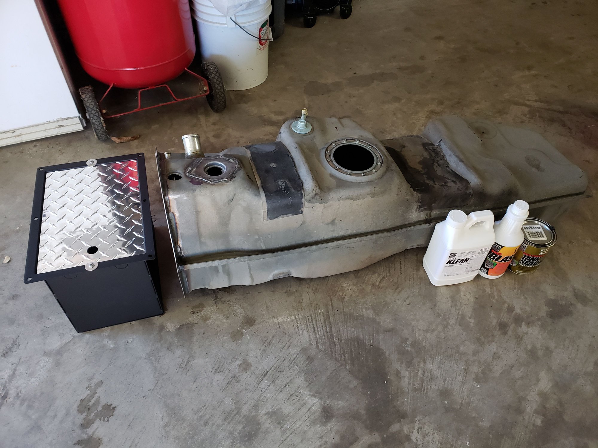

Started in on the tank sealing process on Sunday and found a leaking weld. Gonna have to address that before I can continue sealing the tank up. Here's the pics from this weekend

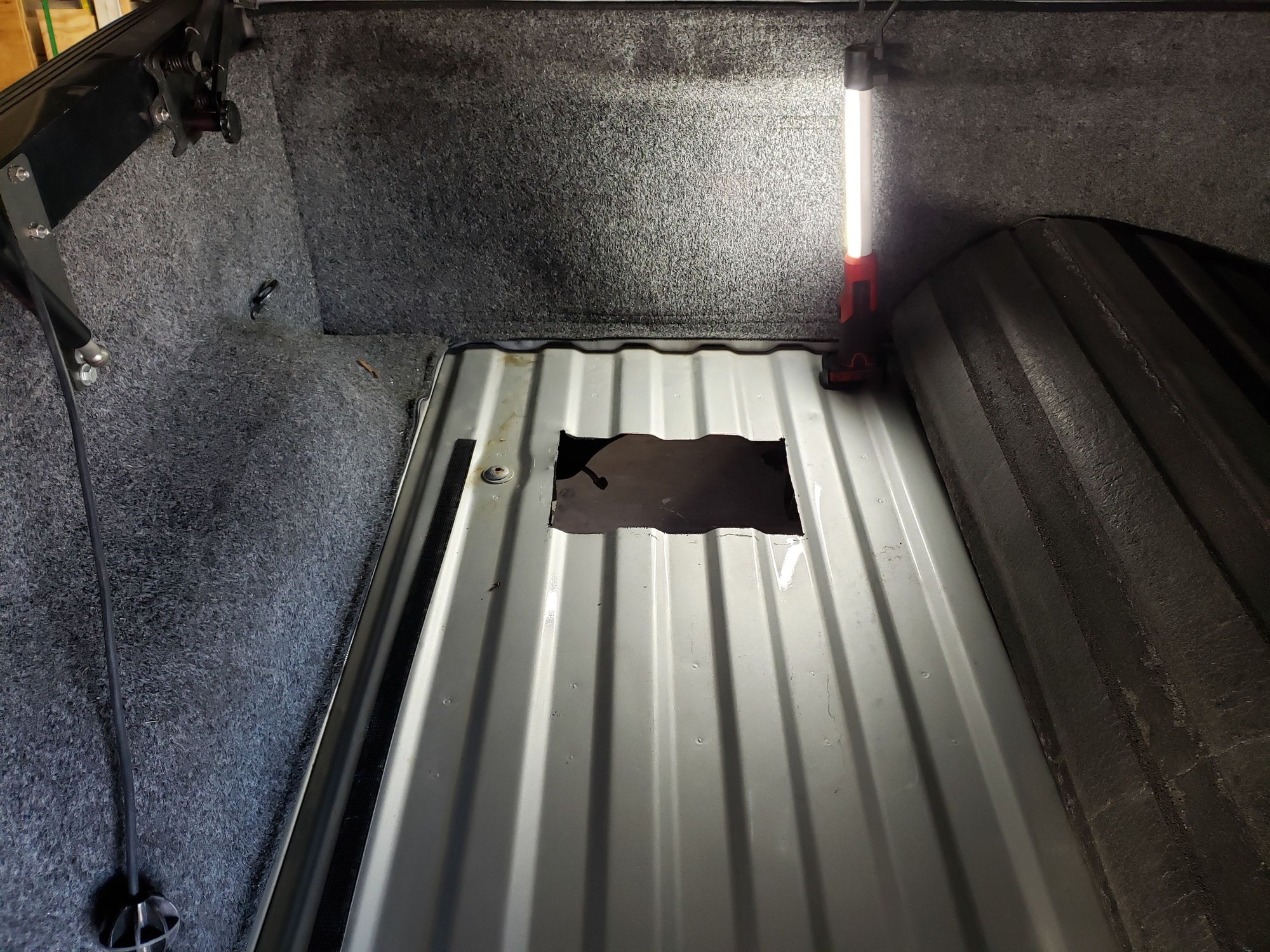

And that's my new sub-project. Flush/floor battery box
Cut a big hole out. No turning back now lol
Measure twice cut once. Made sure it would clear everything under the truck, and play nice with the shortened gas tank

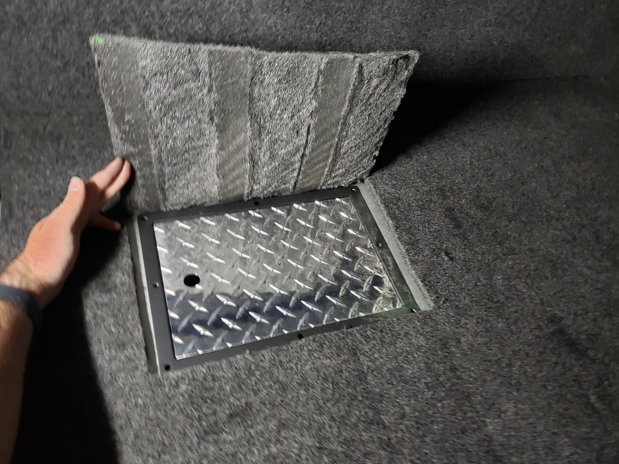

Diamond plate lid. Has two small Allen screws that hold the lid down
I will probably end up putting some velcro on this top help keep it down when it's not in use
I am really happy with how this turned out. Most people will never know where the battery is hidden at.
Also this helps with front to rear weight balance, as well as lowering the center of gravity a bit too

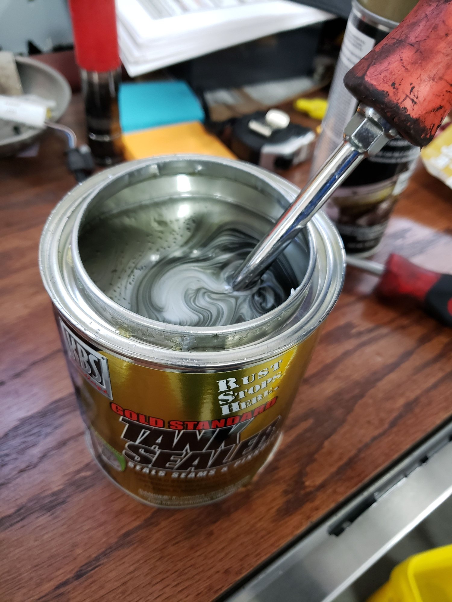

Tank sealer mixing
