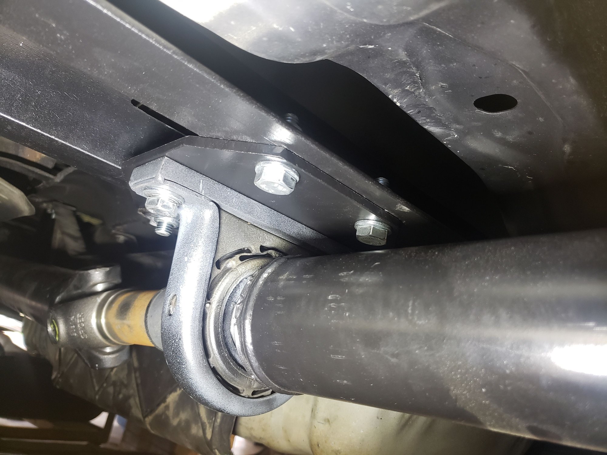

I moved my CB location up, built a new bracket to help straighten my driveline some.

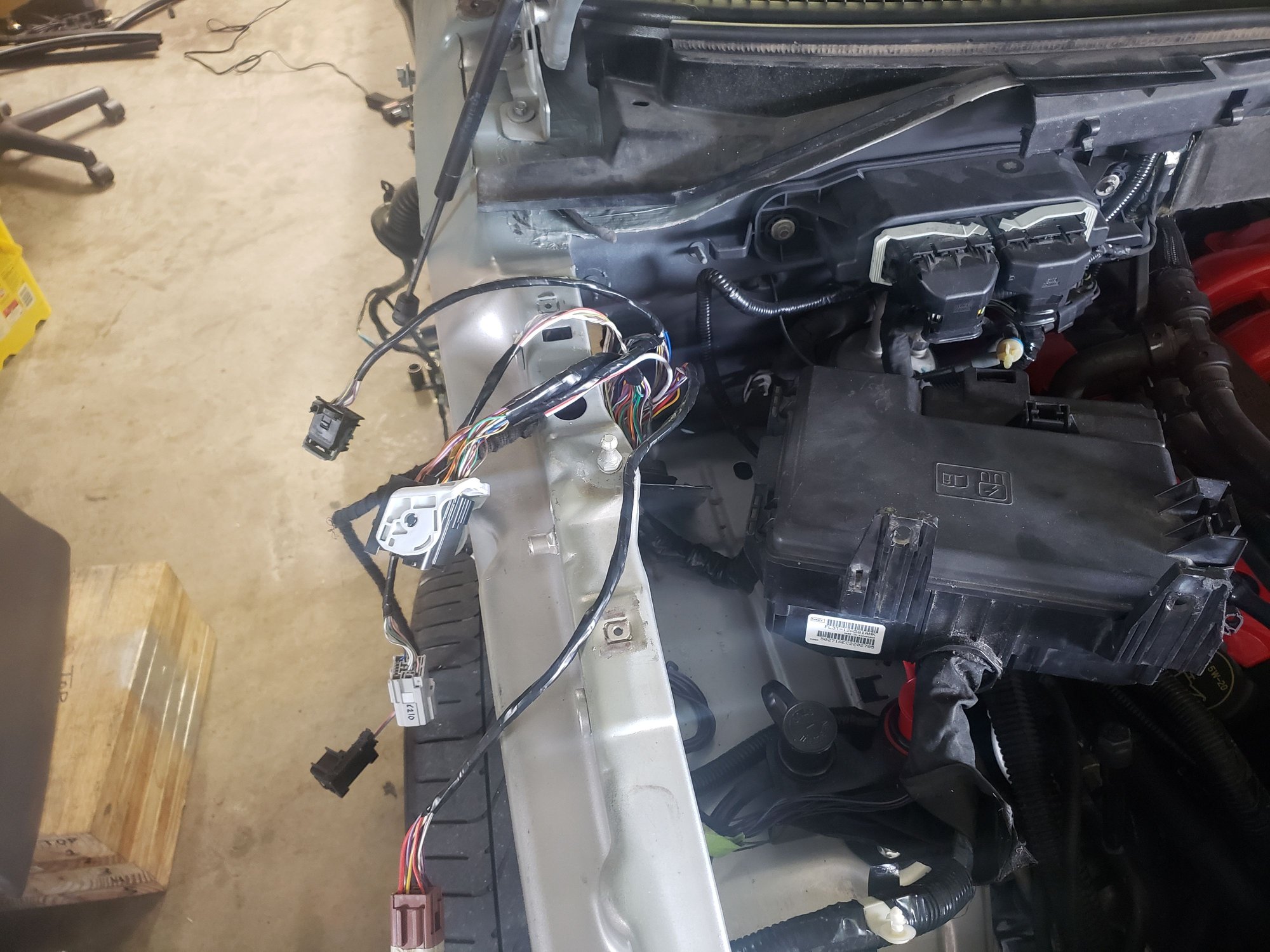

I tore down the truck to swap doors, and found out that Expedition doors and Supercrew doors are actually different internal shells. While i had the door off I went ahead and tidied up the wiring in the RF corner. I got the donor CJB fuse box tucked up on the RH kick panel area

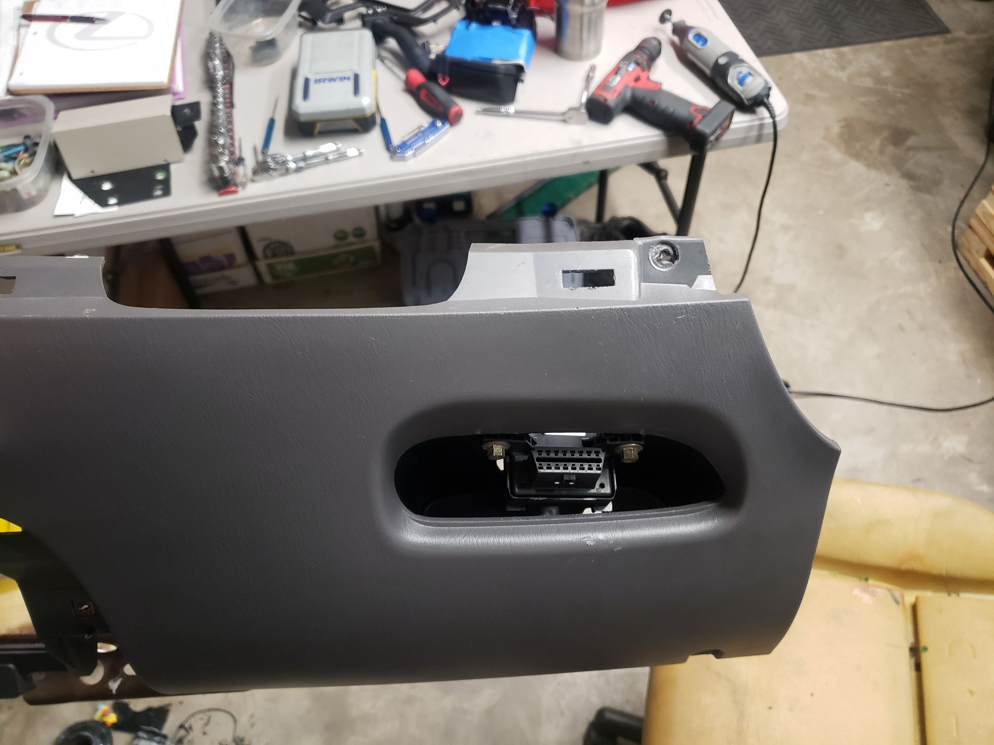

I mounted my 2015 OBD2 port in the pocket on the knee panel below the steering column

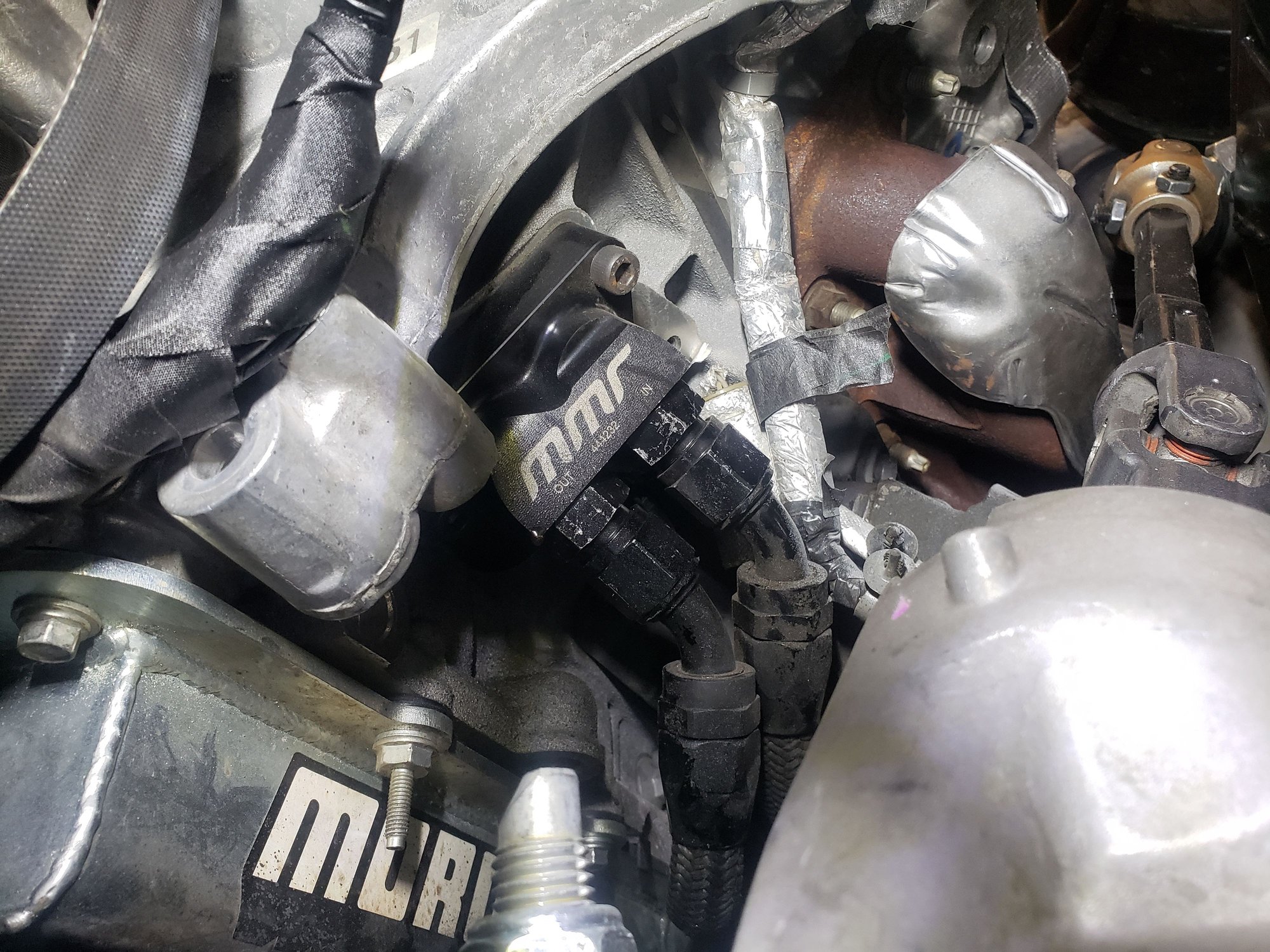

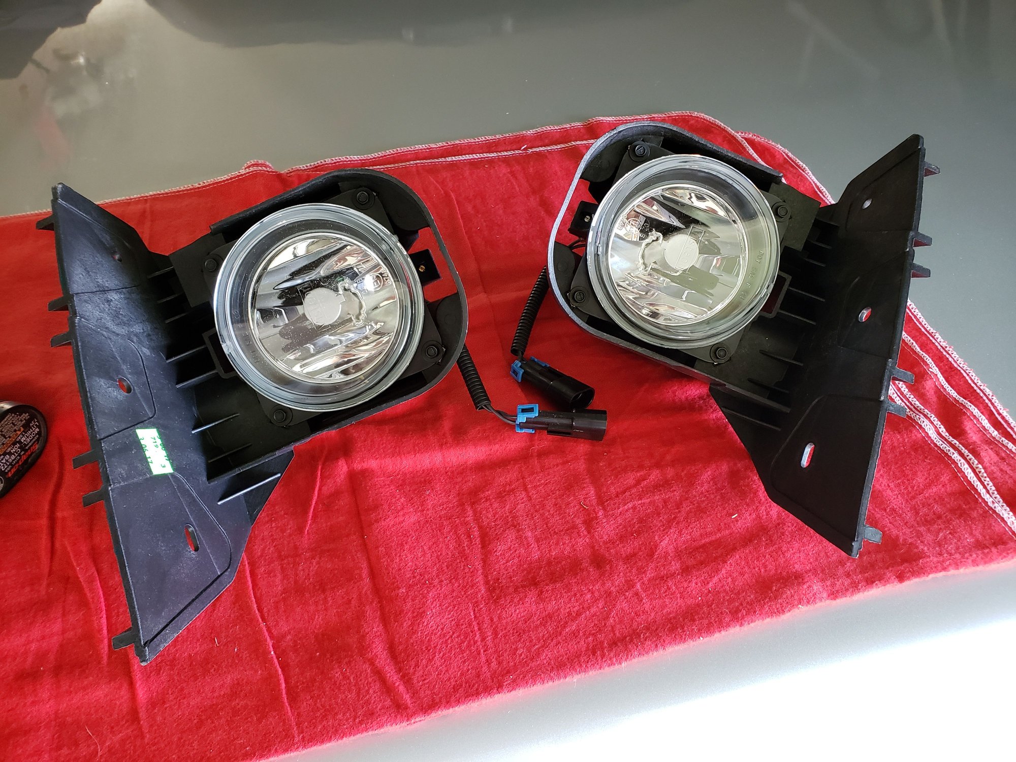

I did some more test driving and found out that I had a minor oil leak to address. I had several issues to work through to get to a point that I was happy with it again. Removed alternator to gain access to the MMR oil filter relocation adapter.
Installed brand new OEM HarleyDavidson / STX fog lights
