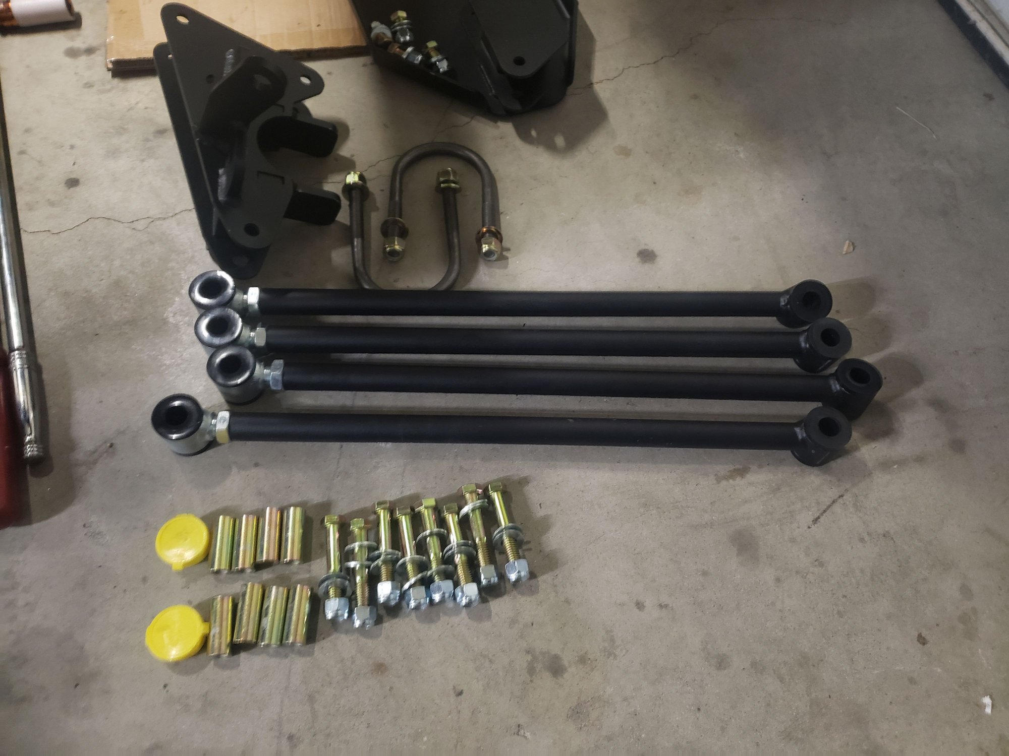

I ordered wheel studs today for my new axle shafts. Couldn't contain my excitement and dug into the 4link kit today.
Got everything laid out
initial setup off the truck

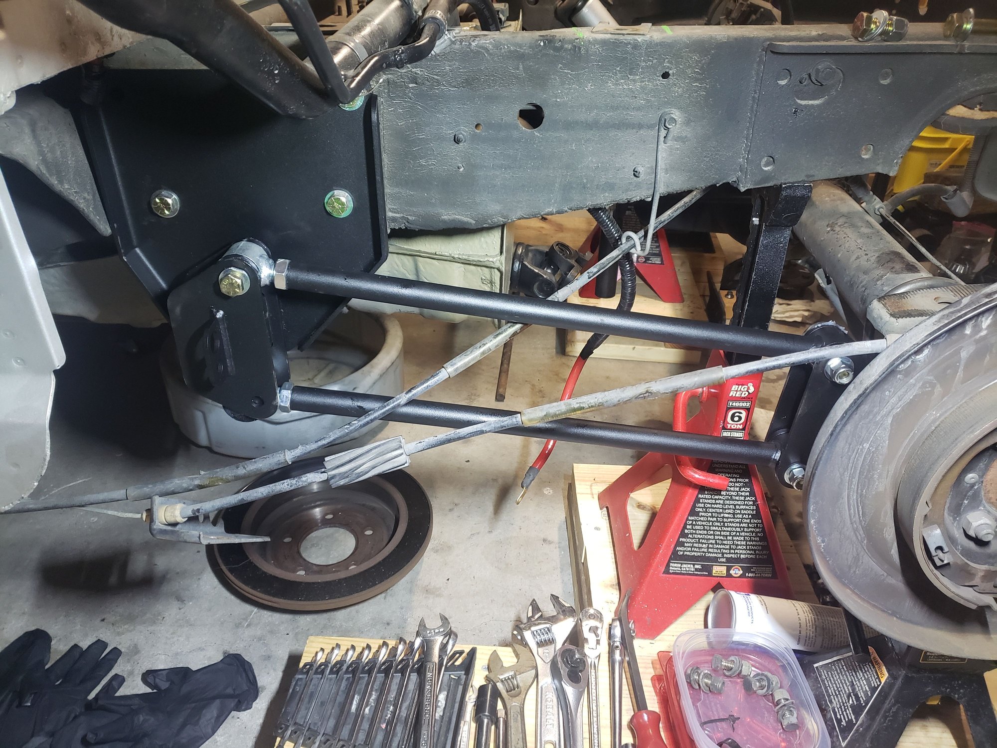

Quick mock up on the driver's side.
I'll need to go back and finish adjustments and all that, but I should be able to take some more real measurements soon so I can get my coilovers ordered

still needing to set pinion angle, and do final measurements so I can order the coil overs

Got my new cover all sealed up:
Left side, mocked up
Right side mocked up
