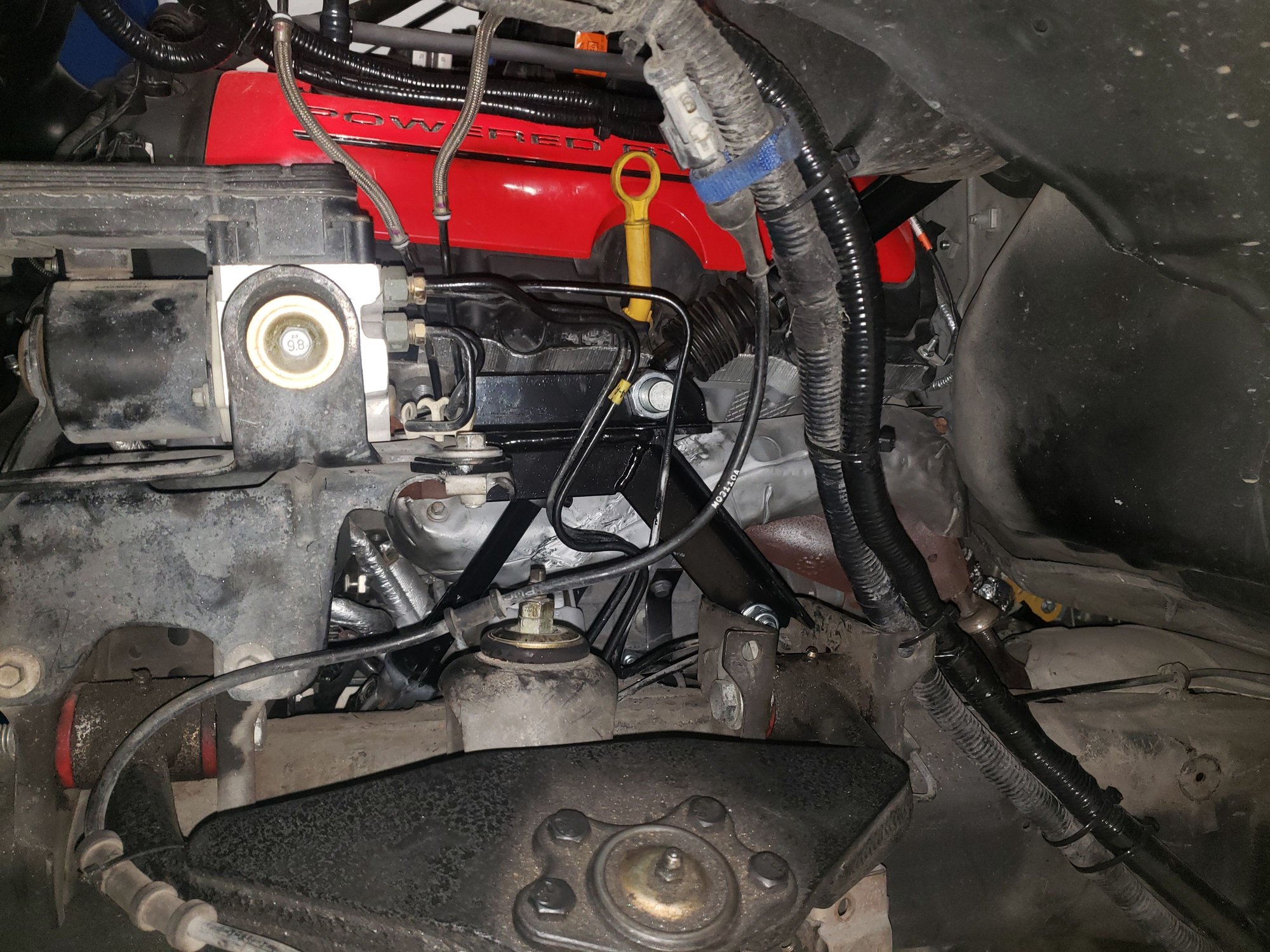

Got the bracket welded, then painted, and reinstalled the modified shaft
My steering wheel is clocked 90* to the right now. I think I've got a clever way to fix that. I did pull the steering wheel off last night and its splined in a way that you cant reindex it

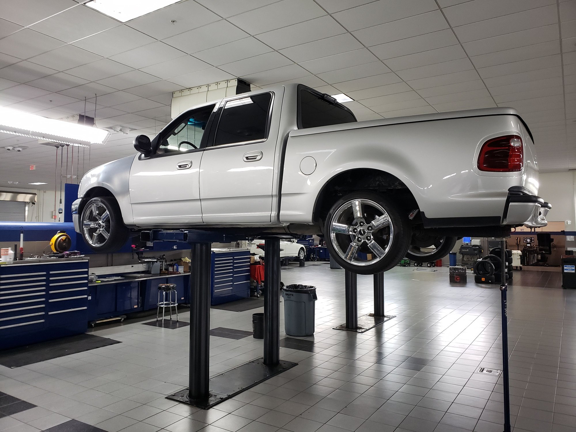

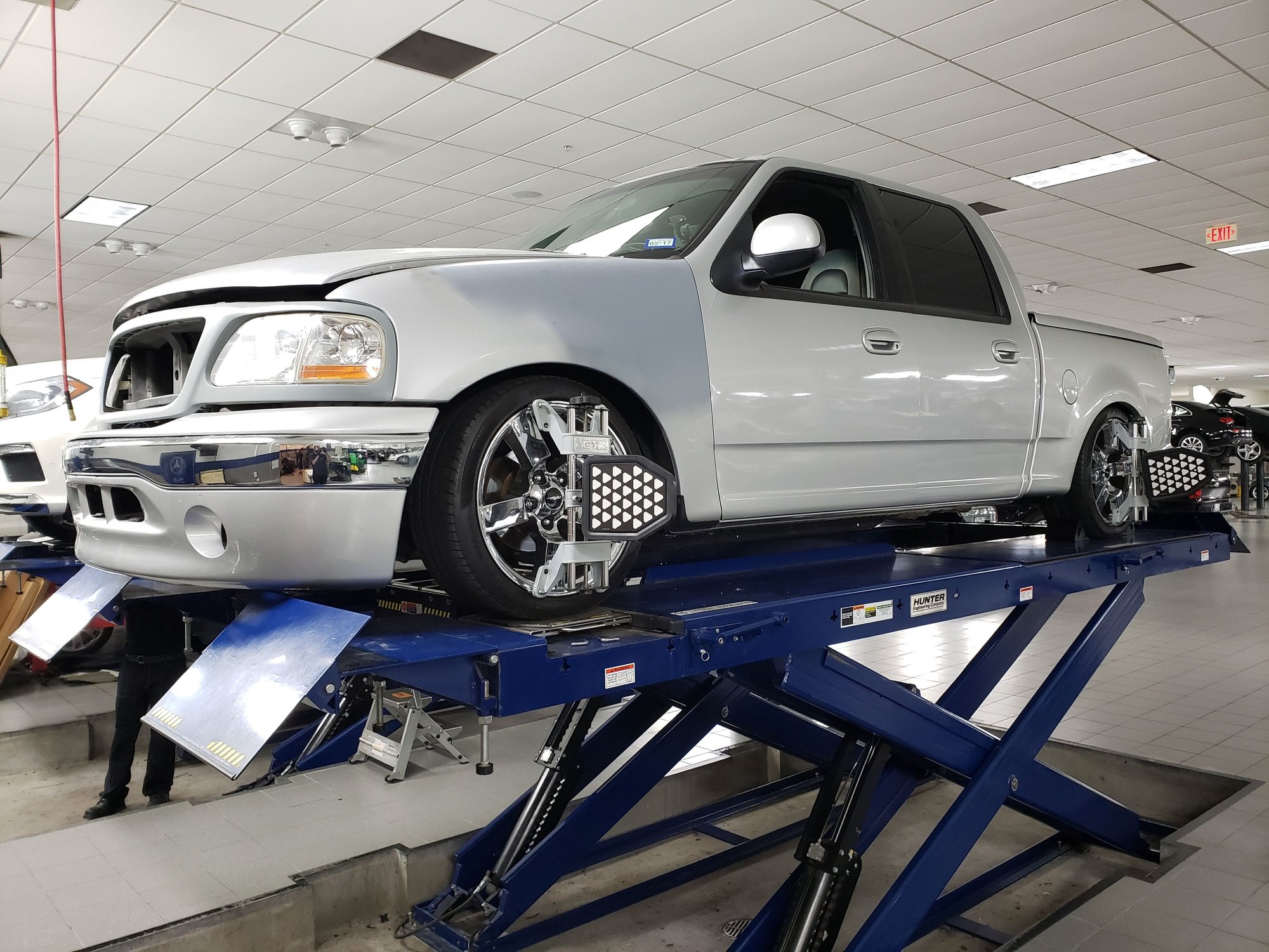

Got the alignment checked. My at home alignment was very close, just the steering wheel was off center. Now its spot on

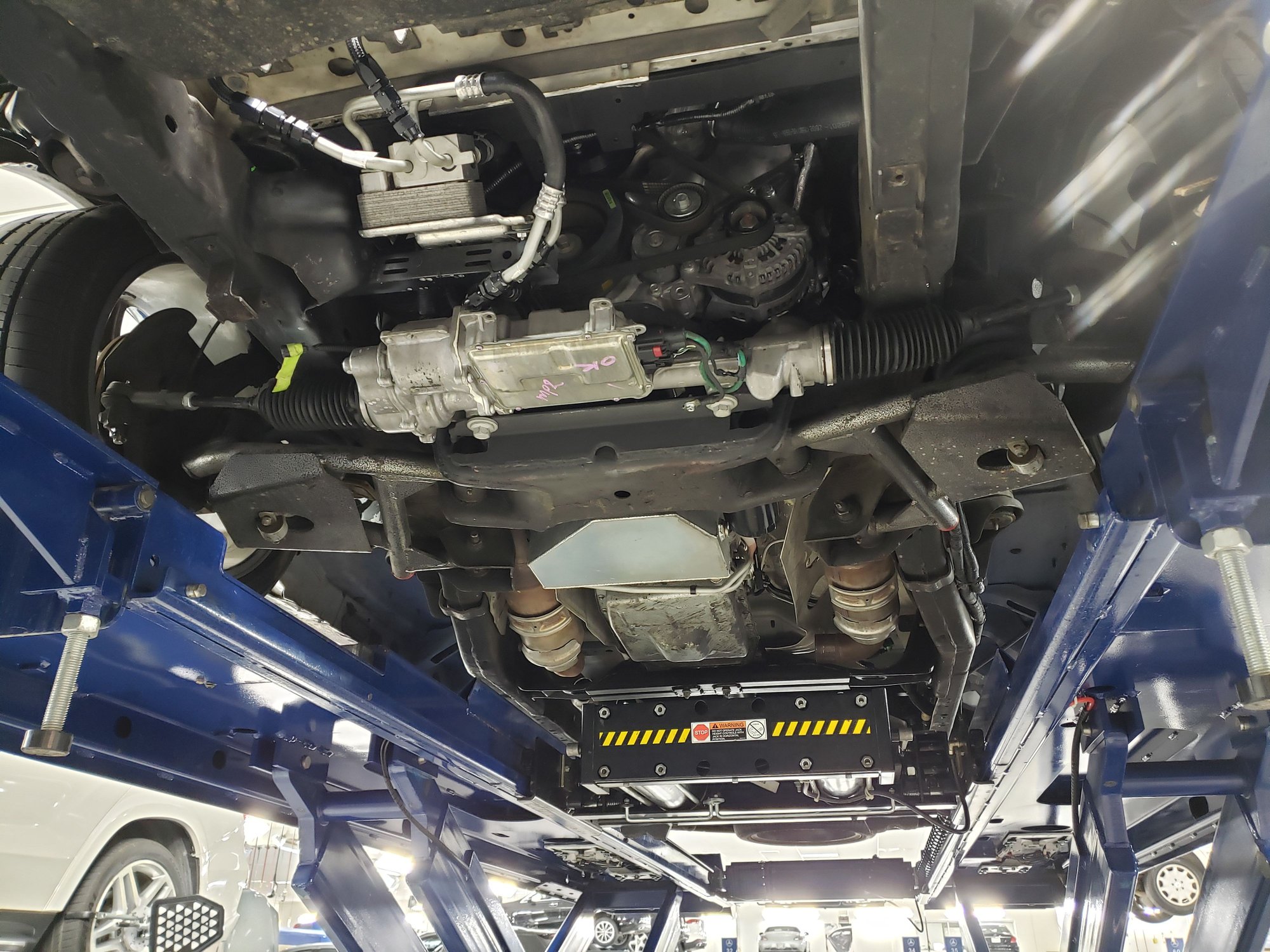

Random undercarriage shot while on the alignment rack
Went to a two post rack, and swapped out my axle shims. Went from 3.5* to a 6* shim and it fixed my angles and subsequent vibrations under throttle/power
Also did a full brake fluid flush to new DOT 4 brake fluid.
Very happy with my progress today. Still trying to get the monitors to run, but its nice to actually feel confident to really drive her now.

What are your plans for the front sway bar? It looks like it would be pretty tight.
Old Sep 22, 2019 | 02:30 AM
  #190

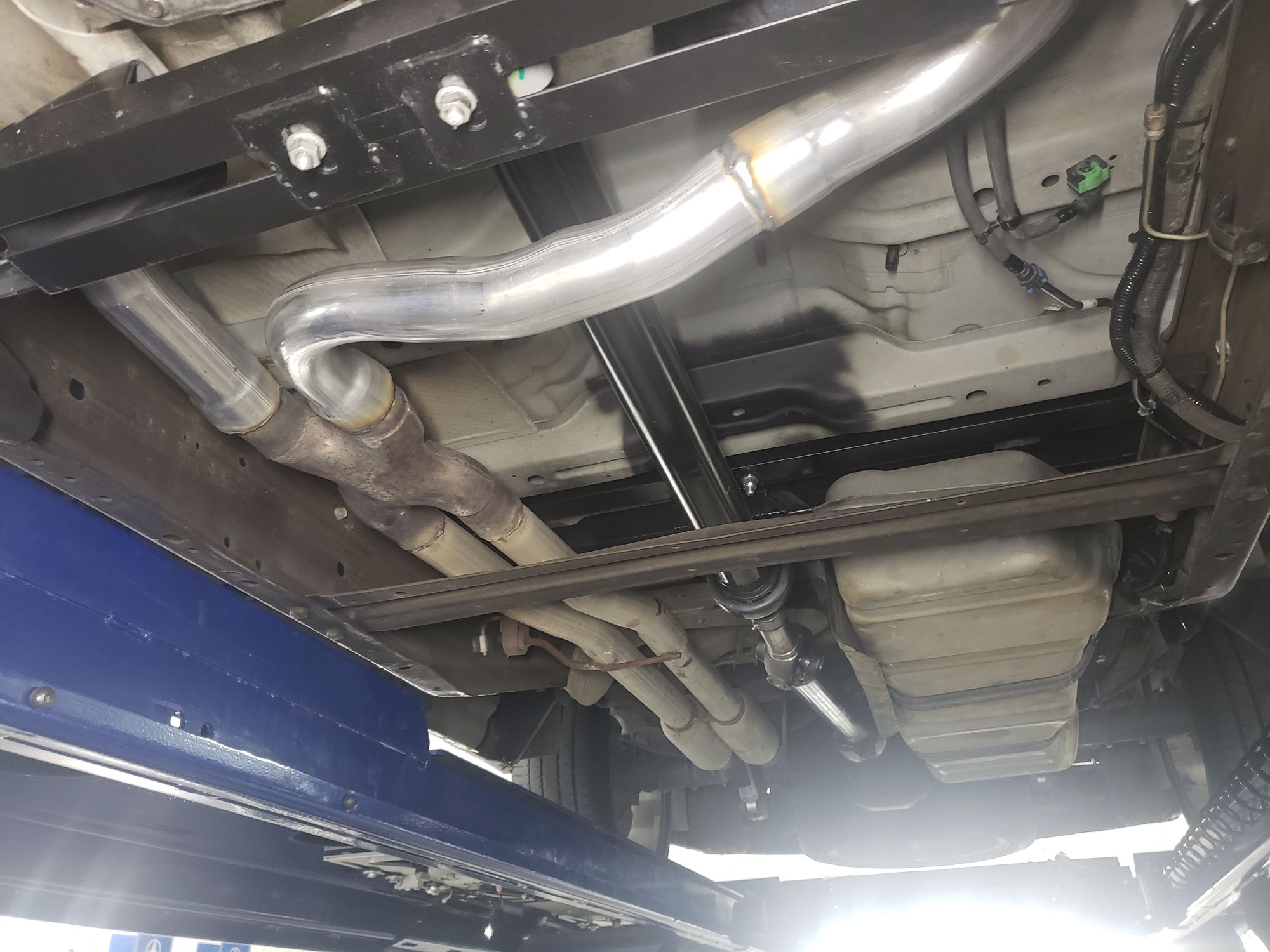

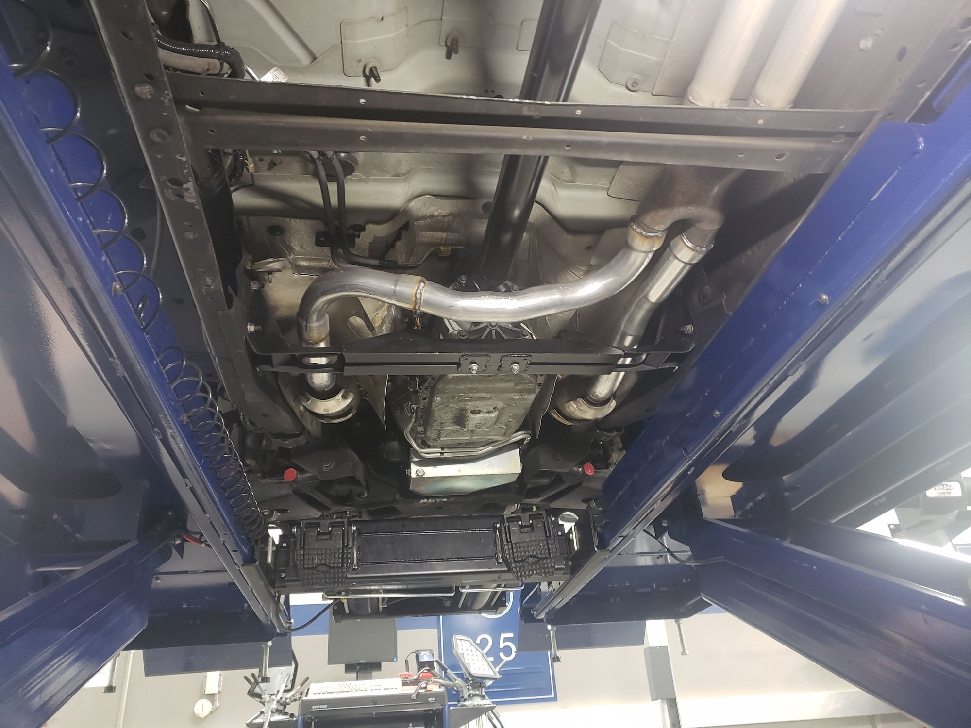

Got exhaust done today. Ive got some pics/videos, will work on getting those poster
Drove about 100 miles on her today. Made it out to the Coyote Shootout. Didnt get to run it tho. My leaf springs are way too soft/weak to handle the torque of 1st and 2nd gear. Probably gonna end up doing custom 4 or 5 link setup now
I haven't had one on since I went 5/7 drop. I found some custom end links, might actually put it back on now
I eyeballed it and it looks tight but looks like it will clear the rack.

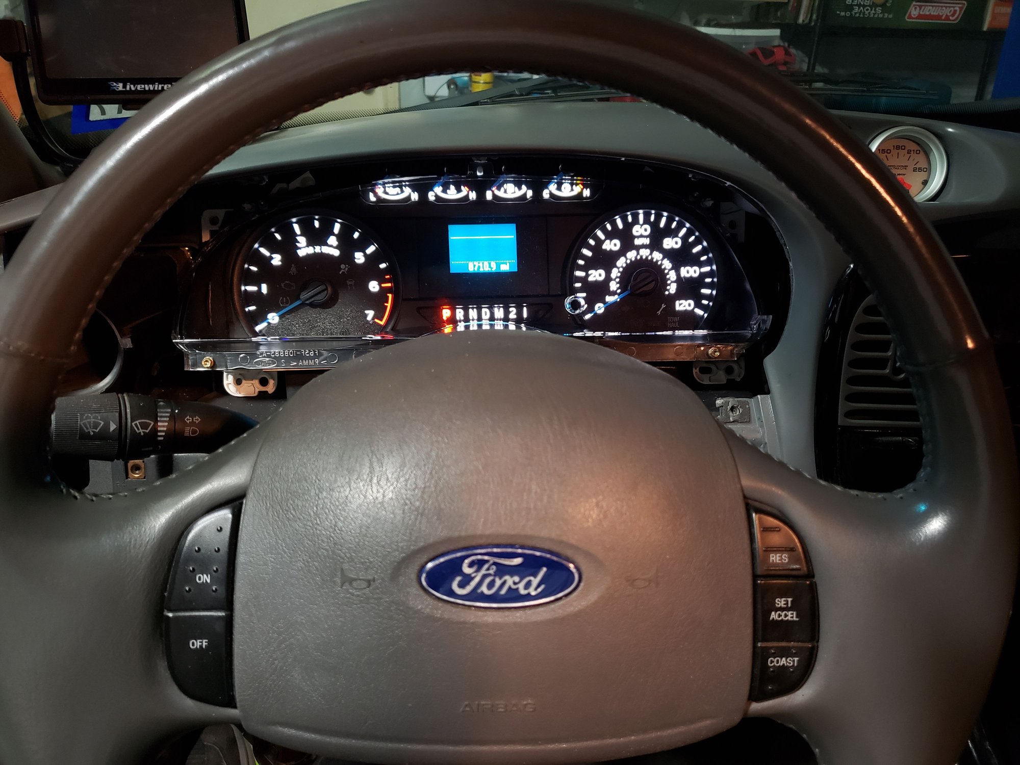

Back at home, I love the way the cluster looks in this truck!
