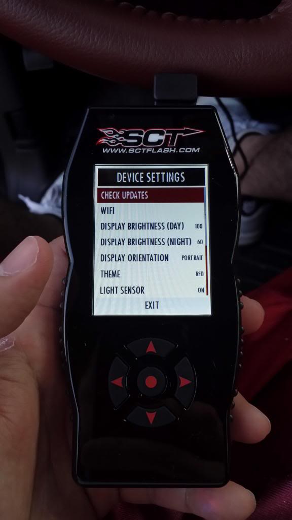

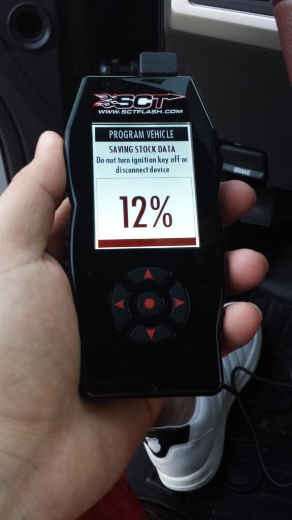

So one thing to note, there was no manual included with the SCT X4. Not sure if there isn't one, or someone messed up. So I had to jump right in. I hopped in the truck, took the Diablo tune off, and plugged in the SCT. First impression: this thing is FAST! It boots up, backs up, and writes a tune probably 3x faster than the Diablo Intune. The LED screen is awesome and navigation is extremely fast. I connected it to my wifi just to make sure there were no updates. Then, I put the 87 Performance/Tow tune on it. I looked through the settings and I noticed it said that the tire size was "stock size." Not being sure if it was written into the tune (I specified tire size on the calibration sheet), I went ahead and wrote the tune. It took about 4 minutes to write and I was ready to give her hell. Immediately I noticed this was a brand new truck. Seriously night and day difference. I also quickly noticed that the speedo was dead on (awesome job 5 Star ). Throttle response is better, get up and go is better, and I noticed it stays in 5th gear now around town. I then jumped on the highway to let her loose. Man, just awesome. Soooooo much better than what I have been driving around with. And this is just the 87 tune. I am going to run this tank of gas down and probably try a tank of 93 after this.
For anyone contemplating this setup...DO IT!!
