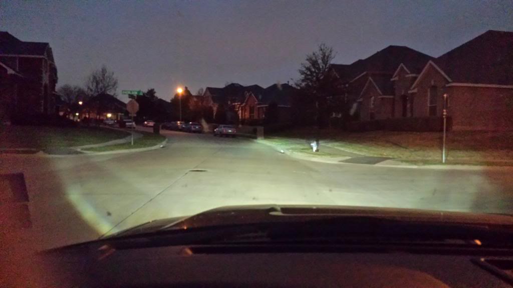

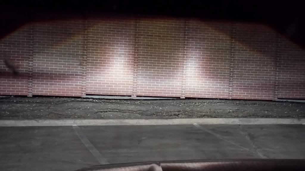

Well, I got to take her for a drive tonight to try out the new headlights. For reference, here is a "before" pic with the stock HID heads:
Notice the lack of side to side lighting here.

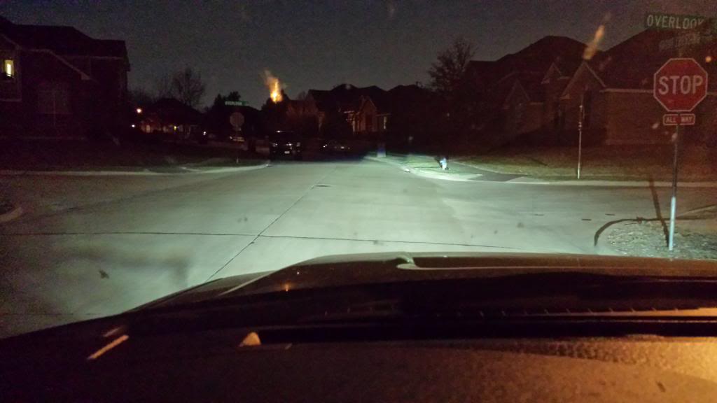

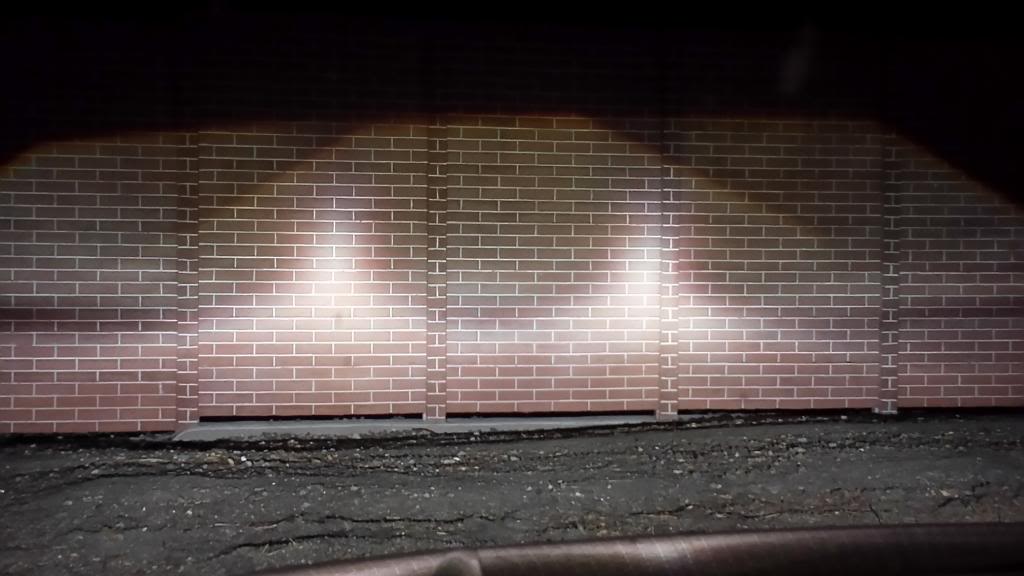

Overall, I would say this is a HUGE improvement over stock. The side to side lighting is ridiculously better and the light spread is much smoother. I do, however, think I have an issue (possibly with bulb seating???). The first pic is taken in the same spot as the before to show the difference:

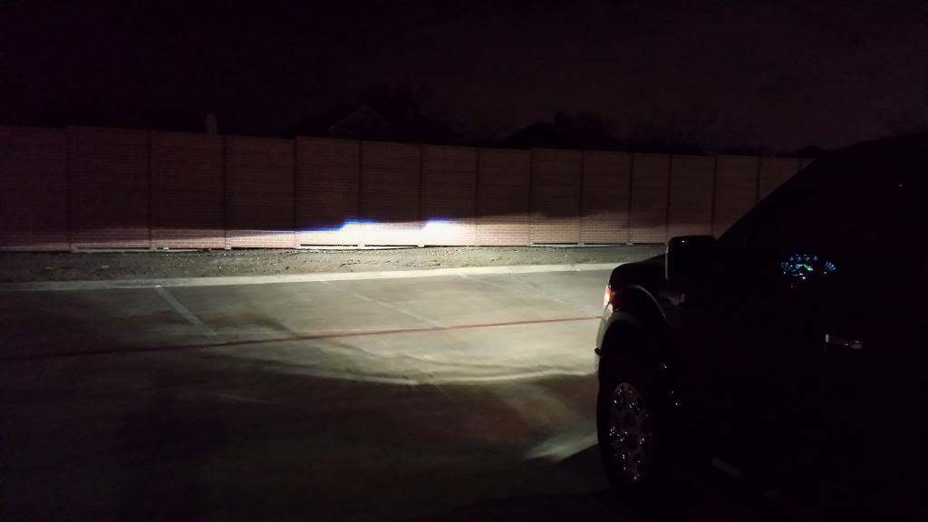

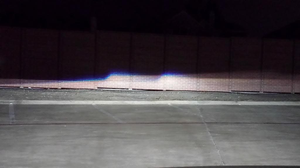

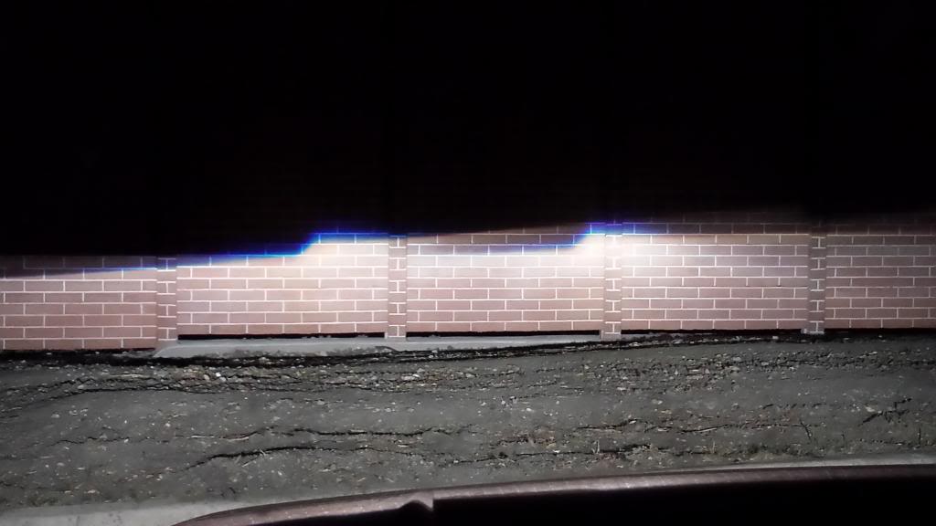

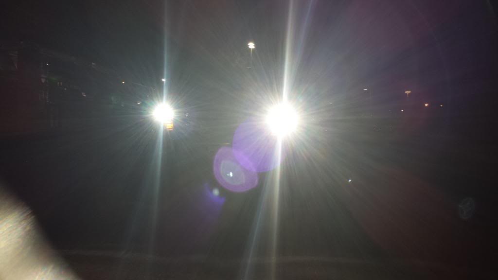

These next photos show what I think might be my issue. Notice the cutoff line on the driver's side especially. It slants up and to the right:

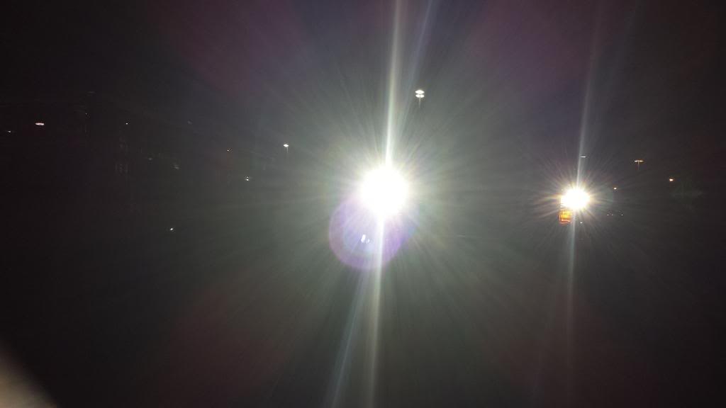

High beams:

Big difference side to side for sure. Looks like the cut off is high maybe try removing the bulb and putting it back in or maybe the headlight it self is crooked maybe fixed through some sort of aiming or adjustment. Idk if they can be "aimed" or not. What kind of lights did you get?
They can be aimed, but only up and down.
'13 OEM heads with the EvoX-R projectors, Osram 66240 Nightbreaker bulbs, and 50w ballasts. Basically I just paid someone else to swap the stock projector, bulbs, and ballasts for better stuff. But I had to buy the whole heads rather than just paying for the components and work. Fortunately, I already have someone lined up to buy my stock heads. So that alleviates a good portion of the price.
Old Apr 1, 2014 | 10:17 PM
  #156
F150redFx4's Avatar
Posts: 162
From: WNY
Very nice job. Hmmm head light bucket it self maybe its out of whack or crooked a lil bit somehow?

I hope that cutoff isn't that way because they were installed crooked. Looks good other than that though.
Well, I guess I never updated that. I talked with Dawson and ended up sending the driver's side headlight back to him this weekend. The only thing he can think of is that one the ball joints (?) inside came loose during shipping. He said he's seen it before. So I'll hopefully have it back in a couple of weeks.

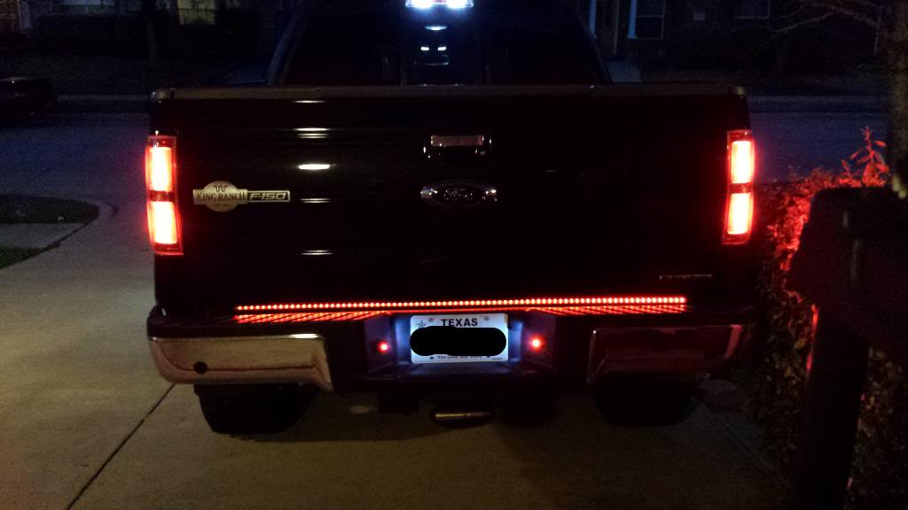

Originally Posted by UCF150
Hey man, if you got the itch to take some pics of your ride, id still like to see how those amber license plate lights look
Here ya go bud:

Looks good, I am a fan
