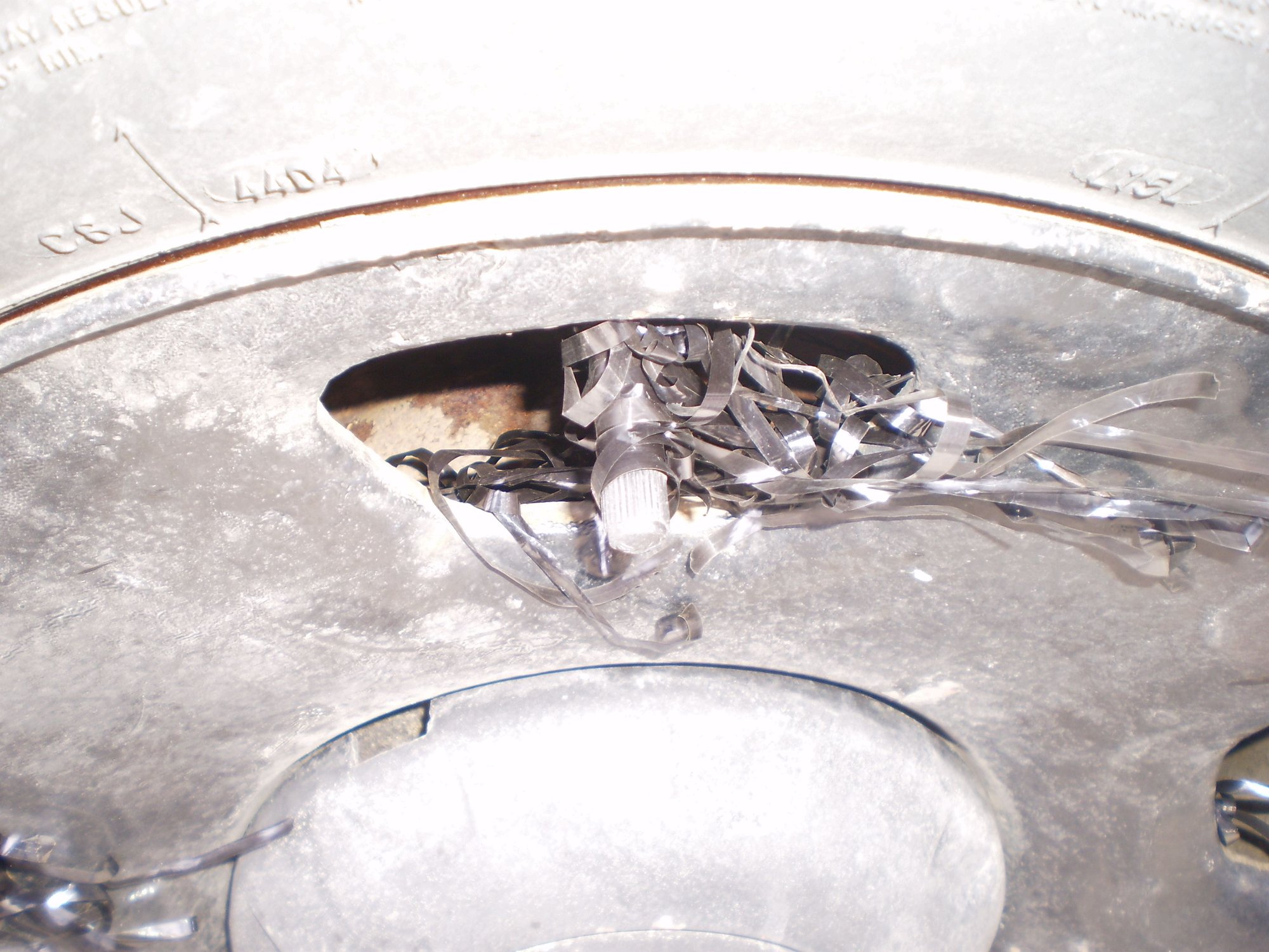

Haha. Did you run over a cassette tape? Also, that wheel has a ton of weights on it!
I guess it does haha, can't say I pay much attention to that stuff. I don't know how it got there, just noticed it in the mirror before getting out then went back and seen the whole picture. Wasn't too sure what to make of it it was hooked up in there pretty solid.

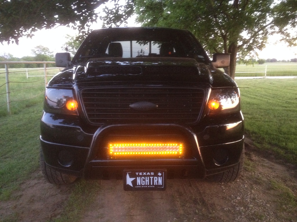

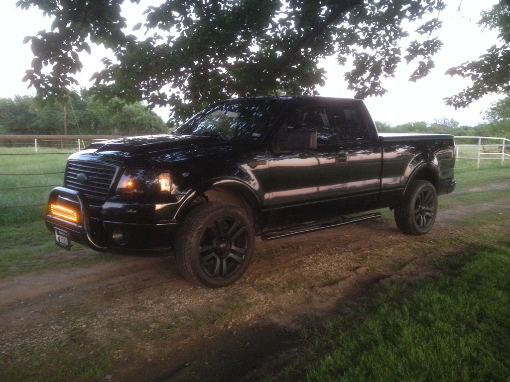

lightbar halo complete

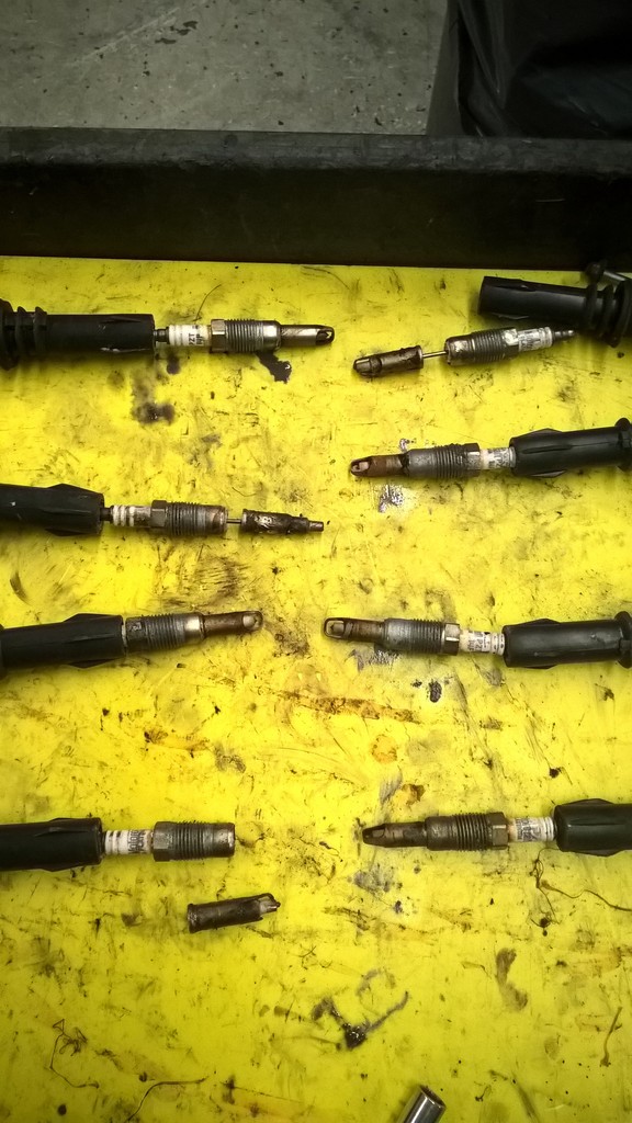

Did the dreaded plug change today, hoping this helps solve my stutter problem I'm having. Broke three plugs overall even though I put lots of anti-seize on them last time. Luckily I had the lisle tool on standby, first time using it but after it pulled the first plug out like a champ I powered through the rest.

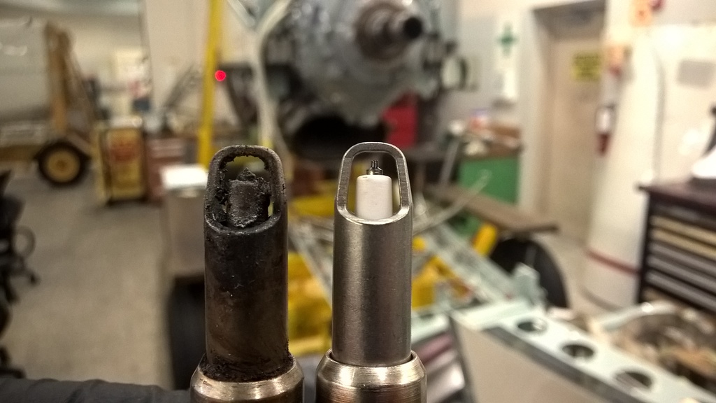

Well on my drive home with my custom tunes taken out and the truck returned to stock my stutter was gone! I couldn't get it to do it once! I still have 1/4 tank of 93 in it so when that runs out I'll put 87 back in and see if that makes a difference. Some of my plugs were definitely worn out.
Here is a used vs new:
It would also appear I may have some buildup in some of the cylinders. Any cleaning products that would help clean them out? I usually run Costco fuel which has lots of detergent additives or Chevron or Shell. It could indicate a bigger problem........piston rings. But I hope not!
