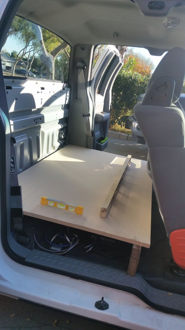

Somewhat Started on the box and center console today.

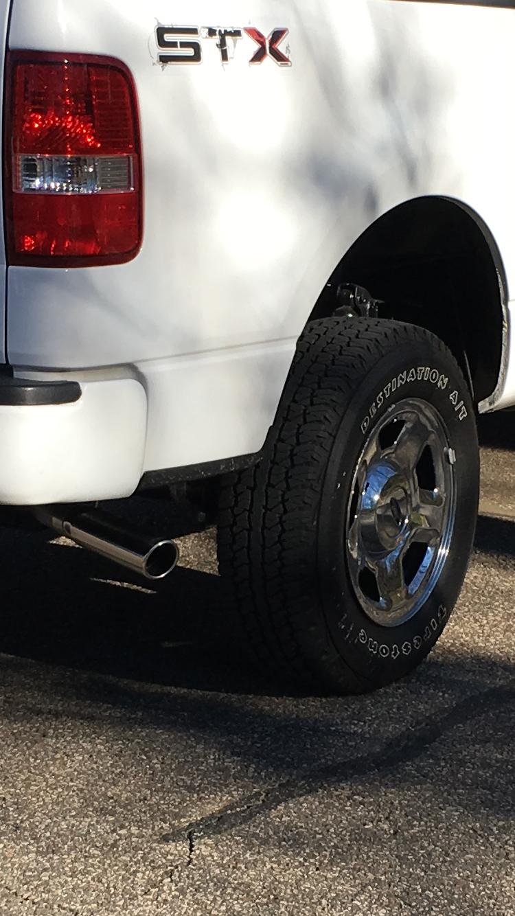

Added an exhaust tip to go with the chrome wheels and door levers. Going to put on some chrome nerf bar soon as well.
Tip was only 25$.

Tip look good!

Looks good!
I need to add one to my truck but want a black or black chrome.

Thanks guys!
The clamp on ones are super easy to instal. Took about a minute.

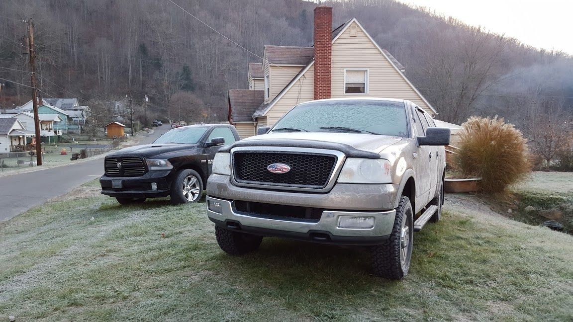

1500 mile round trip with my BIL to do some home repairs at our in-laws house in West Virginia.

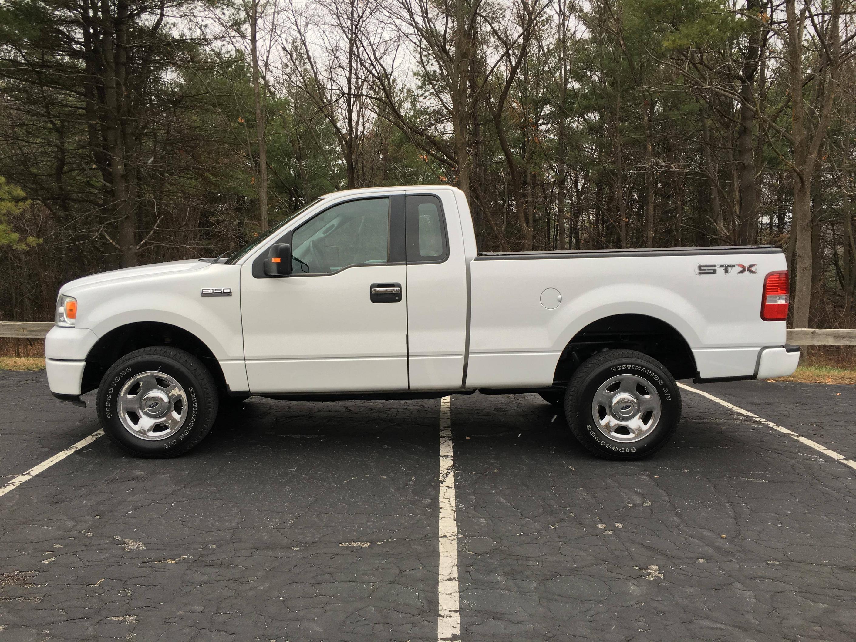

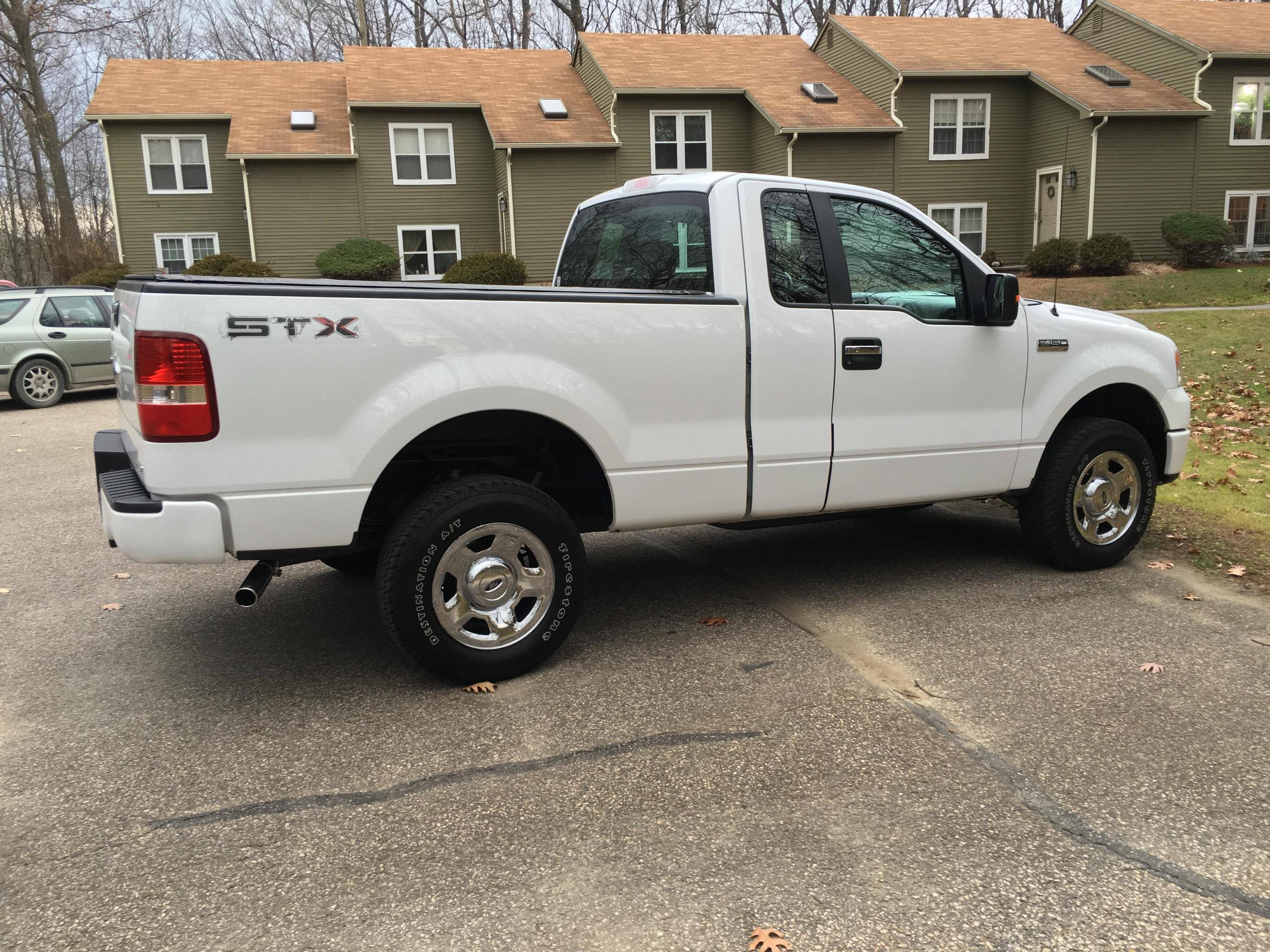

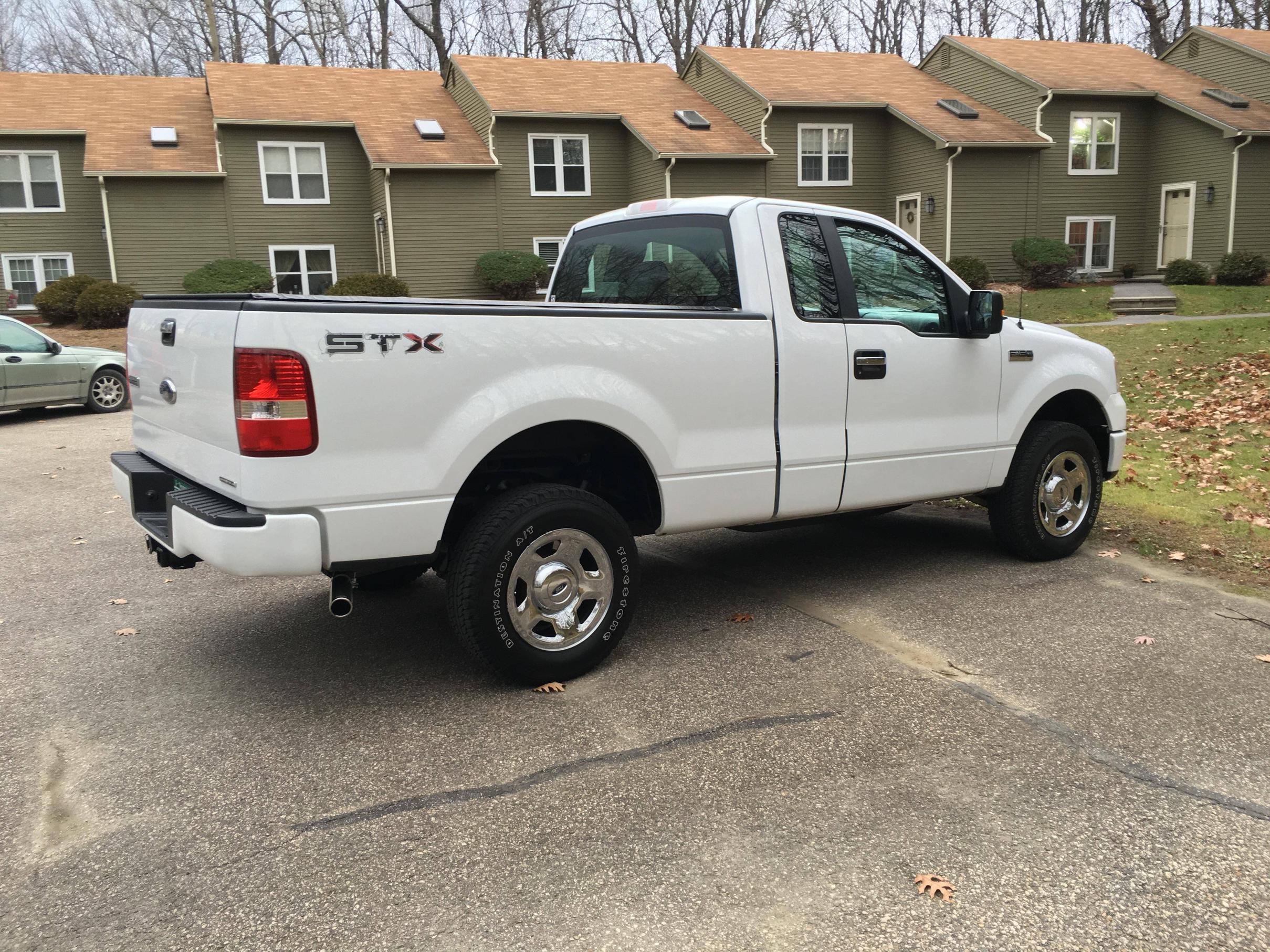

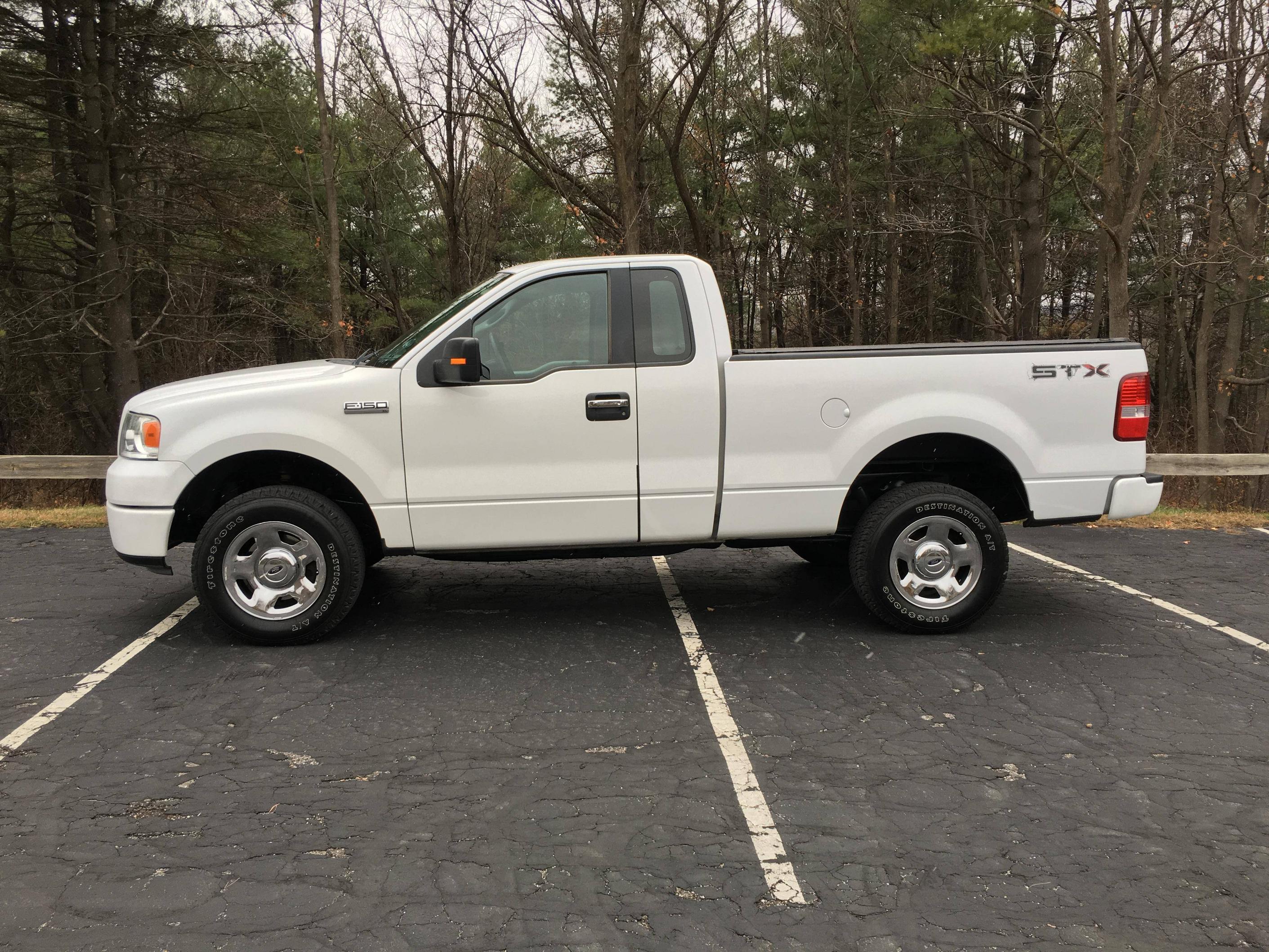

Probably the last detail of the season. But who knows, it's 60° today in Vermont and we have yet to see any snow.

Looking good!

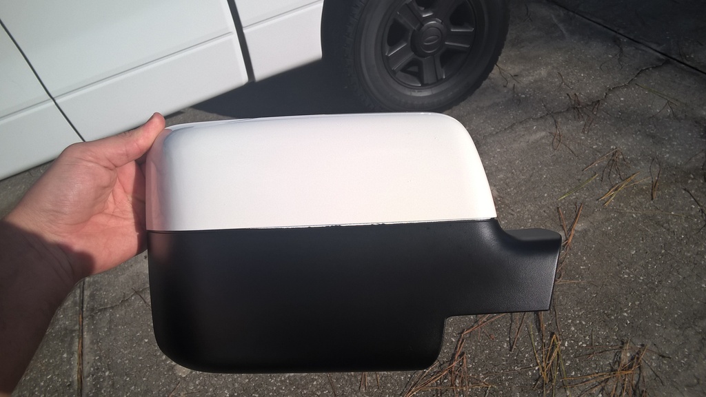

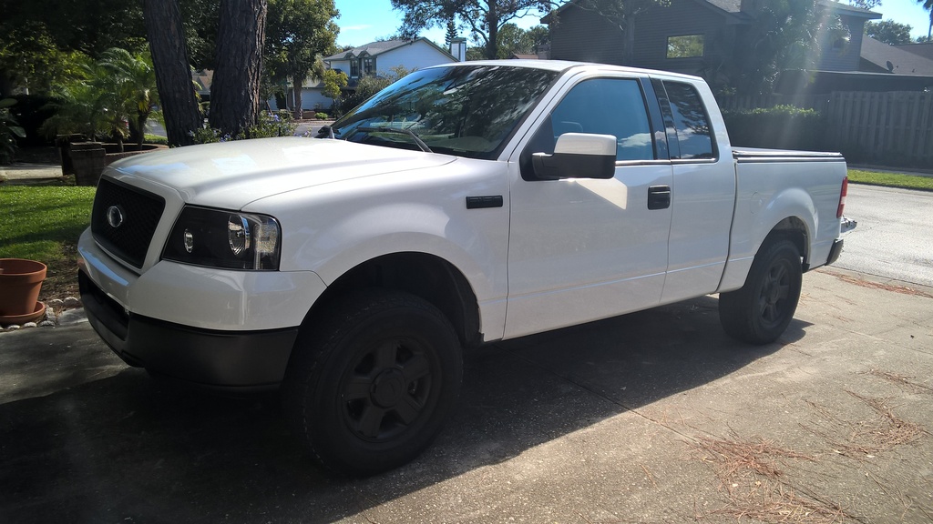

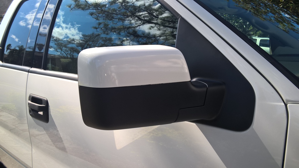

As promised, pics! I didn't bother to take progress pics.
The cap/front half whatever thing. Lo,

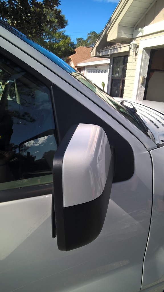

I removed the whole mirror to paint the rest. Pretty easy since I've taken my door panels off many times over the years.

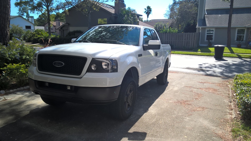

Looks great!
What headlights are those? I need to replace mine soon and considering the black housing.

Good job.
I take it you sanded smooth, primed, pained and clear coated? Did you use adhesion promoter? And did you have an actual spray gun or did you use rattle cans?

I sanded the texture off the white area only, left the texture on the black part because that is how it is on the factory trucks I looked at. The white part was cleaned well with isopropyl alcohol and sprayed with a gun with primer and then the white. The white paint is actually a special aircraft paint that has a gloss protective finish in the paint. Its very durable and matched nearly perfectly. The black is rattle can paint made for plastic and is flat black. Again cleaned with isopropyl alcohol before painted.
