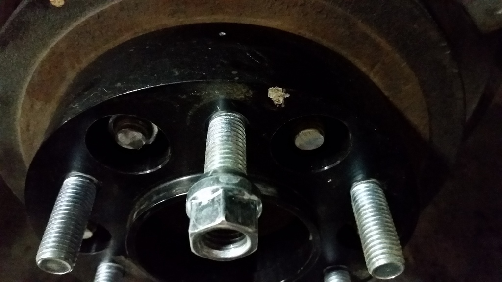

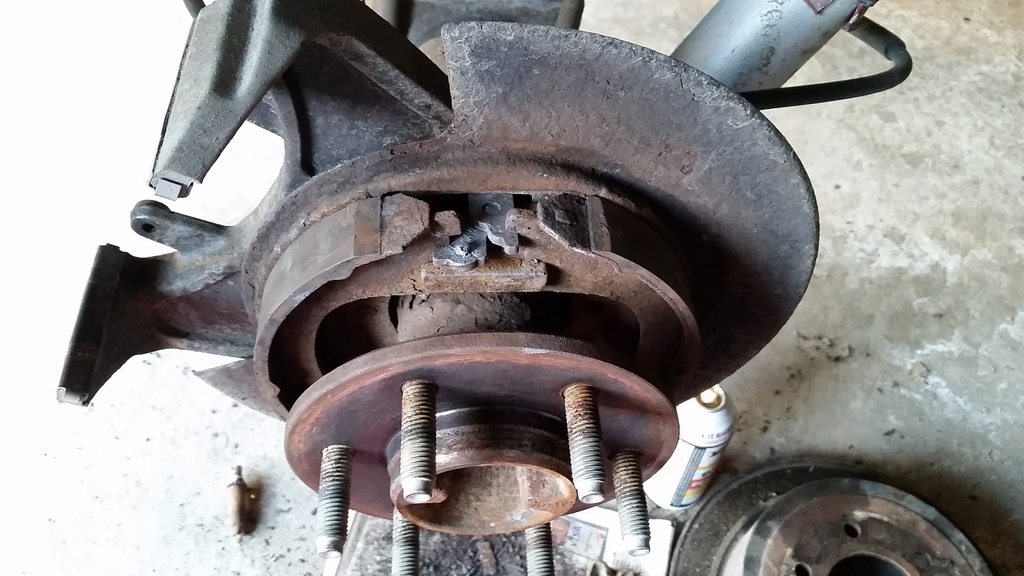

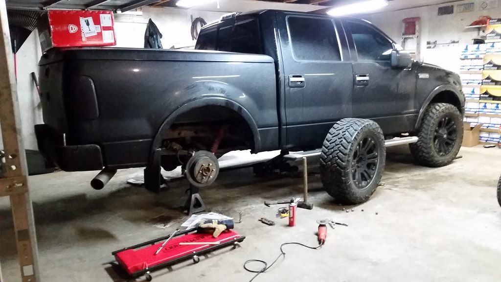

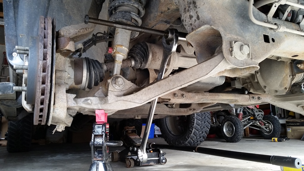

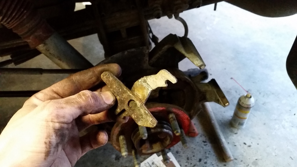

I've been busy with mine. For one, its filthy. I took it for inspection, and it failed. Aside of my front tire rub, it failed due to inoperable e-brake ( accuators seized ), and drivers outer tie rod & pass side inner tie rod were shot. Dealer quoted me over $450 in parts & alignment. Ordered Moog inner.outer tie rods all 4 for $122, and fixed the e-brake accuator myself. Took me 2 evenings for the e-brakes, and today I did the tie rods. The outer was very shot, I did notice the noise it made, but I can't believe how loose it was. It seems like literally one bad pothole would have finished it. The other 'ok' tie-rods felt loose in my hands also. The Moog replacements are firm and solid. Another reason to replace everything in pairs.
I also pulled the Bora wheel spacers for now, and I also took a grinder to the stud tips so that they were fully away from the XD wheels. They were touching it just a bit, and I wasn't comfortable with that. I am awaiting UPS delivery on the other outer tie rod estimated for delivery tomorrow. Till then its still on jack stands. Alignment this week, then inspection again.
Some pics.

The seized e-brake accuators. Sanded them and cleaned with CLR, then applied anti-seize.

Functional again.

A poor lighting photo of the studs cleared by the spacer. I left a couple millimeters of the 'tip' portion of the studs. No threads were removed from the studs.

I got the other tie rod end in tonight and re-assembled. Torqued everything to spec, and did my 'YouTube how-to viewer certified tech' alignment job to get the toe more leveled until I get it aligned properly soon.
