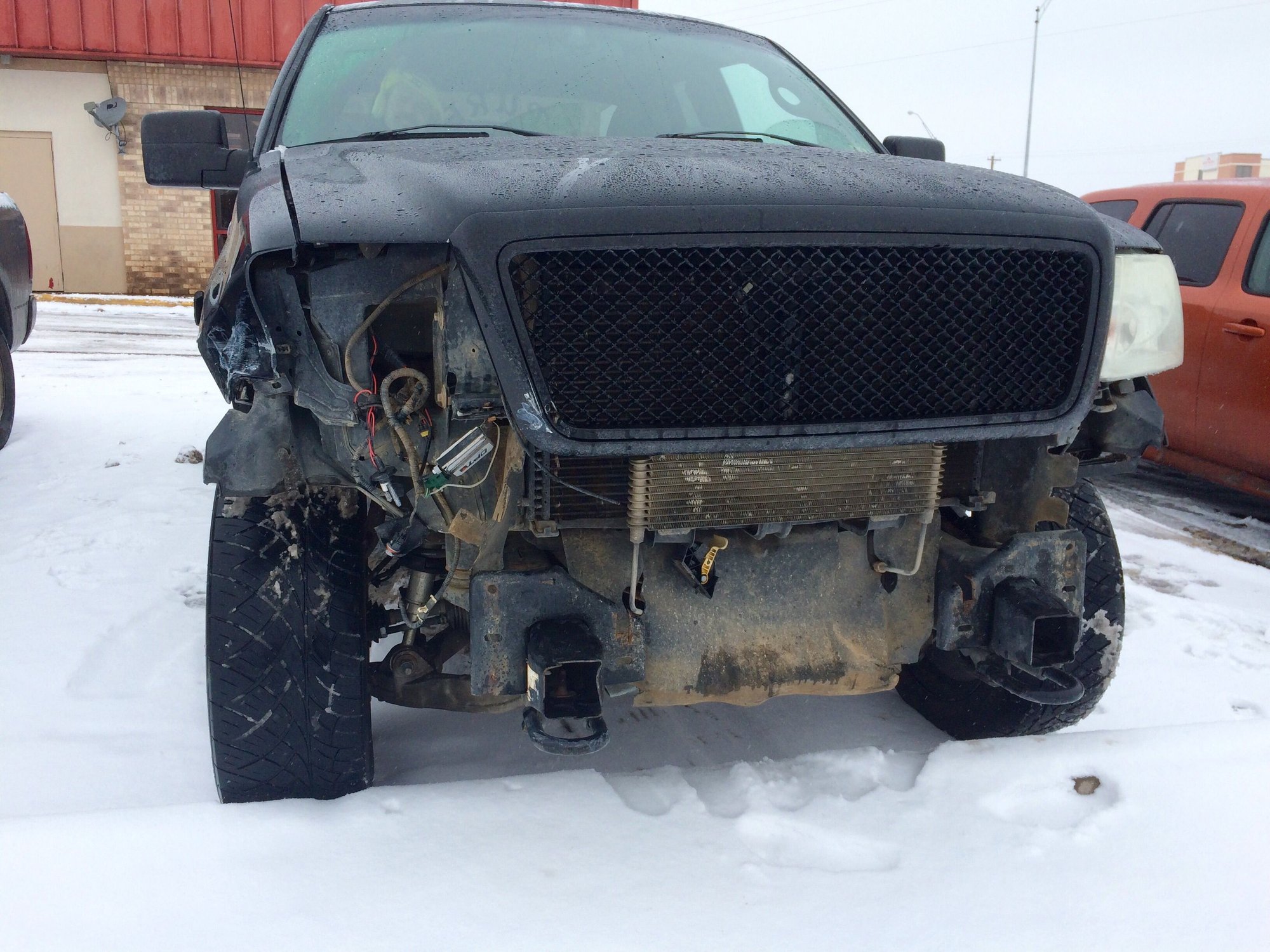

Here's the before....this is how I bought her almost a month ago....

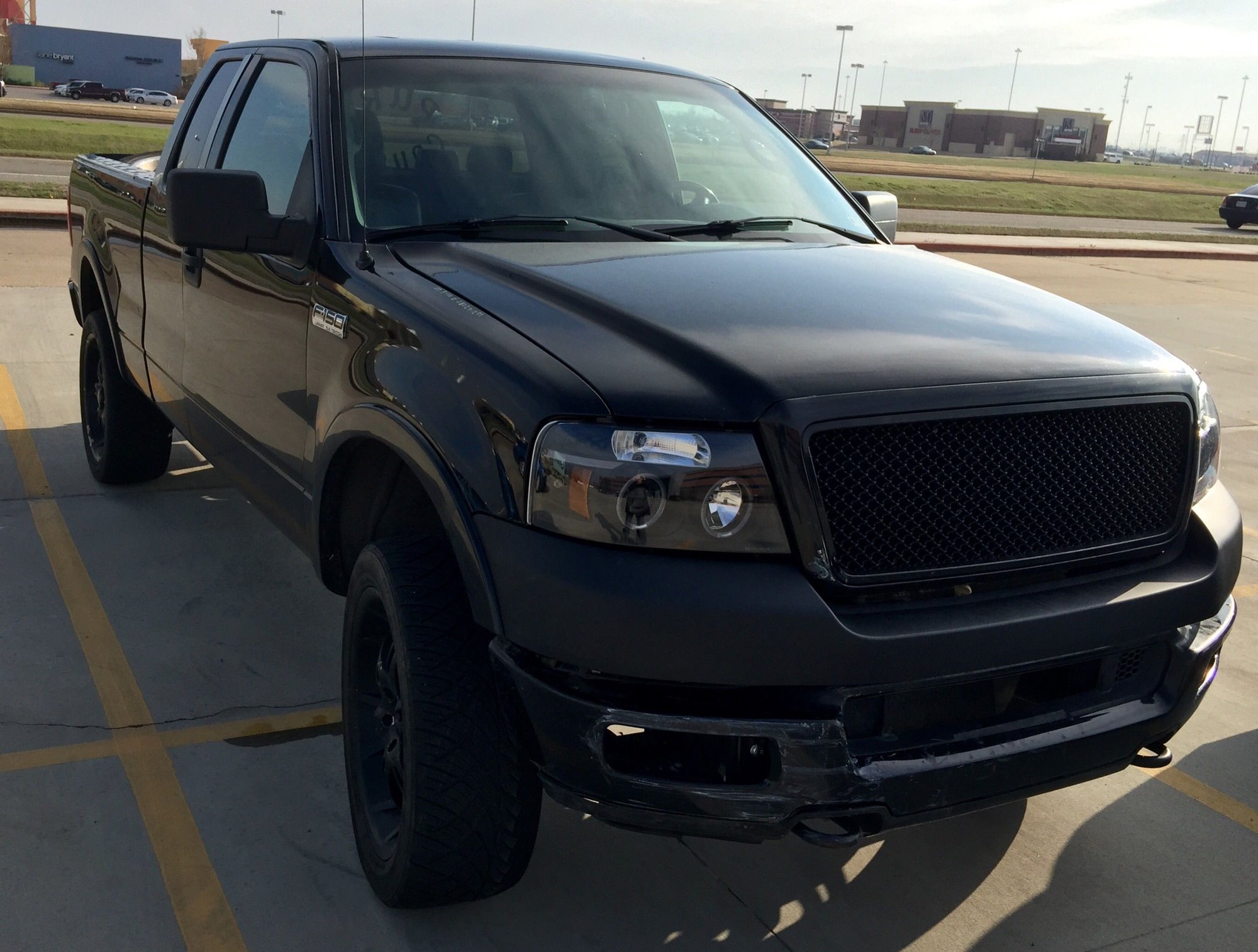

Here you go! Not perfect but definitely better than before!!! Not sure if I want it painted, it's got a better look like it is...but who knows!

It does look better than before. But what I meant, since it's the black textured type, it's not meant to be painted. The ones that are color matched for the trucks are smooth and come primed. Even if you smoothed it, I dunno that paint would stick. But hey, it's black anyway, so it's all good.
Is the bumper bent downward?

No it's not, I checked when I had it off. I looks likes it's not the right one to me. It's flush on the drivers side but lacking almost 3" from the edge of the cap on the passenger side. Definitely something not right. I'm going to tackle it this weekend sometime but I'll probably end up replacing the bumper.

With the rectangular fogs, it's definitely an 04-05 bumper, so it's the right one for the truck. You sure the brackets aren't bent or something? Something is way off cause the upper bumper and the bumper should be flush. Hope you get it sorted out and let us know what the problem is.

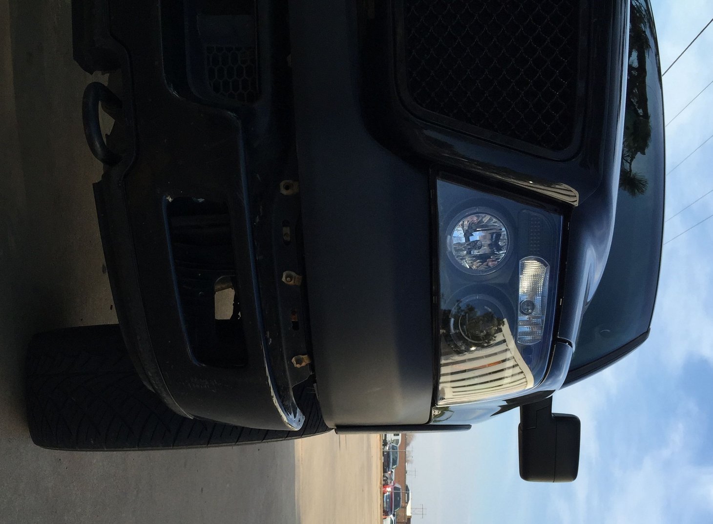

Yea, I looked at it and compared it to another bumper and I agree. When i looked at it last night and there's not any signs of bending in the metal but it's still not sitting right. There's rubbing on the passenger side and none on the drivers side. See below. I'll probably end up doing a swap. The guy at the parts place said the truck has had a major body lift....So, looks like I'll be taking it all apart to look at it this weekend.
Driver's side....

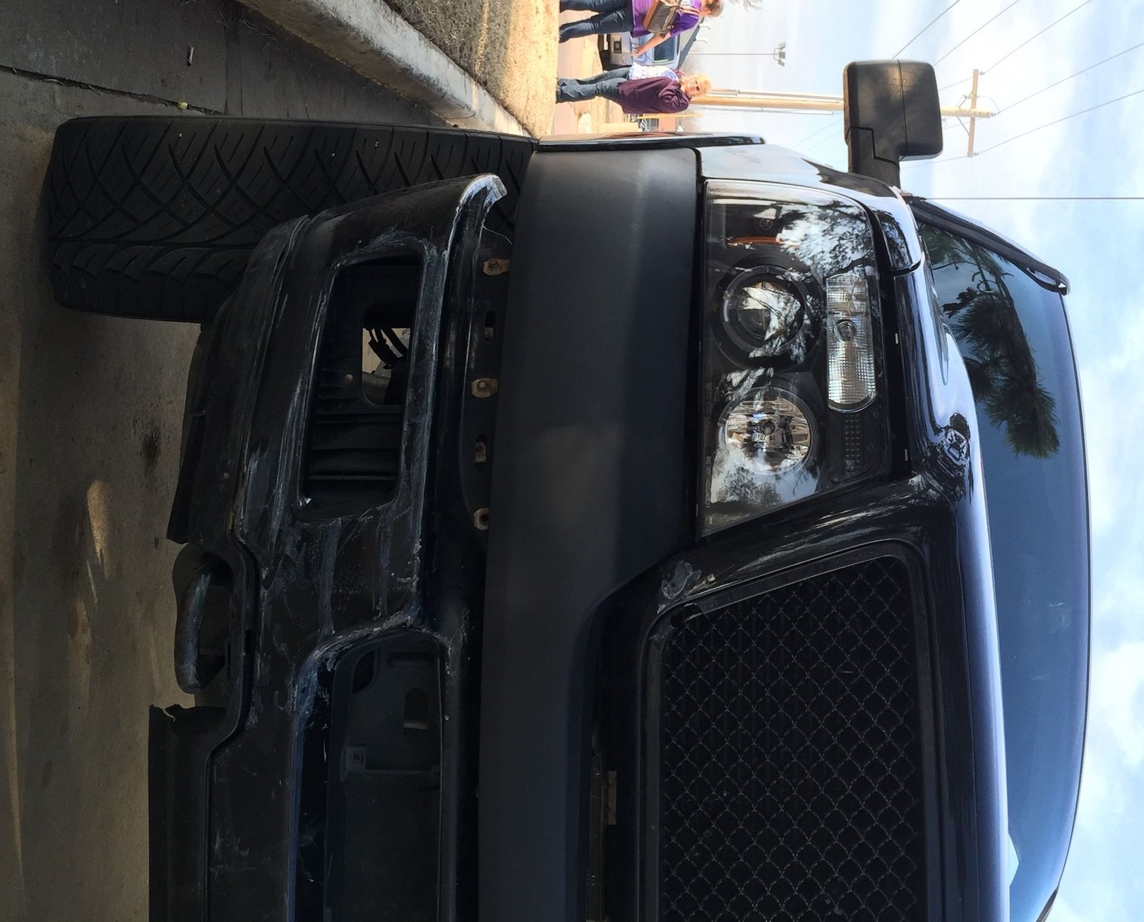

Passenger side....
With a swap trying to decide what direction to go with the bumper. I do like the stock bumper. I will be adding a Westin bull bar so....

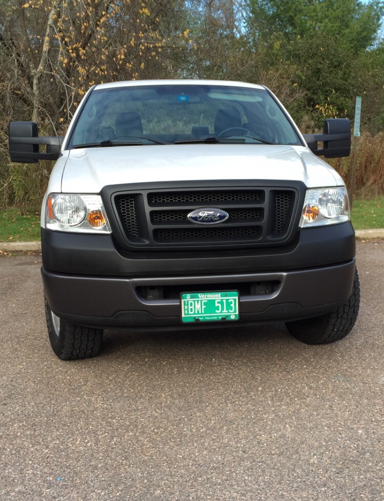

I agree, I don't think the actual bumper is bent, but I think either the bumpers mounting hardware or your frame is bent. It's sitting 2-3 inches lower than it should. The upper bumper also looks like it's sitting strange. There's a pretty decent gap between it and the grille. Honestly, just trying to help you get the front end back to normal. It's possible your upper bumper pad was for an 06-08 and not an 04-05? The front ends of these trucks changed for 2006. A lot of the parts are specific to either the first part of the generation or to the latter part of the generation.
Does the truck have fog lights? I see openings, but not see if they're missing or the bumper isn't original.
Hers a pic of the front of my truck, for reference so you can see how things are positioned.
