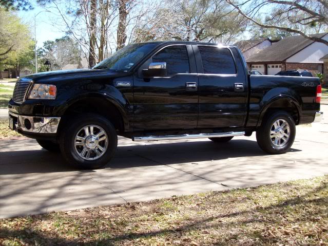

installed another AS 2.5" spacer on a forum member's Lariat 4x4
thanks again Ronnie!
