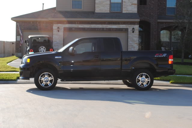

My two most recent...
2006

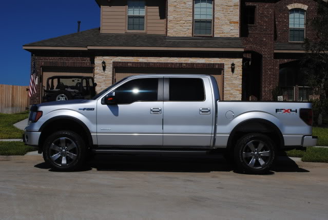

2011 (2009-2011 are a little different, but still super easy)

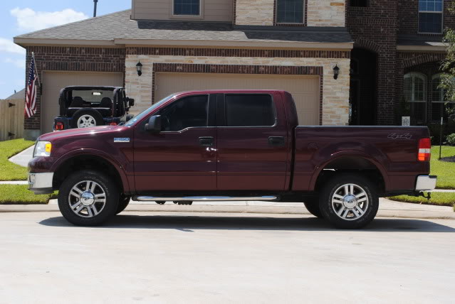

I did this 2007 FX2 2wd this afternoon. It got the AutoSpring 3" front spacers and 1.5" rear add-a-leafs.
This is a case where the customer wanted the truck higher (obviously), but not necessarily level. He hauls feed out on the family ranch and wanted the added height to the rear as well as the added weight capacity.
I was planning on doing a 2.5" w/AAL but now I'm not so sure. I definitely don't want that much rake. Would going with blocks be better?
Old Sep 27, 2011 | 04:25 PM
  #240
TXST8tj's Avatar
Joined: Aug 2006
Posts: 82
From: Katy, TX
That add-a-leaf is advertised as 1.5"-2" of lift. I didn't take any before pics, but it definitely raised it a good amount. It will settle though after some miles and especially after a couple hauls of feed and supplies that the truck sees.
If you don't need the added weight/carrying capacity, go with the lift block. The add-a-leaf is really only needed if you haul or tow a lot and need the added 950lbs of capacity.
Lift blocks will ride just like stock. Leafs can be slightly more stiff...at least until they break-in.
That truck would sit level with a 1" rear block....if I had to guess.
