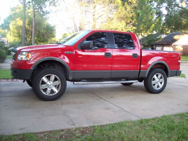

Installed another today. 2006 FX4 - 2.5" Auto Spring.
Doing another AS 2.5" tomorrow.....txsaltwater - might be yours actually.
I'm going to be doing another Rough Country 2.5" full kit (2.5" strut spacers and 1" rear blocks) on my buddy's 2wd here pretty soon.

This is really an incredible write-up from beginning to end. I have a couple of questions:
1. ...and this has been asked before but not answered as far as I can tell. I realize that an alignment is required after installing the AS Level Kit. And I plan to get 35's on there at or near the same time. Would it be better to get the alignment before the tires (but after the AS Kit) or after both the Kit and the tires?
2. What is that makes the white Screw in post #162 look so weird? When the Screw and Scab in posts #172 and #152 looking SUPER BITCHIN'. As stated, they are all 2.5" kits. Did #152 and #172 get the rear lifted in addition? Has #162 just not been aligned yet?
If it helps get the answer, I have an '06 FX4 Screw...essentially the same as the truck in #172 just black.

definitely get the alignment before the tires. you don't want to slap $1000+ worth of tires on there and get side-tracked on getting the alignment done and wear them down....it can only take a couple hundred miles.
the truck in #162 does have the 2.5" spacer, but it really should have the 2". adding a lift block to the rear would also be a good solution. for whatever reason, the rear on that truck is just lower than some.
the truck in #172 is a FX4 and the 2.5" spacer got it level front to rear.
i'm not sure if it is a difference between the standard 4x4 package vs the FX4 4x4 package or not. it just goes to show you that not all trucks are equal, regardless that they may be the same trim package.
