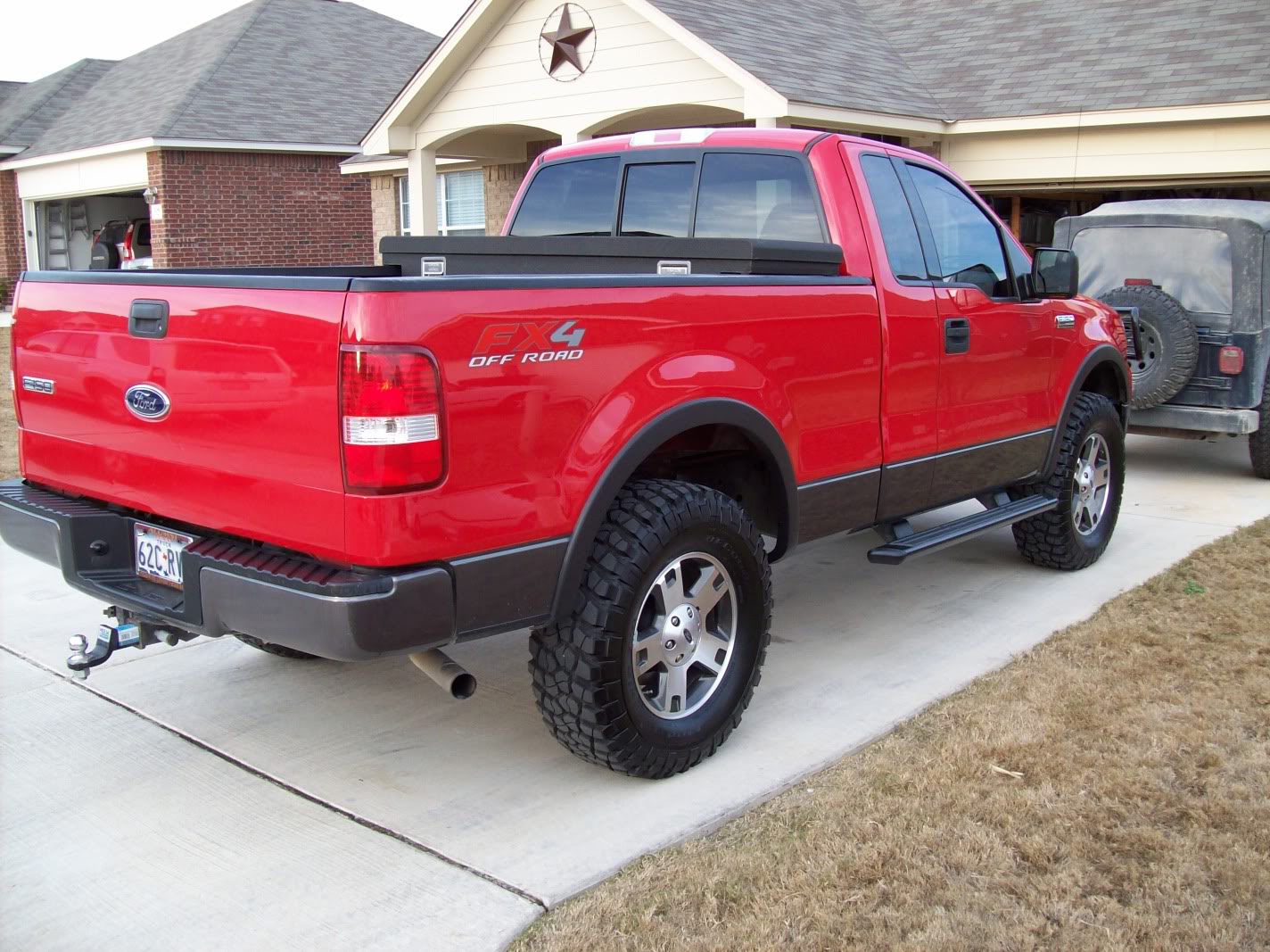

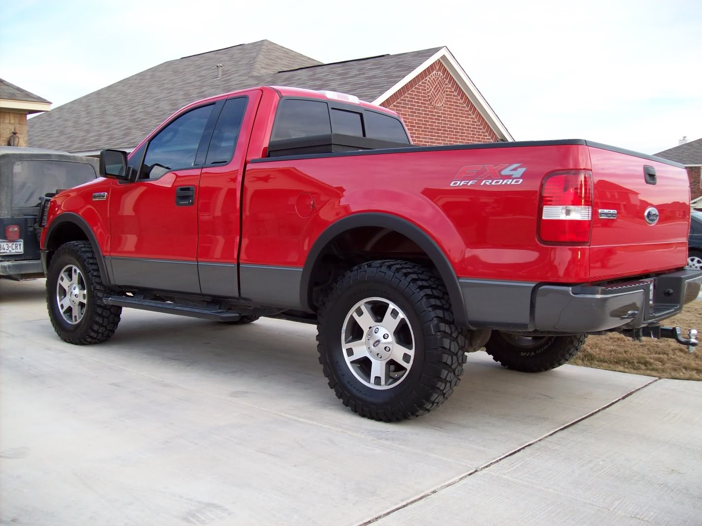

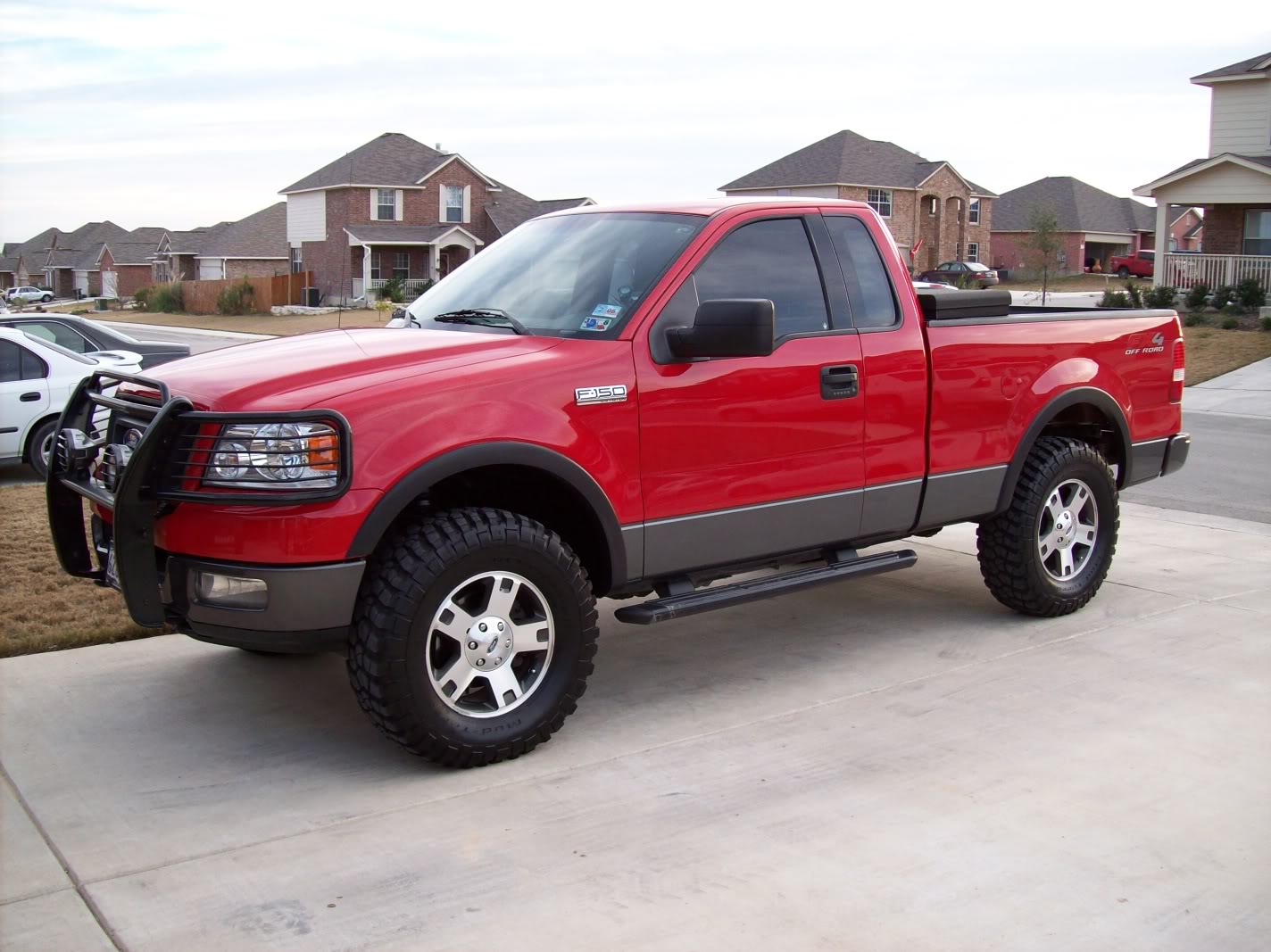

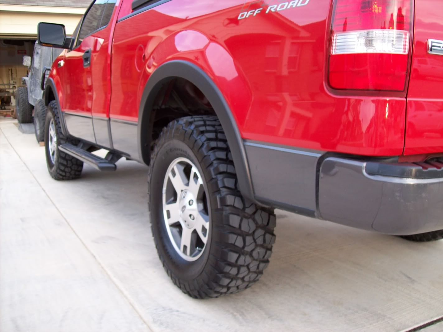

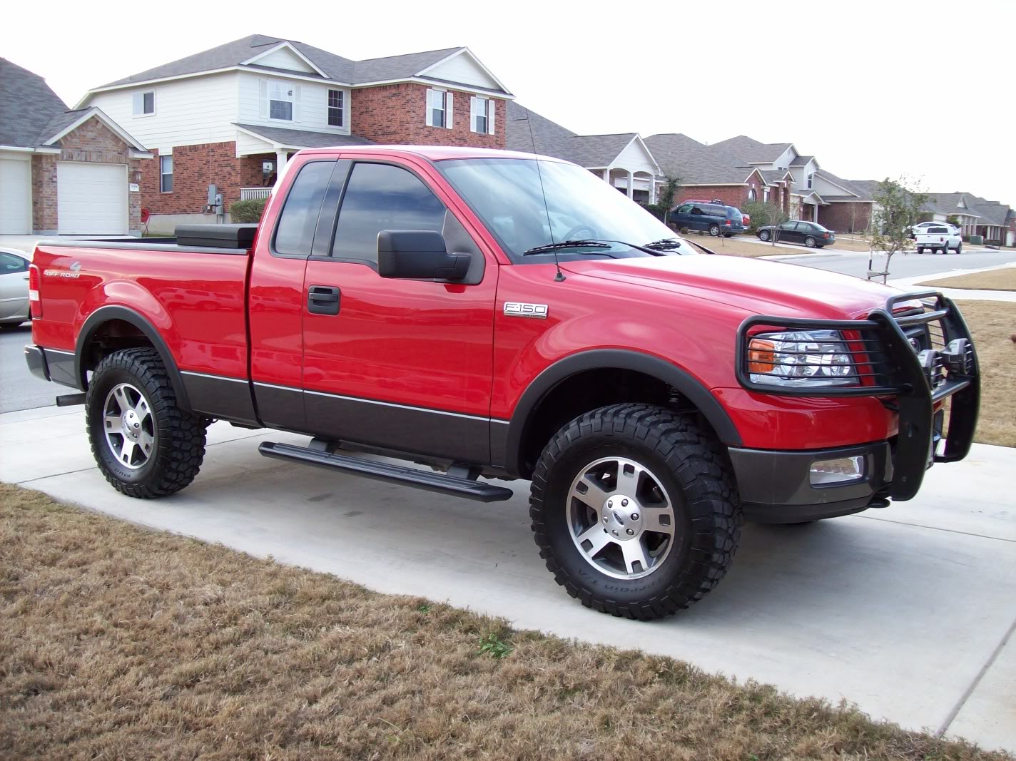

it doesn't look like i ever posted updated/better pictures with the tires. he hasn't gotten the rims yet (chrome KMC Diesels), but is soon to do the exhaust.

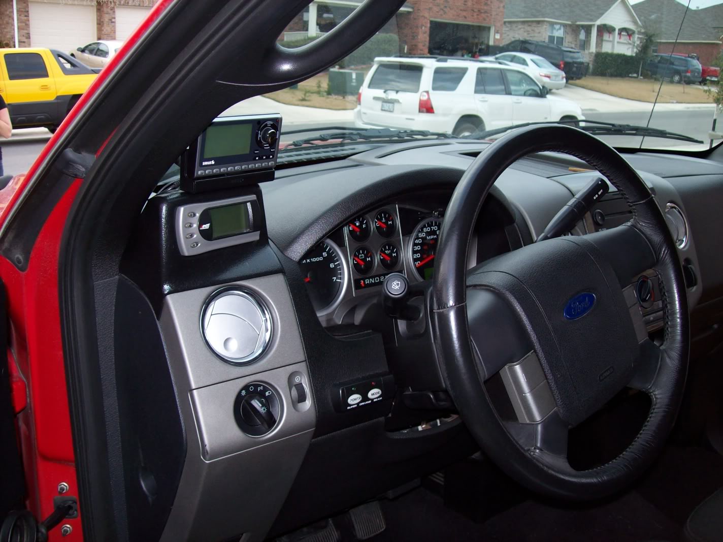

and one of the Edge Evolution programmer and Sirus

I love them tires! I need to get me some mud terrains one of these days. I think I understand now. In the blurry picture I think I see why you loosen that bolt uner the ball joint. Its so the control arm can get low enough to be able to get the strut out and fit the spacer on top of it. I am right about this?

Man, those tires look good!!!!!!!!!!!!!!!!!

do you have any rubbing with those 35's ?
