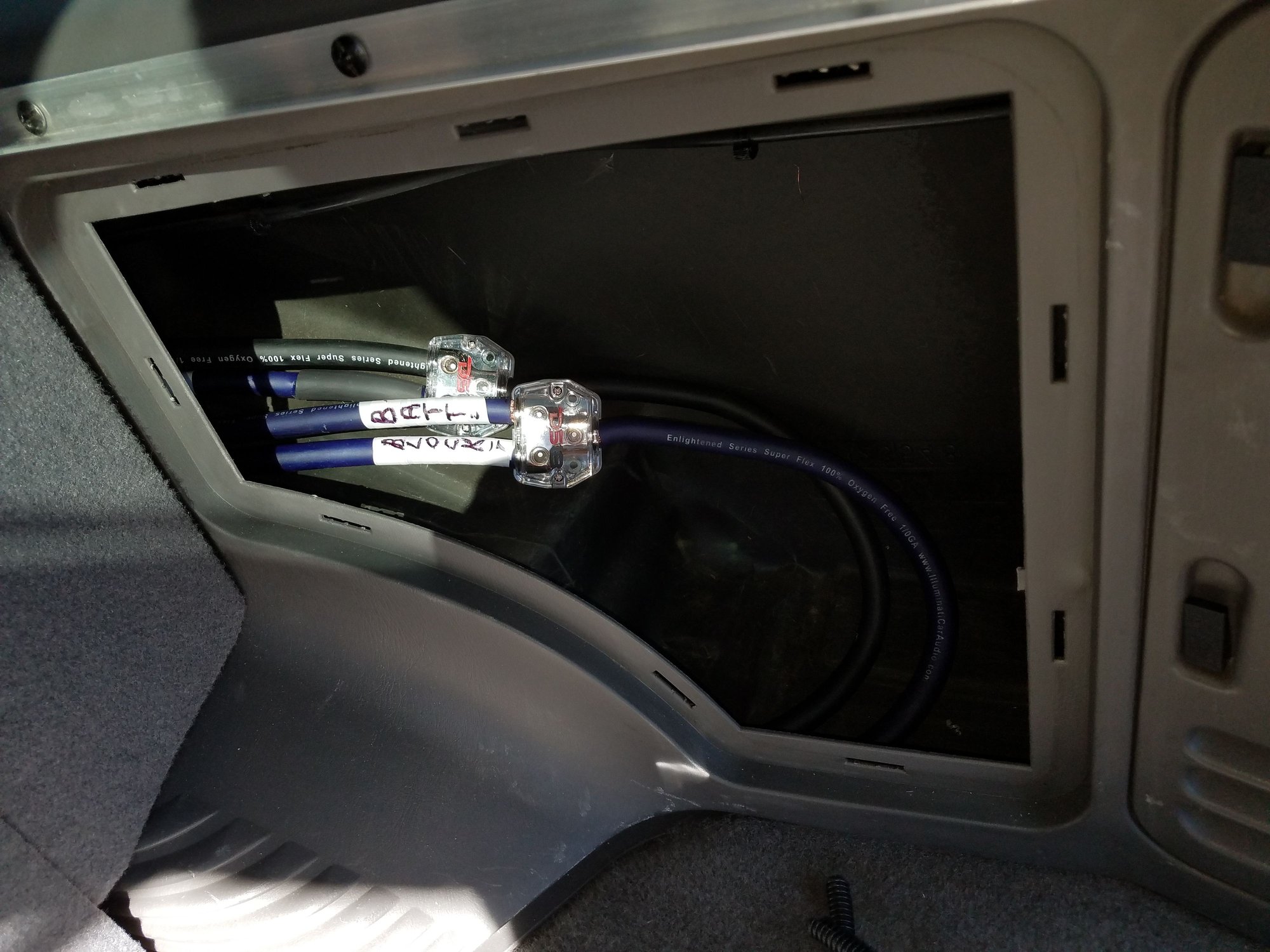

I ran the new 1/0 power and grounds. Big 3 are all 1/0 too. I also installed a 300 amp ANL fuse. I need to get out there and get more picks.
The weather has been kinda ****ty. I ran all all new 14 awg speaker wires to the doors. I still need to run the 4 channel RCA's for mids and highs.
Once I get that done I will start on the box for 2 x 12's and extra set of rear kicker KS 6.5's. I just scored on a couple of amps. I've never used this
brand but Big Dwiz and a few others have given these amps 2 thumbs up so I'm gonna give them a shot.

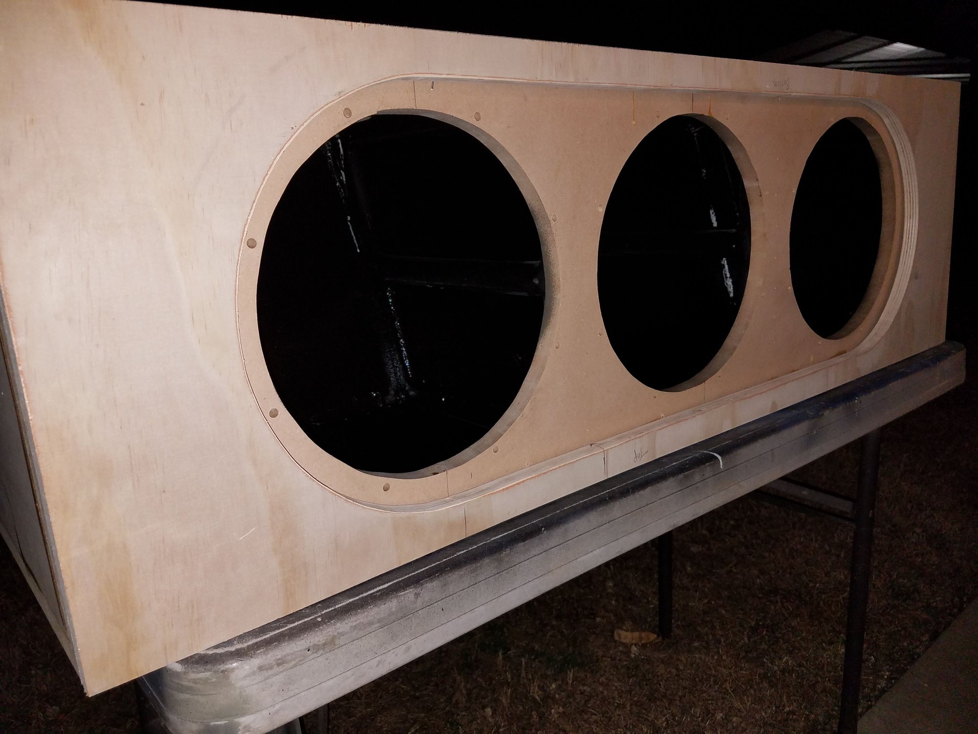

I haven't heard it yet. The box is almost done. Once I get everything ready the amps will mount on the box with dampeners. I drilled all the
speaker mounting holes and installed t-nuts and I'll be using security type screws. The box will be mounted to the floor from the inside.
The amps and all of the speakers will be mounted with security type screws too. I will also be building a cargo cover for the rear too.
It should look pretty good when I'm done.
The recessed area is where the amps will go.

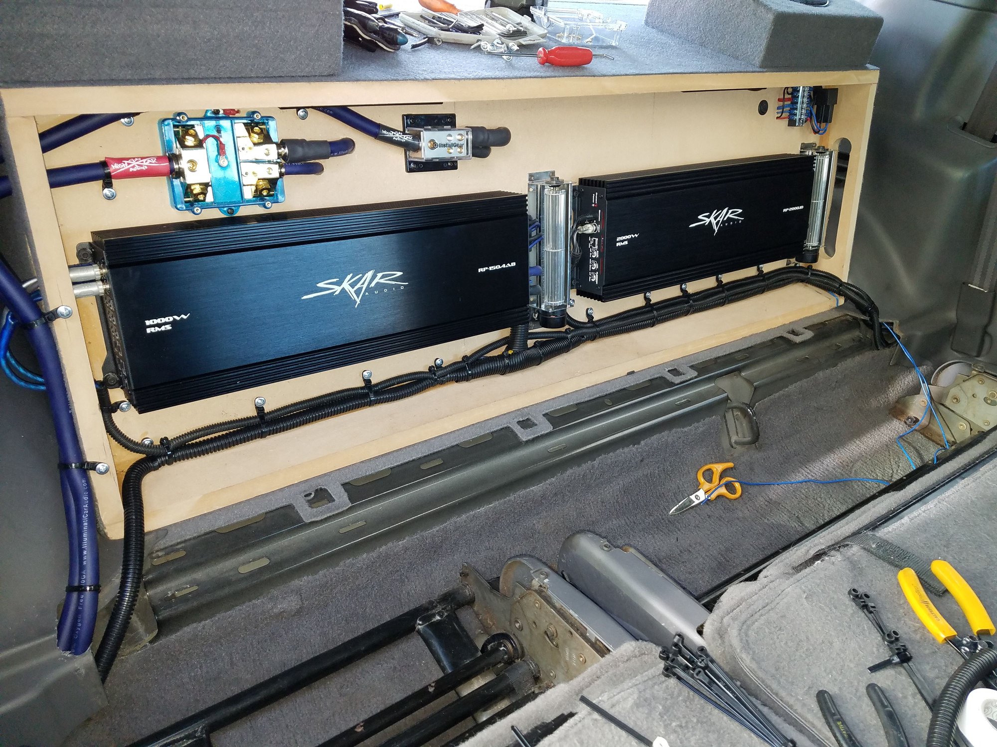

I got done with the rear speaker pods and also got the rear tonneau type cover made for the back. I took lots of pics
to show how. I used 1/4 x 20 blind nuts to mount the aluminum angle brackets to the plastic panels. Lightweight
Plywood for the cover itself and grey carpet from O'reillys and glued it down with 3M 90 strength spray contact cement.
The panels that make up the rear cover are removable to allow for transporting bigger items. This is a work in progress
and make adjustments as needed to improve my original design. I did all of this out of my head. I've never seen anyone
ever do any of this. I address each problem as they come up. So far so good. I'm considering making a brace under the
cover to keep it from sagging. It will depend on how the plywood responds to hot and cold weather.

I got a bunch more done!
Power cell location prewired and ready to go.

I'm pretty close to finishing things up. The Mid's and high's amp went into protect mode and before that it had a soft start and off popping / thump sound.
Skar customer service sent me a UPS shipping label and requested I ohm'd out all 4 channels after the amp was removed. Each channel was fine.
They tested the amp and found the same issues I did and have sent me a new one. while waiting on that I got my windows tinted Limo mover factory in

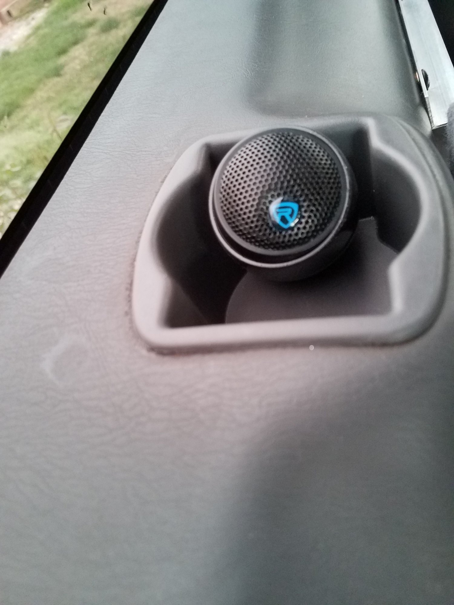

the back and the solid window on the back doors. I have always been a Polk DB series and Kicker subs person but watched some videos on
Rockville. I needed a few more silk dome tweeters to finish things up and thought I'd give them a shot. They sounded decent the short time before
the amp had issues. I've also heard great things about the K9 series subs. If I smoke any subs I may give them a try. I installed the rear tweeters in the
the 3rd row cup holders because they won't be used for anything anymore.
