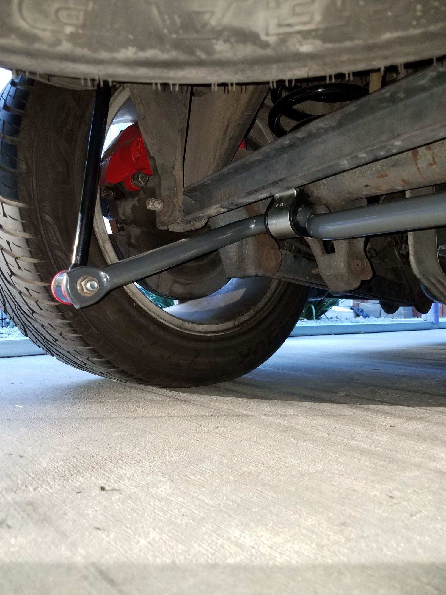

Well, a couple of weeks ago I scored on Belltech Swaybars front and rear. The front is 1 3/8 and the rear is 1 1/4. I got them for 200 bucks and couldn't resist, Normal price is somewhere between 350 and 400. The front swaybar was pretty straight forward with the exception of the endlinks. I cut down the sleeve to 2 3/4 and used a 1 1/2 shorter bolt.
This is what the original Rear swaybar looked like before my Mods and upgraded swaybar.
The rear swaybar had another issue. It is lowered 4 inches and the factory track bar mount on the frame side was in the way of getting the swaybar to sit parallel to the ground. I contacted Belltech and a number of other sources and no one had a fix, bracket, nothing. After a few ****tails and laying there staring at it, I came up with a solution. The factory track bar mount had some extra flat area above the mounting bolt. I drilled a new 5/8 hole 1 1/4 inches on center above the OE hole. I then cut off the excess bracket below it and walla. Now for the endlinks. I cut out 2 3/4 inches and threaded the 2 pieces the used a jamb nut and a coupler nut to make the overall length 12 1/8 on center. Now I have adjustable endlinks and It didn't cost a 150 bucks either.
