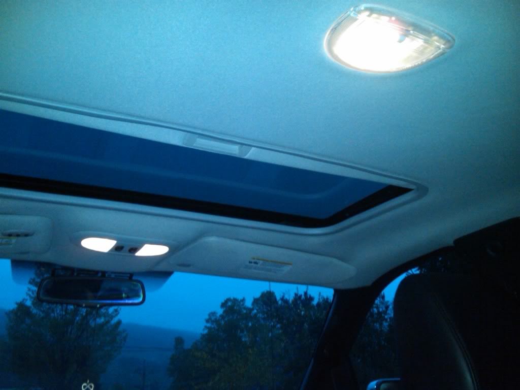

Reviving the ole LED thread. I bought a newer truck, '07 Supercrew Lariat. I have the moon roof so I do not have the overhead console, just the two tiny light boxes. I also have the lighted mirror visors. What LEDs do you Lariat guys have in them? What will I need? Trying to ask before I go out and take apart to measure bulbs.
I also plan to get V-LED bulbs only, and 5000k in color. Make me a shopping cart people!
Here is my roof for reference.

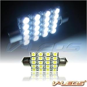

The Dome Light I purchased isn't available through them now. It was the 20 LED version.
This seems to be the new choice dome light.
Alternative Dome Light
V-LEDS Part ID: 211_4HP_W_6K
LINK

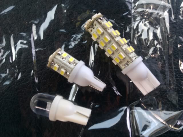

Got some LED's in from China a few weeks ago, thought I'd pass the low-down.
All sizes in the title have the same base fit so I'll call these, small, medium and large.

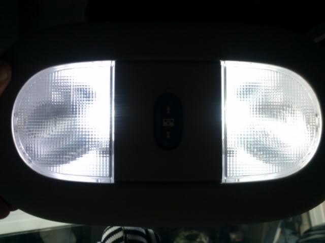

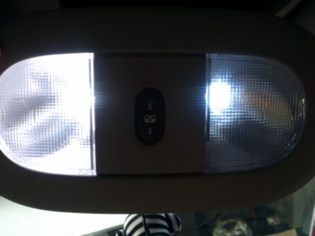

Map lights used 906's. Here's a pic with medium in the left and small in the right. I used the medium in the map lights.

This is with the medium left and large right side.

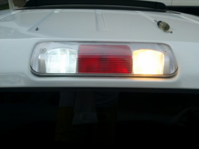

I put the large in the cargo lamps which called for a 921.

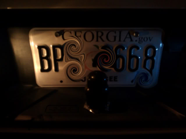

The map lights called for 194 where I used the small ones.
The bulbs are a cool white around 6500k. The cargo lights seem to be a bit dimmer at first, but still light up the area well. The small LED's as shown are really only good for the plate lights.

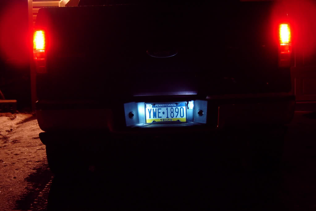

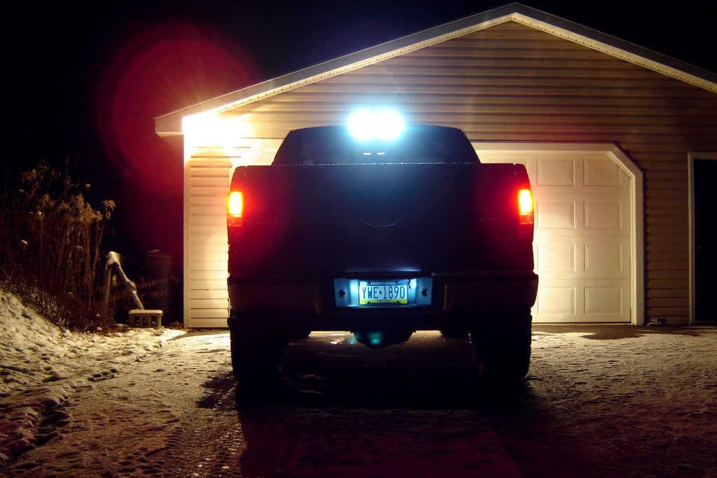

I see your economical point, but, to no offense, I wouldn't be able to see your plate number with those LEDs. V-LEDs costs some, but you get what you pay for in some circumstances. For example, my old truck..
