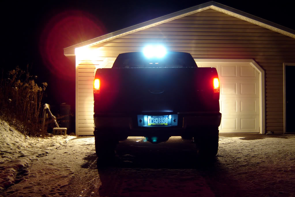

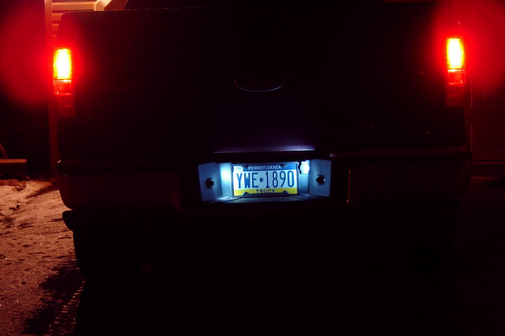

Old Nov 23, 2010 | 07:44 PM
  #567
Originally Posted by TN_SWAT
Seeing my LP lights glowing makes me feel better though
Me too, mine glow, very well..
