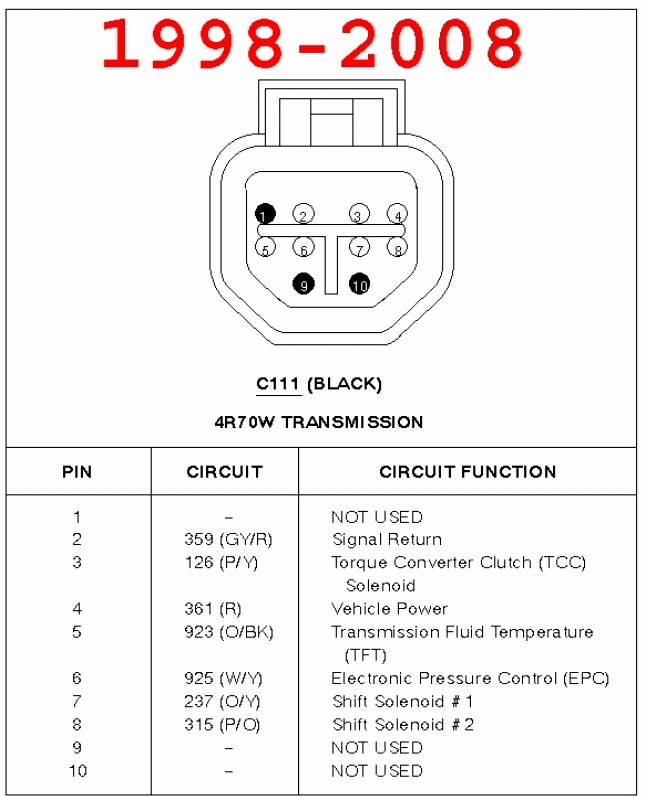

Need to know how to repin harness to make 1999 4R70W work in a 1997 truck

Help
Originally Posted by Darrin Burch
The electrical connector onthe truck will plug into the transmission but it won't work because the newer transmission is wired differently. I have details on how to repin the harness if you need them.
Darrin
i need the to know the repin i bought a 97 4r70w for my 2000 f150 before knowing that they didnt swap out

The repin info is a couple posts up, actually posted twice.

Repin
Originally Posted by Bindernut
The 97 4R70W uses the older pre-97 electronics connector but has the 4.6/5.4L bolt pattern.
In 98 and up to 2000, they switched the electrical connectors a bit but I'm pretty sure the internals should still be the same. After 98, they changed the VSS style, but if you've got a 4x4 that's in the transfer case anyway. After 2000, the electrical setup is a little different internally along with the connector...I'm pretty sure I seen a few posts here where someone did swap an 01-04 tranny into a 98 or 99 but I can't find the post at the moment.
So for a '97 it's pretty much a one-year only oddball. I found that out this past summer on my own truck.
I have a 2001 f150 with the 4r70w transmission. I bought another one from salvage yard and didn't check the year but the only difference between the two is mine has a black bulkhead connector and the other one has a white connector. Do I need to repin? And if so where is the correct pin configuration?

I need to repin info I put in my 1998 4.6 L V8 Ford F-150 Lariat I put a 2004 5.4 liter transmission on the 98th and it's not acting right please send me repin information if that's all it is
That's a lot more than a repin. In 2004 they changed the output speed sensor shaft.
