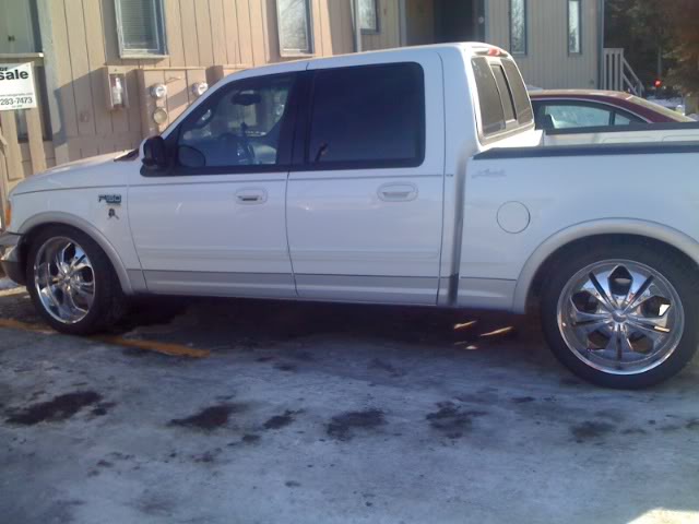

heres my 4x4 block removed, lightning leafs, 2" shackles out back and the t-bars fliped side to side and front to back with the stock keys and cut the bump stops out with i think 295/50/22 and no rub.

i heard of rangers doing that, wasn't too sure if the f150's were capable of doing that. looks awesome! and how much of a drop do you think you achieved in the front, doing that?

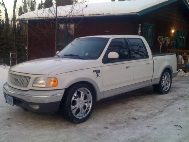

hay thanks man it all works great i dont now for sure how much drop i got but here is a pic from before Name:  ford3.jpg
That looks like a pretty big difference! and how far out is the bolt on the keys?
they are in perty far to get it the same as the back it can tuck the tires a little when they are let out more.

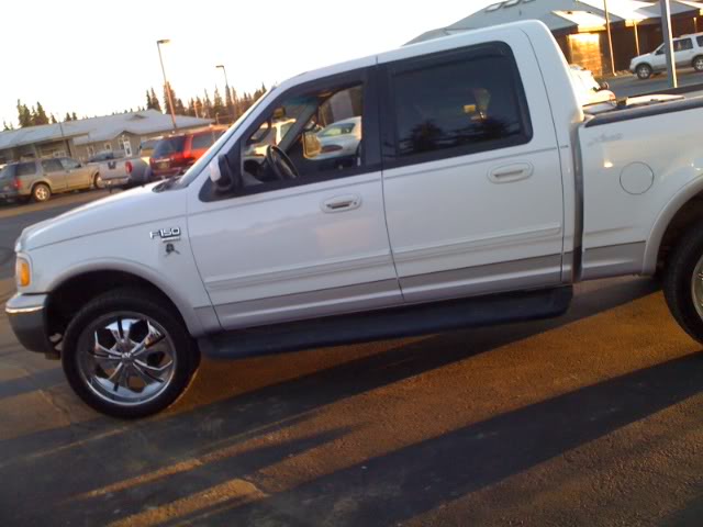

you can tuck in the front?
yea a little here it is not the best pic and i can go down a little more than that ill go down like that again when i get the back lowere to.Name:  ford4.jpg

coobies5's Avatar
Joined: Jan 2008
Posts: 2,934
From: Houston
how was your upper ball joint angles being that low?
