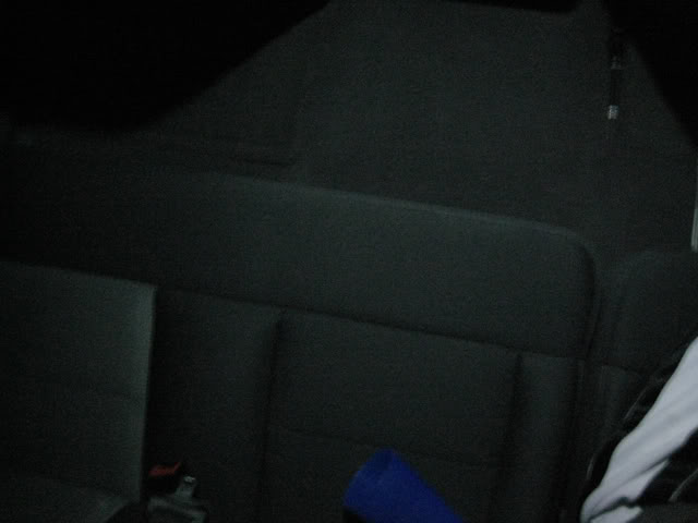

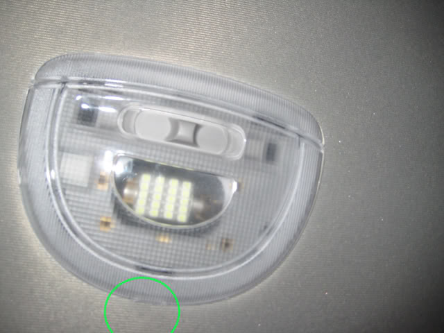

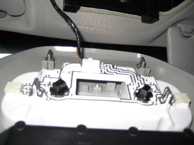

Map and Dome lights:
Step 1:
Take off the front cover by opening the overhead compartment and pulling down; however, do not pull too hard as there is a wire attached. Pull at points circled. And then detach wire.
Step 2:
Take off back cover by pulling at the point circle.
Step 3:
Take out old light and insert new LEDs. (If they do not work flip them 180 degrees.)
Step 4:
Put everything back together.
(Taken without flash.)

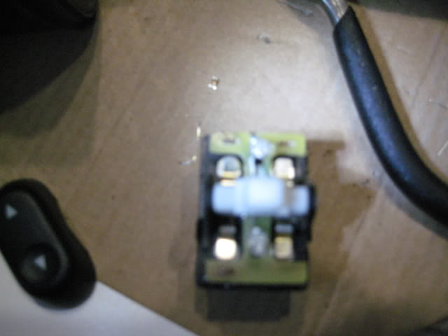

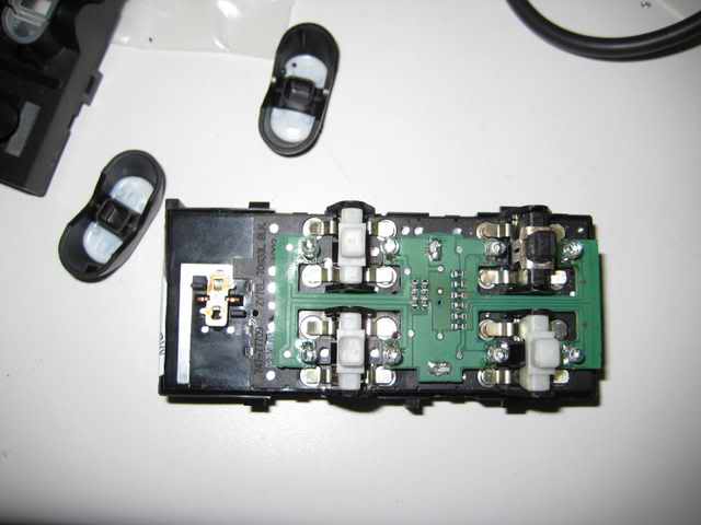

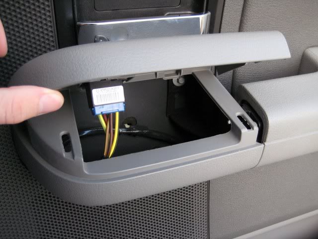

Door Switches beside driver’s side window switches:
(I would start with the switch used the least just in case you mess up and that way you can practice.)
Step 1:
Take off the armrest cover by pulling up in the corner. (It should pop right off.)
Step 2:
Disconnect the cables that are connected to the switches.

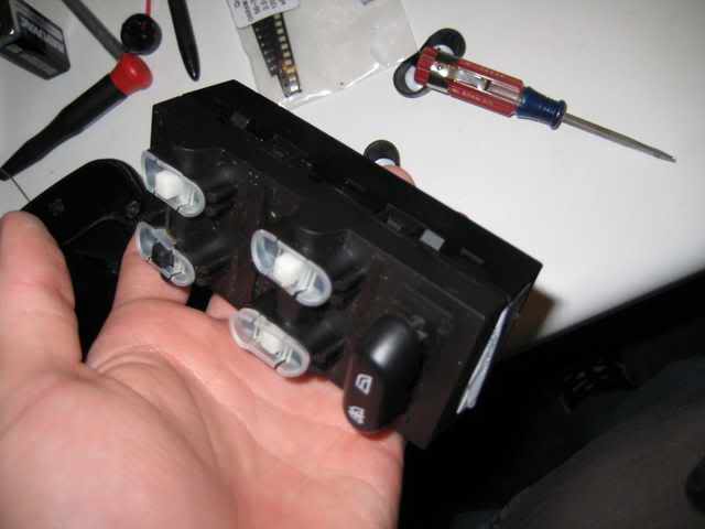

Step 3:
Take the switch out of the arm rest.
Step 4:
Take the part you would normally touch off the switch by just pulling.
Step 5:
Separate the top and bottom of the switch. Pull the white part afterwards.

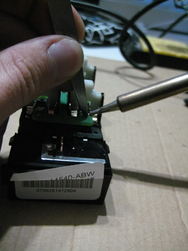

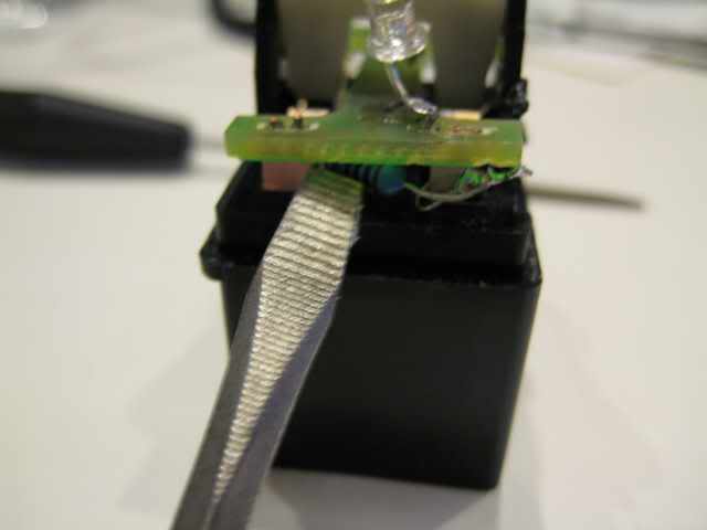

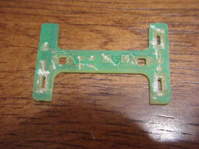

Step 6:
Pry the circuit board off with a flat head screwdriver.
Step 7:
De-solder all the things on the board. I don't have any pictures of this.
Step 8:
File the boards until there are no wires. Don’t worry about destroying the boards. (Should look like this when finished or be a yellowish color.)
Step 9:
Close the tabs with a pair of pliers. This is so you can put the circuit board back on later. I don't have any pictures of this.
Step 10:
Put the circuit board back onto the tabs. I don't have any pictures of this.

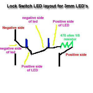

Step 11:

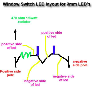

Wire up the LEDs using the following diagrams for window switches and unlock switches.
Step 12:
Make sure all LEDs are face up.
Step 13:
Go test the LEDs!!! Make sure they work.
Step 14:
Reassemble the switches.

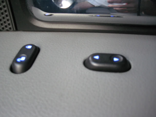

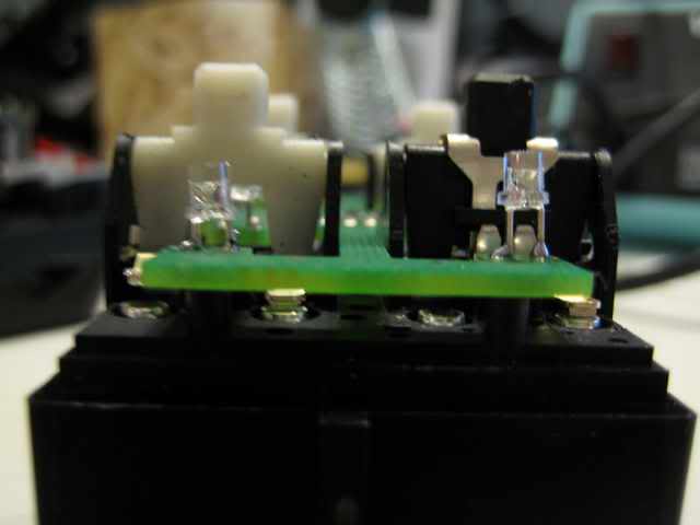

Driver’s side window switch with 3mm LEDs (I recommend doing it this way so your LEDs match better):
Step 1:
Take off the armrest cover by pulling up in the corner. (It should pop right off, if not use a tiny screwdriver in the corner.)
Step 2:
Step 3:
Step 4:
Take the part you would normally touch off the switch by just pulling. Don't pull off the window lock switch.
Step 5:
Step 6:
Cut the LED leads, remembering which side is positive, to about a quarter inch.
Step 7:
De-solder LEDs one at a time. (Circled)
Step 8:
Solder LEDs one at a time. Make sure you test for a good connection on each LED as they are wired in series.

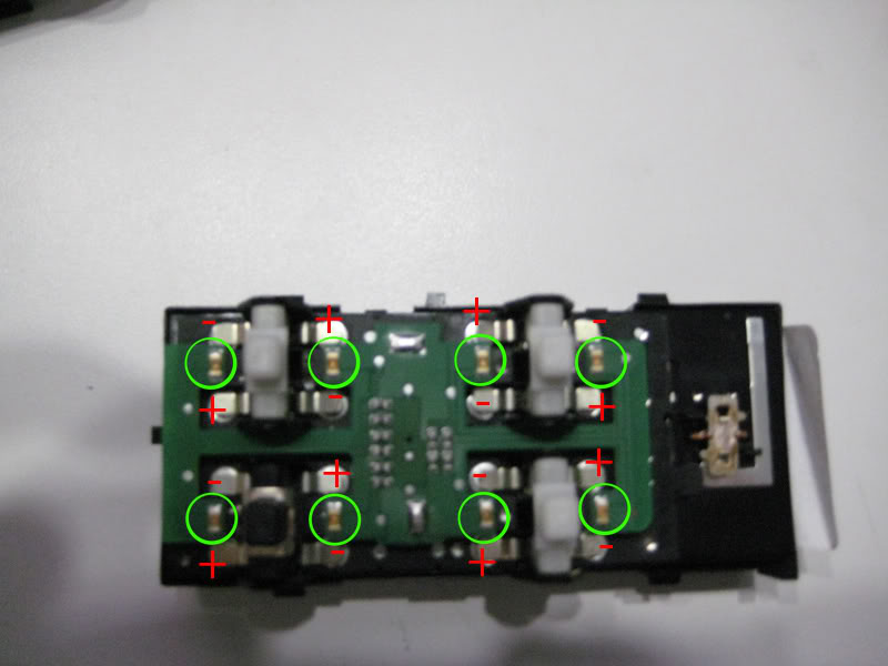

Driver’s side window switch with 1206 LEDs:
Step 1:
Step 2:
Step 3:
Step 4:
Step 5:
Step 6:
De-solder each individual LED. (Circled)

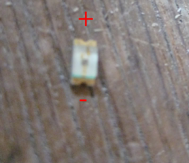

*Test each LED after you solder it on for this step because all beside the driver’s window is wired in parallel, so when one is out both for that window go out. So if you do not test after each LED you will not be sure which LED is out if you do not solder correctly.*
Step 7:
Solder the LEDs back on using the following technique. Use the last picture for positive and negative sides of LEDs. (As seen in the last picture the driver’s window switch isn’t the same as the others so keep this in mind.) (Next picture will show polarity of the LEDs.)
*On my LEDs there was a green line on the negative side. And also there were two wires on the positive side. This was on mine and I am not sure about all LEDs so make sure to test yours.*
Step 8:
Reassemble Switch.

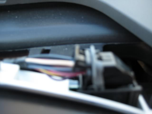

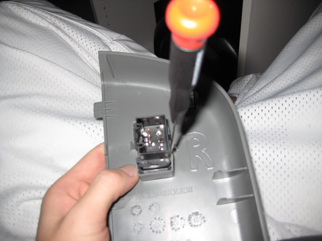

Reverse sensor switch:

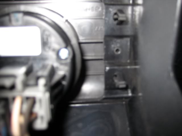

Step 1:
Take off bezel around the radio being careful of the cords behind it. You will have to disconnect the cords in order to fully remove the bezel. Make sure you get the airbag one as this one is the most delicate.
Airbag plug.
Step 2:
While compressing the tabs on the switch push out of the bezel.
Step 3:
Pull top portion of the switch off. This will expose 2 LEDs.
Step 4:
Cut the green LED’s wires close to the LED itself. This will make soldering the new one a lot easier.
Step 5:
Solder using the following for polarity. I put in a resistor, I’m not sure if this is necessary but I figured since the one I was putting blow when I attached it to a 9V battery and the one out of the truck did not I took the safer choice.
Step 6:
Go test the LED. Press the switch a lot and make sure it doesn’t affect the movement of the switch; I had to file part of my switch to get it to work perfectly.
Step 7:
Put the switch back into the bezel.

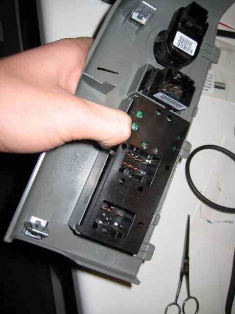

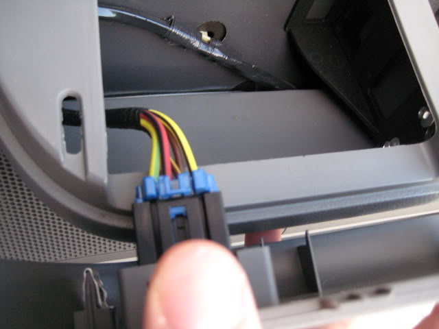

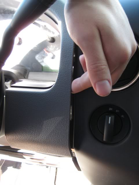

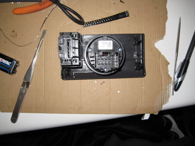

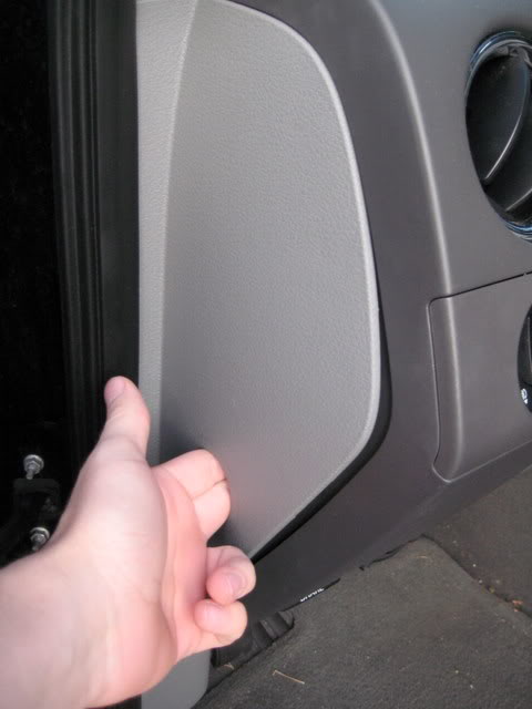

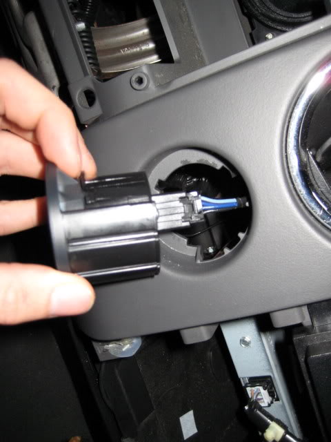

Headlamp switch:
Step 1:
Remove the side panel by inserting a finger or into the hole on the side and pulling.
Step 2:
Find clip on the headlight switch. And squeeze, I used a pair of pliers because it was freezing outside and were very difficult to compress.
Step 3:
Disconnect the headlight switch and the dimmer.
Step 4:
Remove the screws on the back of the headlight switch.
Step 5:
*I would go test after every LED, just in case.
De-solder and solder the circled LEDs. Follow picture for polarity. Or just have the "cut" part of the LED in the same place.
Step 6:
If you have not been testing all along, test.
Step 7:
Reassemble.

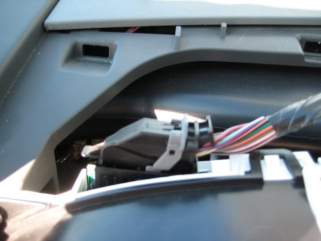

4WD Switch:
Step 1:
Step2:
Compress the tabs on the side of the switch, slide out.
Step 3:
Take the screw out of the back.
Step 4:
De-solder and solder the circled LEDs. Test after each.
Step 5:
Reassemble.

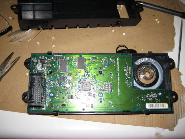

AC controls:
Step 1:
Step 2:
Use torx 20 screwdriver to separate the controls from the bezel.
Step 3:
Take the two pieces apart by compressing the tabs.

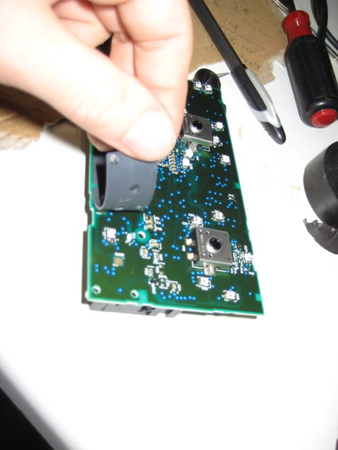

Step 4:
Use torx 10 screwdriver to unscrew the screws.
Step 5:
Pull the circuit board out of the front part of the AC controls.
Step6:
Take plastic piece at the bottom of the circuit board off.
Step 7:
De-solder LEDs one at a time and re-solder that one LED and go test after each LED. Repeat until finished. Use following diagrams for polarity and for which LEDs to redo. Use soldering technique from Driver’s side window switch portion of this tutorial. Also make sure to run a screwdriver through the center to make sure no solder is connecting the two poles.
Step 8:
Reassemble. Pat yourself on the back cause you have just finished the hard part unless you decide to do the more difficult cluster setup.

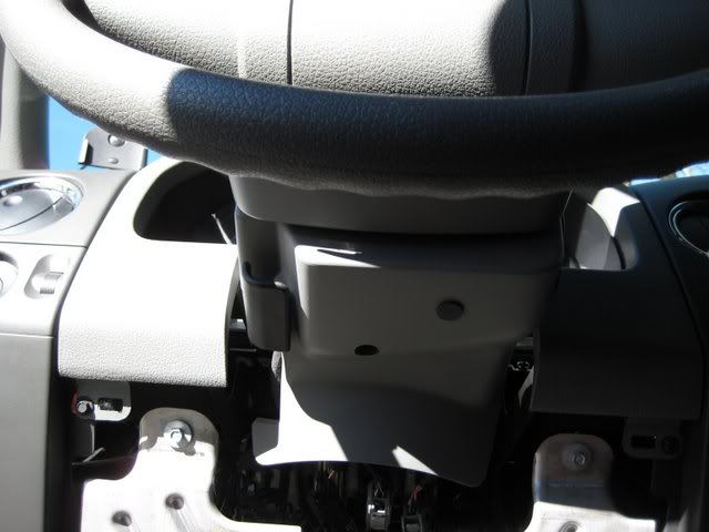

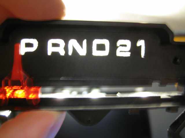

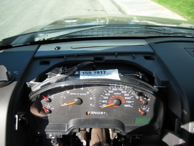

Instrument Cluster (easy way):
Step 1:
Remove the lower two screw on the bottom panel.
Step 2:
Remove the 2 screws on the upper panels that you just exposed. The little black ones.
Step 3:
Take your fingers and run them up the edge of the panel, to get the clips off.
Step 4:
Now you should be looking at the instrument cluster, remove the 4 screws.
Step 5:
Remove the two plugs.

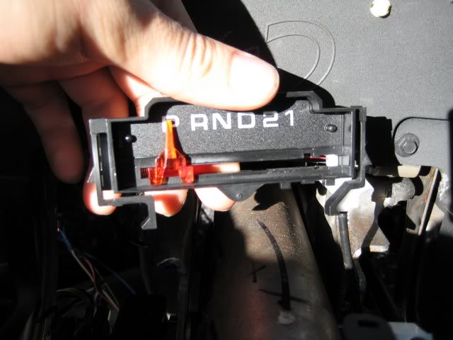

Step 6:
Remove the shifter by squeezing the two tabs.
Step 7:
Take the shifter out by removing the red cord.
Step 8:

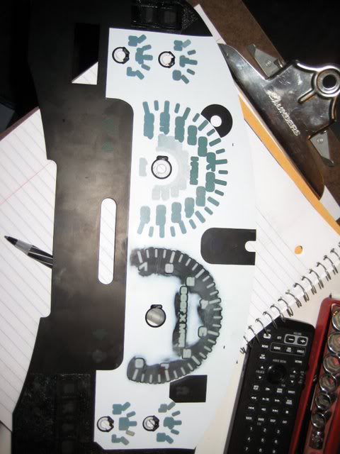

Remove the green from this with an X-Acto knife being careful not to remove anything besides the number or letter.
Step 9:
Take the clear plastic off the cluster.

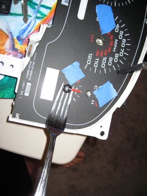

Step 10:
Remove the needles by using a fork and applying force, it takes quite a bit of force.
Step 11:
Peel off the gauge overlay.
Step 12:
Start sanding the green with 320 sandpaper. RPMs sanded the rest isn't.
Step 13:
You should be able to it up to the light and see no green through it.
Step 14:

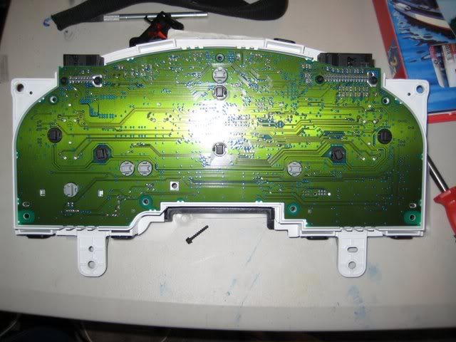

Now it is time to replace your lights, take a T15 Torx and unscrew the back screws on the cluster.
Step 15:
Take the clear diffuser off, the part you removed the black gauge from.
Step 16:
You should have exposed the circuit board now and you can you remove the LCD screen.
Step 17:
Take off LCD green backing.
Step 18:
Take out all of the old bulbs.
Step 19:
Put in LEDs and go test, flip the LEDs where necessary.
Step 20:
Reassemble

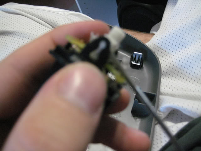

Step 6:
Unplug harness.
Step 7:
Have better luck then me at getting them apart.
Step 8:
Take circuit boards out.
Step 9:
Desolder LEDs
Step 10:
Solder LEDs in same direction, "cut" in same the place, as the old ones.
Step 11:
Test.
Step 12:
Reassemble control, if you broke it you can use a drop of super glue.
Step 1:
Step 2:
Step 3:
Step 4:
Step 1:
Step 2:
Step 3:
Step 4:
Step 5:
Step 6:
Step 7:
Step 8:
Step 9:
Step 10:
Step 11:
Step 12:
Step 13:
Step 14:
Step 1:
Step 2:
Step 3:
Step 4:
Step 5:
Step 6:
Step 7:
Step 8:
Step 1:
Step 2:
Step 3:
Step 4:
Step 5:
Step 6:
Step 7:
Step 8:
Reassemble Switch.
Step 1:
Airbag plug.
Step 2:
Step 3:
Step 4:
Step 5:
Step 6:
Step 7:
Headlamp switch:
Step 1:
Step 2:
Step 3:
Step 4:
Step 5:
Step 6:
Step 7:
Reassemble.

AC controls:
Step 1:
Step 2:
Step 3:
Step 4:
Step 5:
Step6:
Step 7:
Step 8:
Step 1:
Step 2:
Step 3:
Step 4:
Step 5:
Step 6:
Step 7:
Step 8:
Step 9:
Step 10:
Step 11:
Step 12:
Step 13:
Step 14:
Step 15:
Step 16:
Step 17:
Step 18:
Step 19:
Step 20:
Reassemble

Step 7:
Step 8:
Step 9:
Desolder LEDs
Step 10:
