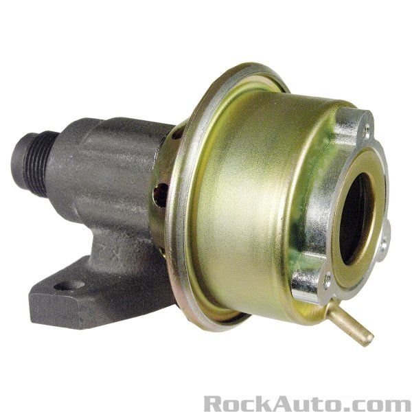

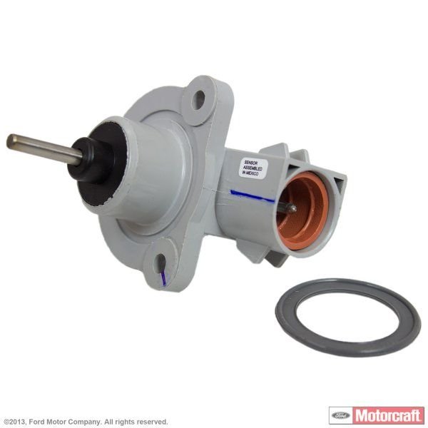

There should not be any vacuum on the EGR line at idle. If it's running rough, there is probably vacuum on it. Trace the line back and see what's passing vacuum when it shouldn't.
The parts catalog at Rock Auto shows a EGR valve position sensor and a EGR valve control solenoid/motor.
I have the EGR Valve and Sensor on mine. Will track the line but do not thing it goes into solenoid/motor.

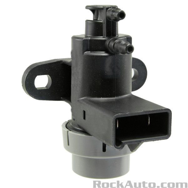

found the EGR valve control solenoid/motor...
