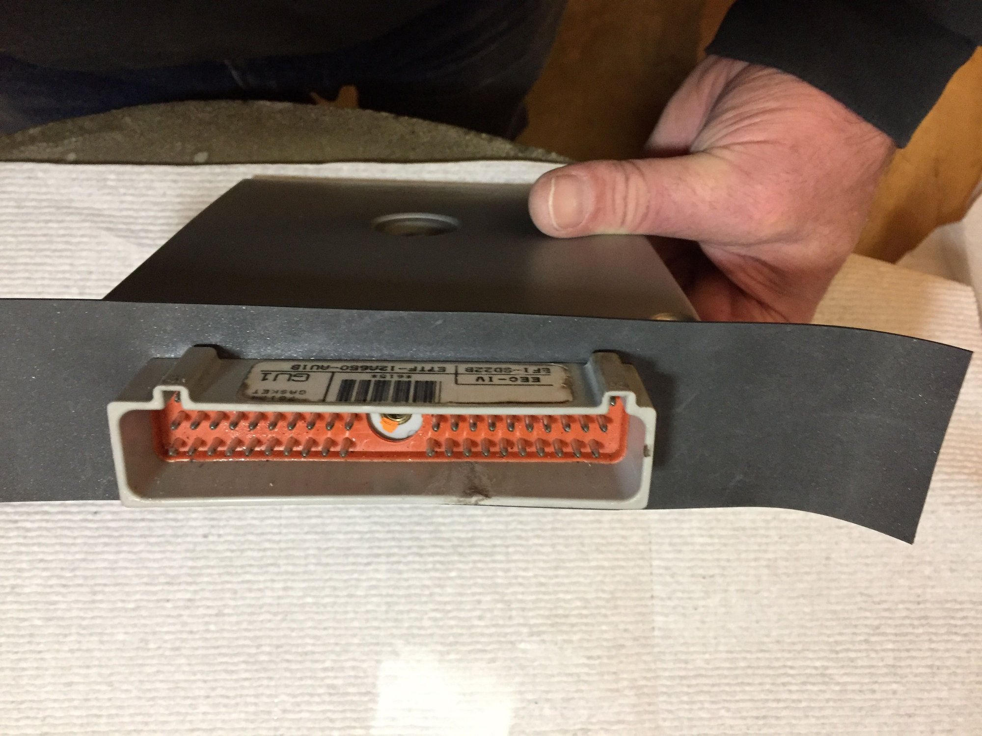

ECM came in. I was able to re-shape the rubber seal with the help of boiling water and used some JB Weld on the bracket. Will probable add some custom brackets when installing. I also had some rubber gasket/material and made an extra seal for the ECM...
