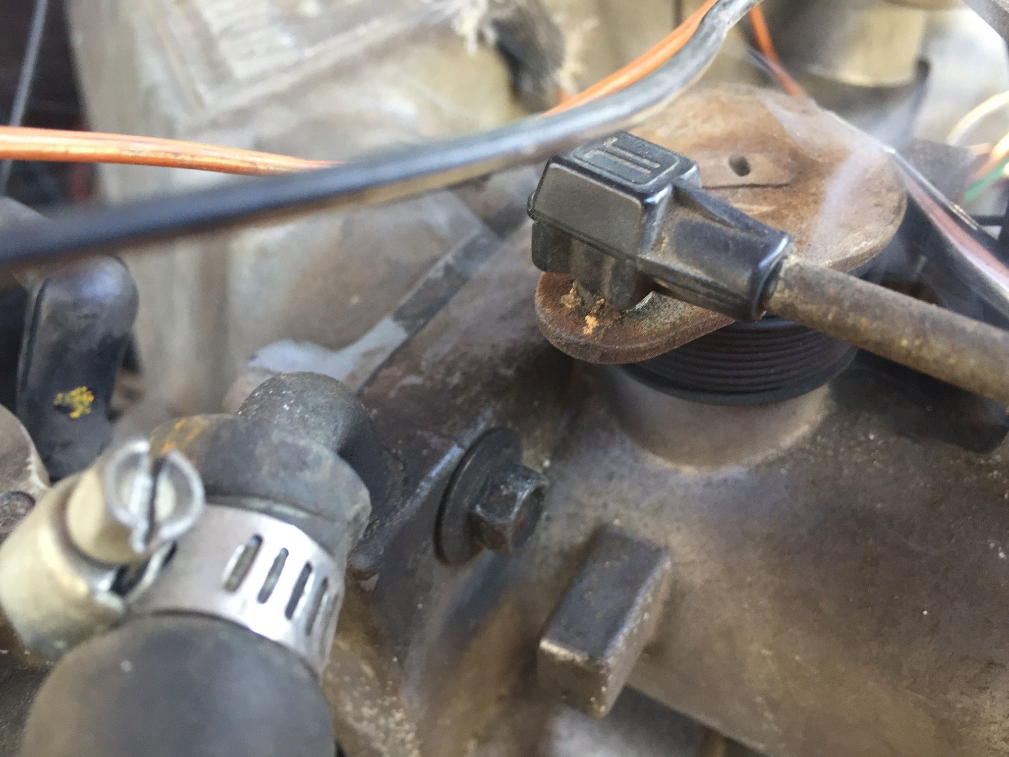

Did a smoke/vacuum test this Sunday. Did have a leak from the EGR, Throttle Position Sensor, and Connector on top of Throttle Body. I did do another test with the EGR blocked off and tried to start, no leak from the EGR and did not start. Here are the images from the test, without the EGR leaking image.
Top of Throttle Body
