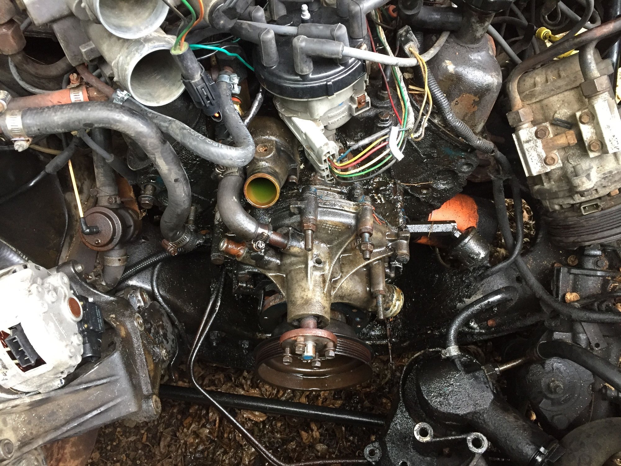

So I am in the process of getting the parts/tools to replace the timing chain and gear. Here is the engine before and during cleaning, still cleaning a few more areas. Also notice the smog pump had no pulley and would not turn, will see about deleting it. While I have it broken down, will see about replacing other parts, like the water pump. Just in case....
The fan was marked with what looks to me "1986 Mustang". Not sure if that what the engine was, or just the fan.... Nothing like finding new things as you fix other things....
almost clean
not clean
