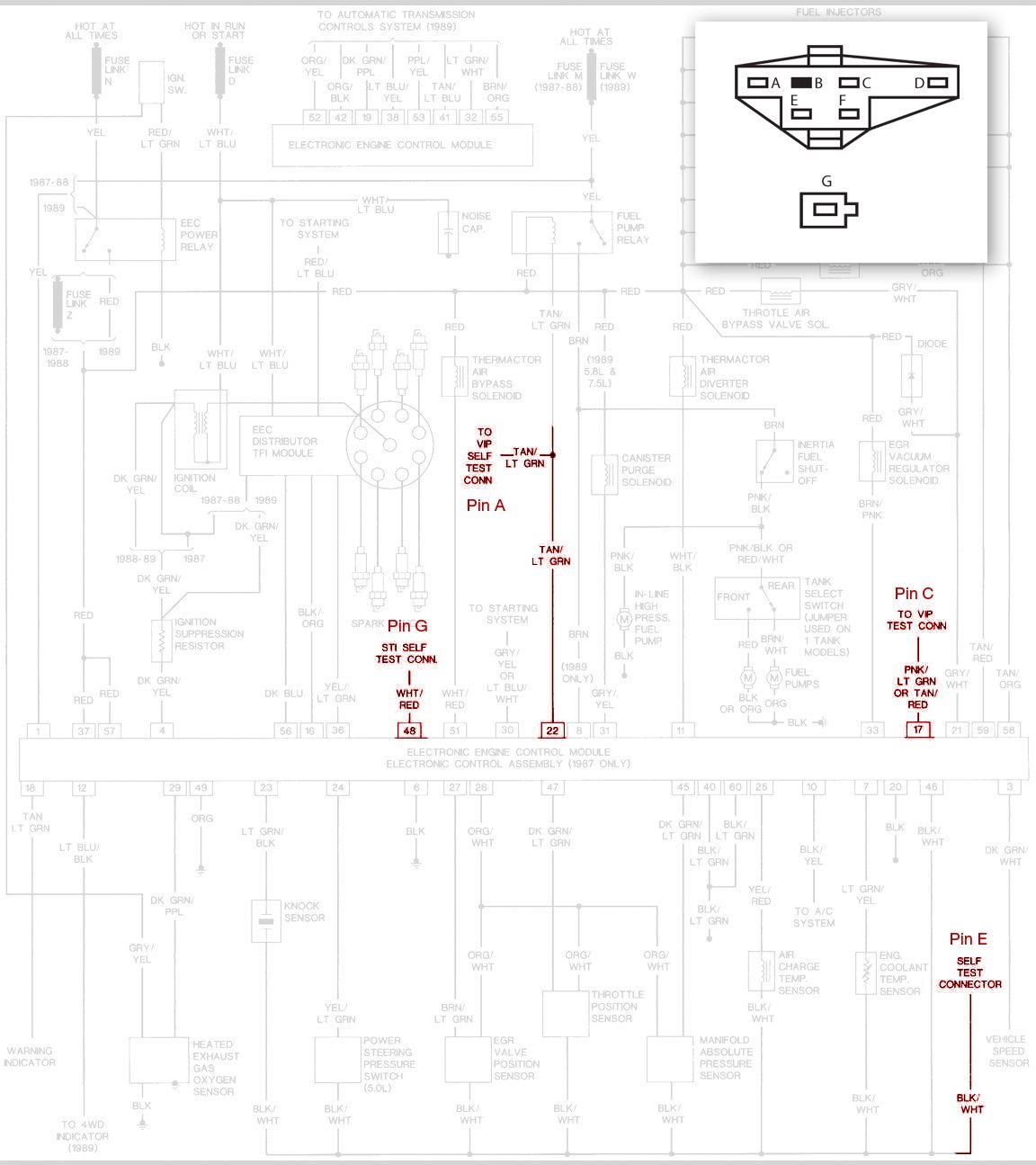

Wiring diagram I am using....
Originally Posted by Roadie
Is there a check engine light? An egr problem should throw a code.
No check engine light. No OBD1 connector, cut off by a previous owner. Guessing it was cut off when the engine was replaced.
I just got a OBD1 reader and Plug harness to see about re-wiring it back in. I found the wires and tried to wire them together for Code test, not luck. No check engine light came on. Tried with a meter and test light, Test light stayed on. Will be seeing if they cut the test engine light also....
Found OBD1 Wires....
wiring diagram I am using...
