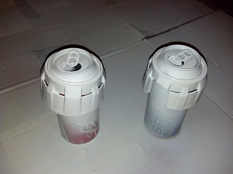

Decided to get artsy today and did this [IMG]
[/IMG]

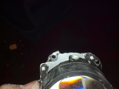

Your gunna need to trim the inside edge of your projector. Its just the shield on the outside so it doesn't effect performance at all. It should look like this:

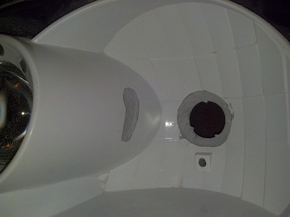

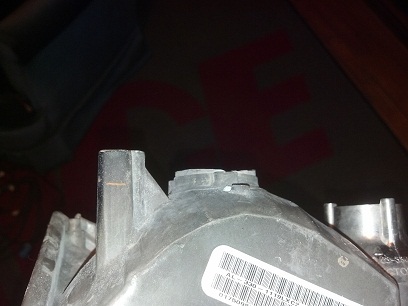

now that you can fit the projector in there better move it against the tunnel of the high beam projector so you can see where to grind down next on the housing. You will need to cut/sand on the housing in three different spots. the first is the tunnel to help make room so your projector is flush. (don't sand to much or you will break through the reflector like i did on my first one. simple fix just need silicone.) the second is in the middle of the reflector where your 9007 bulb is. you need to make it deeper so the threads of the projector will come out enough to get the lock nut and bulb holder on. Last is the back of the housing where the plastic locking nut was that held the 9007 bulb into place. you have to cut it down about a half inch. Just enough so the H1 bulb holder fits on top of the threads. Those cuts look like this:

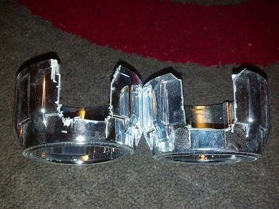

Now last you need to cut your shroud so it fits snug next to the high beam tunnel. This is pretty simple.

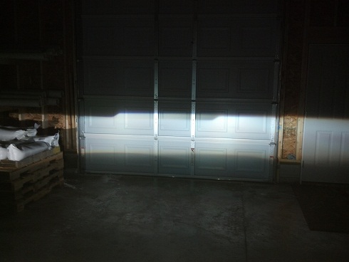

Step six: Now that you have everything together you need to put your headlight back into your truck and align for rotation so the left side of the step down is flat. This took me a few times and i need to take my headlight apart again to cut the shroud once more but finally got it as close as i think it needs to be. Once your rotation is perfect you can tighten the nut more firmly onto projector.

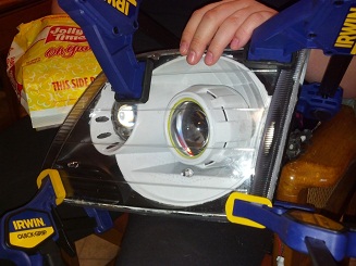

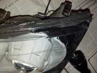

Step seven: Here is where i ran into problems. The projector sticks out about a 1/8 or 1/4 inch to much so you need to try to mold your shield around it. What i tried to do and failed at was get the lens hot at 265 for 10 minutes then use c clamps to hold it onto headlight. This worked alright but not perfect so i ended up using RTV sealant where there were gaps.
<- use that pic for molding and putting headlight lens back on..
<- RTV sealant
Step eight: Put your headlights back into the oven with your new butyl glue and lens on for 265 for 7 minutes. Then your going to need to have them held with c clamps again for atleast a half hour some where cold to make sure the glue sets.

My only two comments are to get the mini D2s projectors bc they are a half inch shorter so they will fit into your headlight without any molding of the lens and also i don't believe the high beams are very good on the Mini H1 but i will see once i align mine down some more. Also haven't gotten the splitter for the secondary high beams yet TRS messed up and they are sending me replacements once. Good luck with this Mod and if you have any questions don't hesitate to ask.

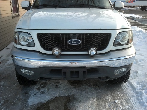

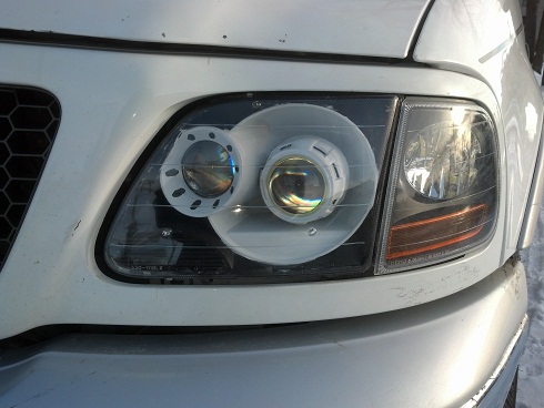

Bump.. ALL DONE!!!! Here are some finished pics
I believe the driverside bulb needs to be seated better what do you think?
