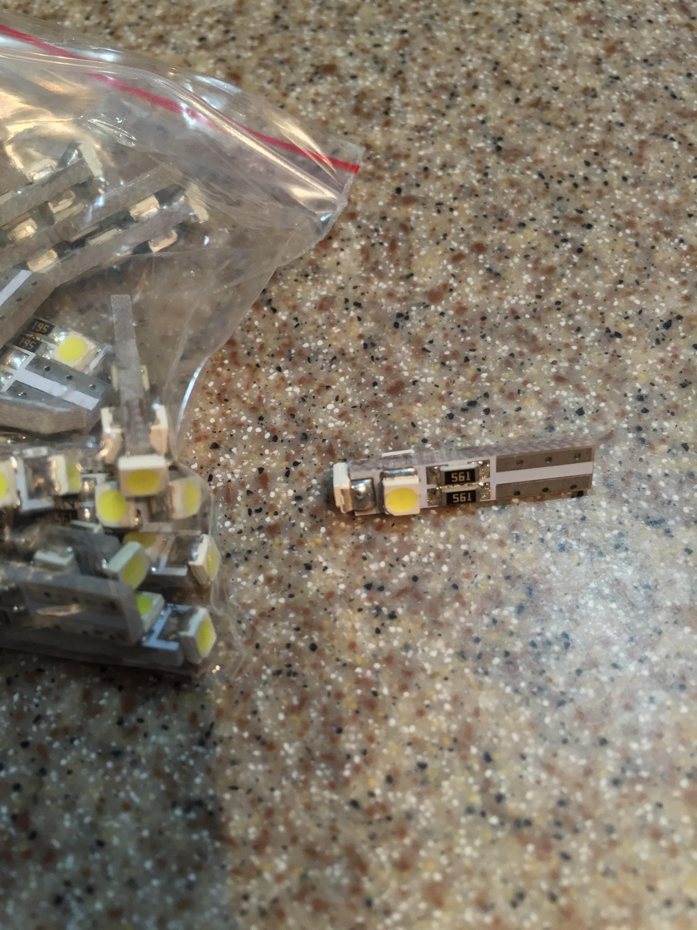

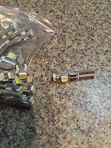

Old Apr 5, 2015 | 07:35 PM
  #134
2008_XL's Avatar
Joined: Oct 2008
Posts: 3,121
From: Burlington, VT
Before I take apart my dash, can anyone confirm I have the correct bulbs for the cluster and odomiter?
