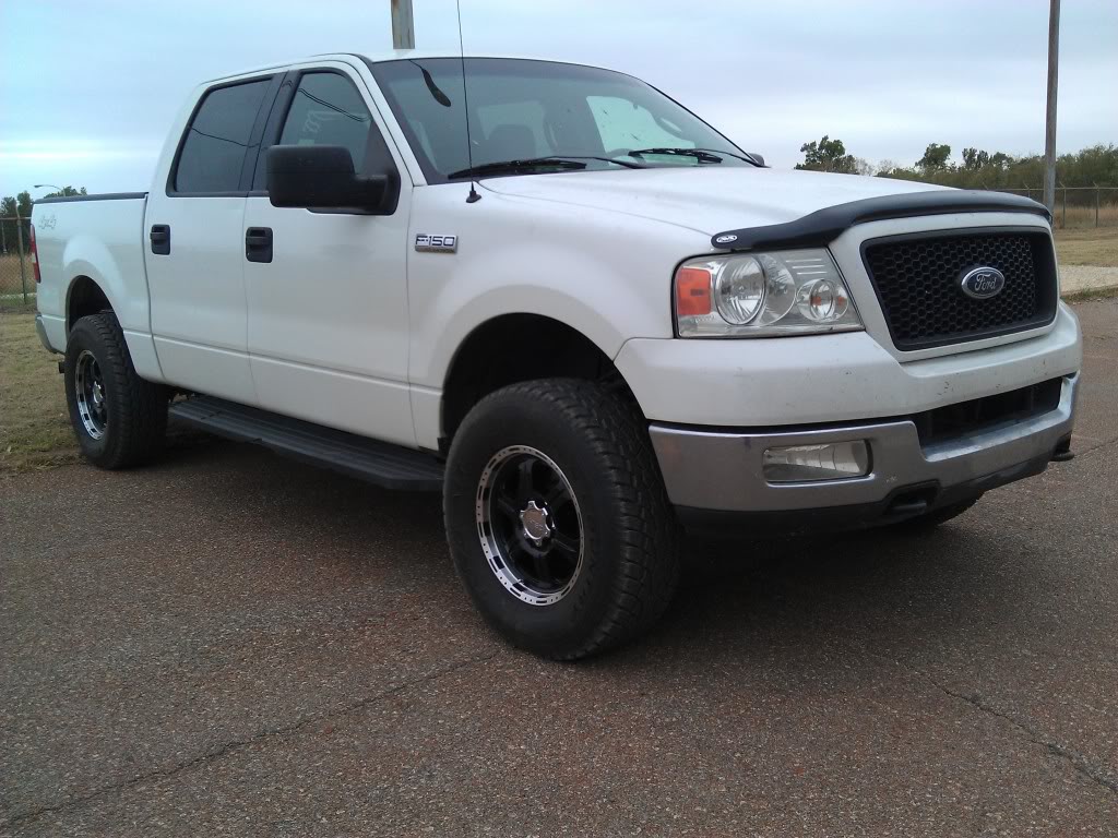

2004
2004 lariat screw with 188,000 miles.2 inch level with 32"x11" tires. repainted old plastic parts with a new black paint for plastic.
have had to replace the cam phaser actuator on driver side twice due to a sludging problem. we think the previous owner used crappy oil or did not change oil regularly. however this was almost a year apart. I just think more gunk moved down the line and plugged the actuator.
also had a blinker problem that turned out to be a lot of dirt in 1 of the plugs under the bed. The tail lights would sometimes go out and both blinkers would sometimes blink rapidly like a blown bulb. however it just turned out to be the plug not having a good connection.
I bought the truck 2 years ago and it has been very reliable overall. As long as this sludging problem stays minimal, the truck should do well for a long time to come.
